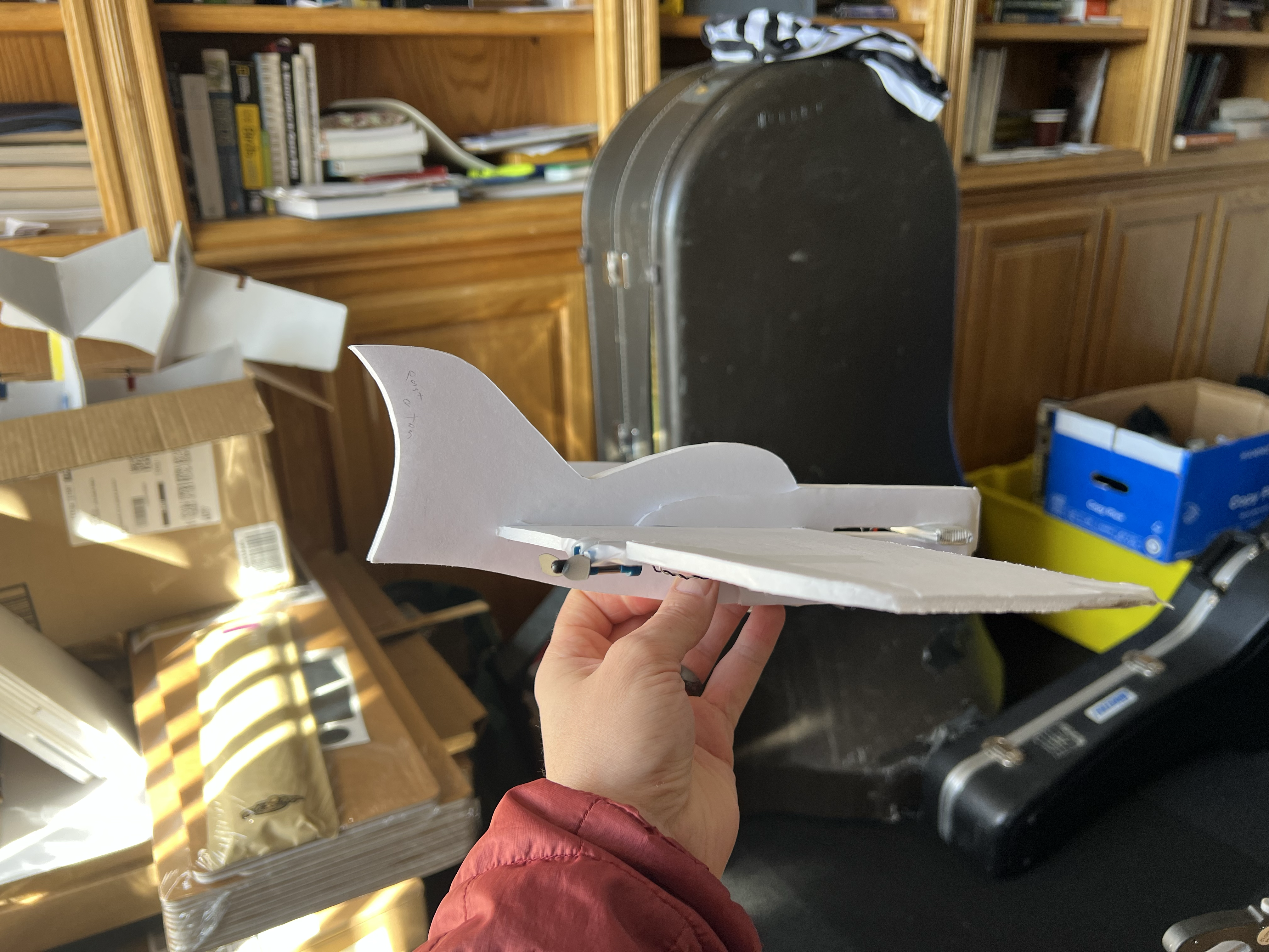

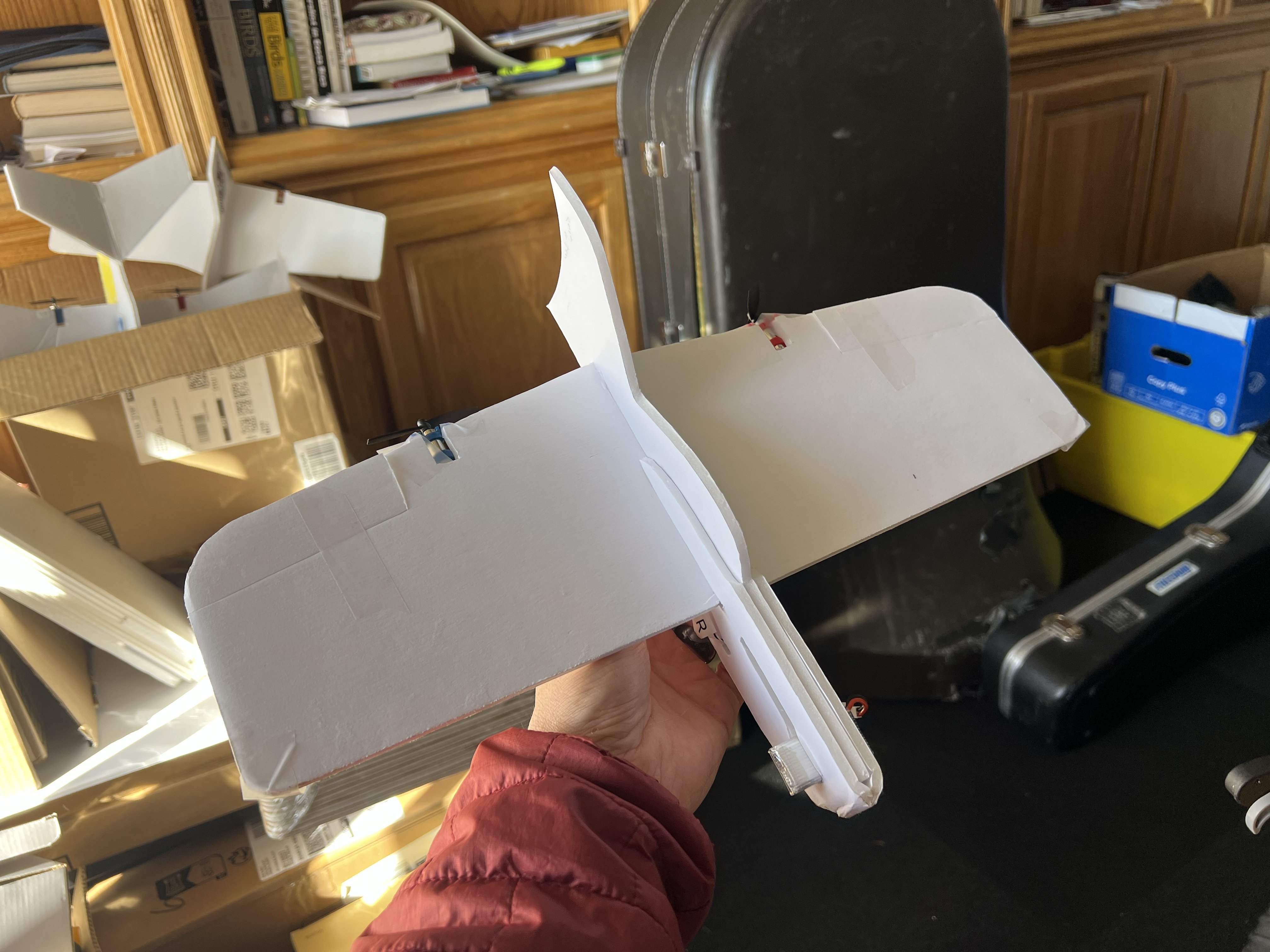

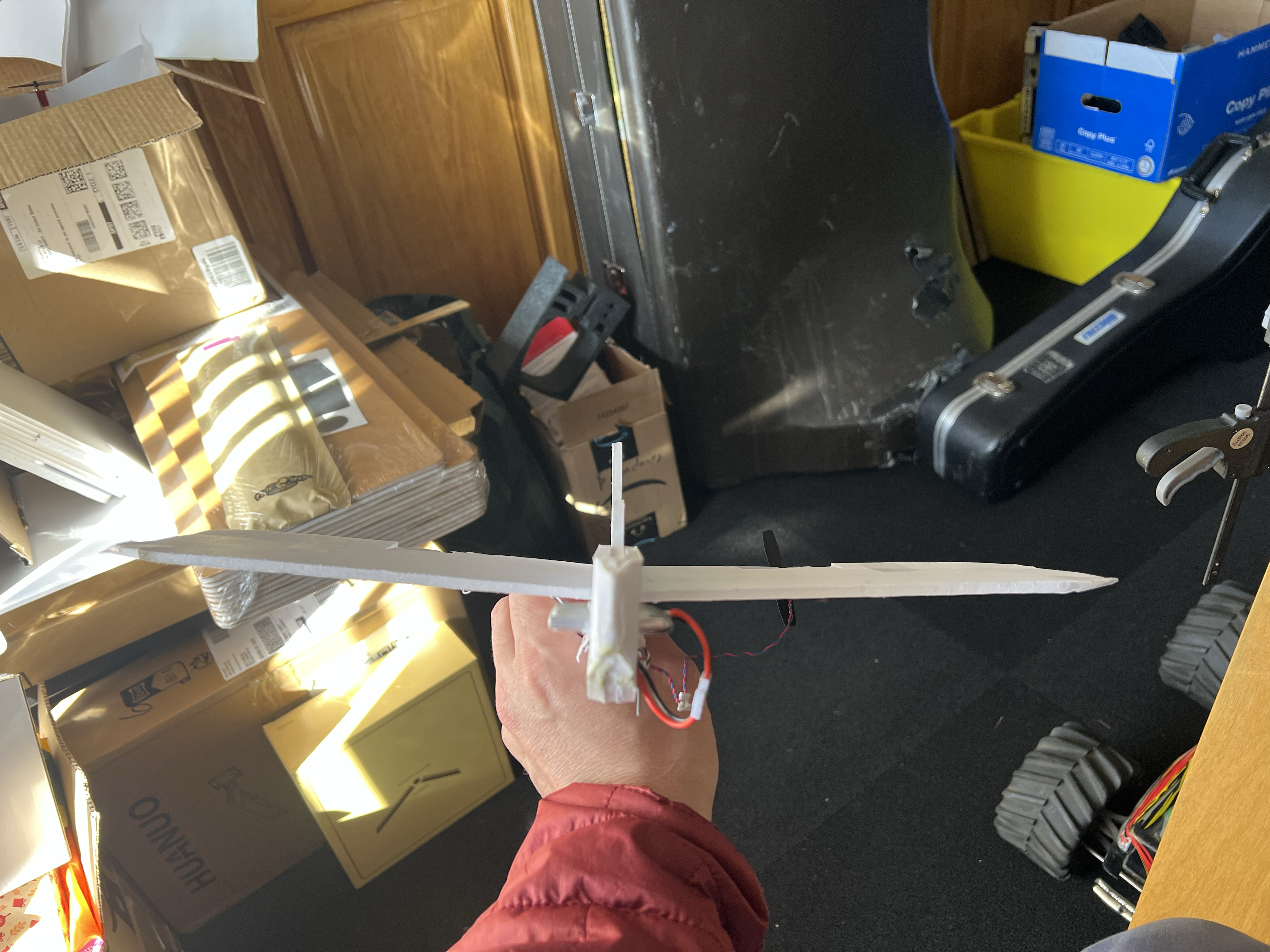

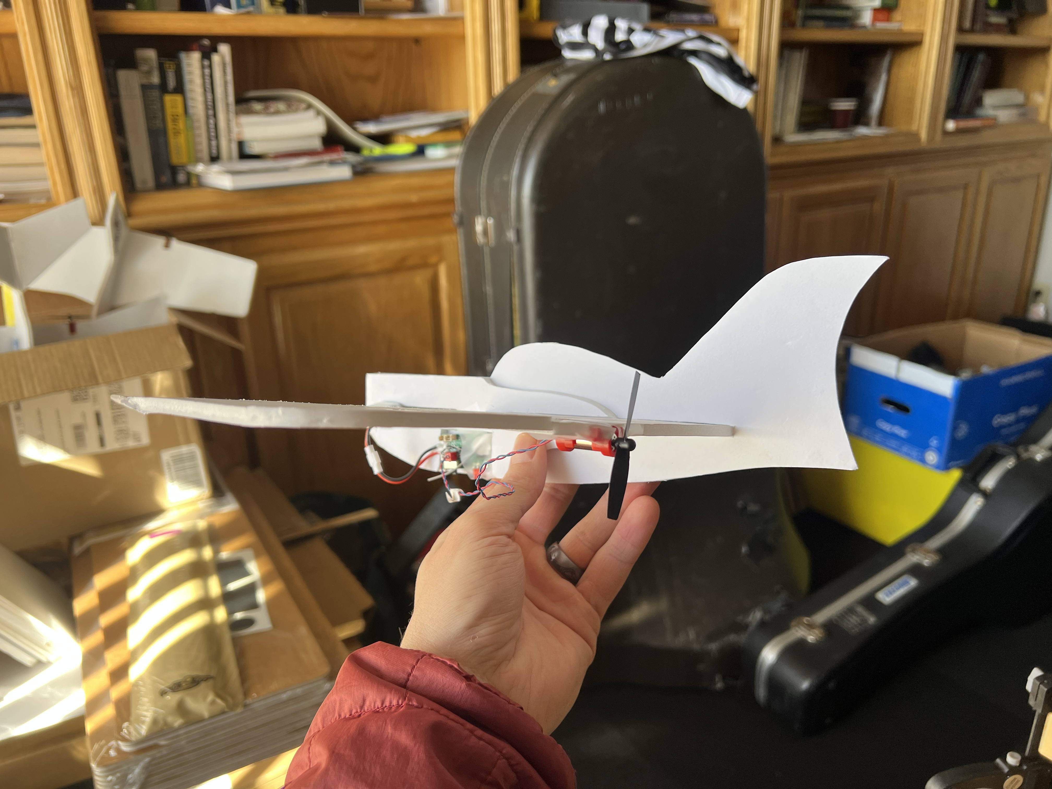

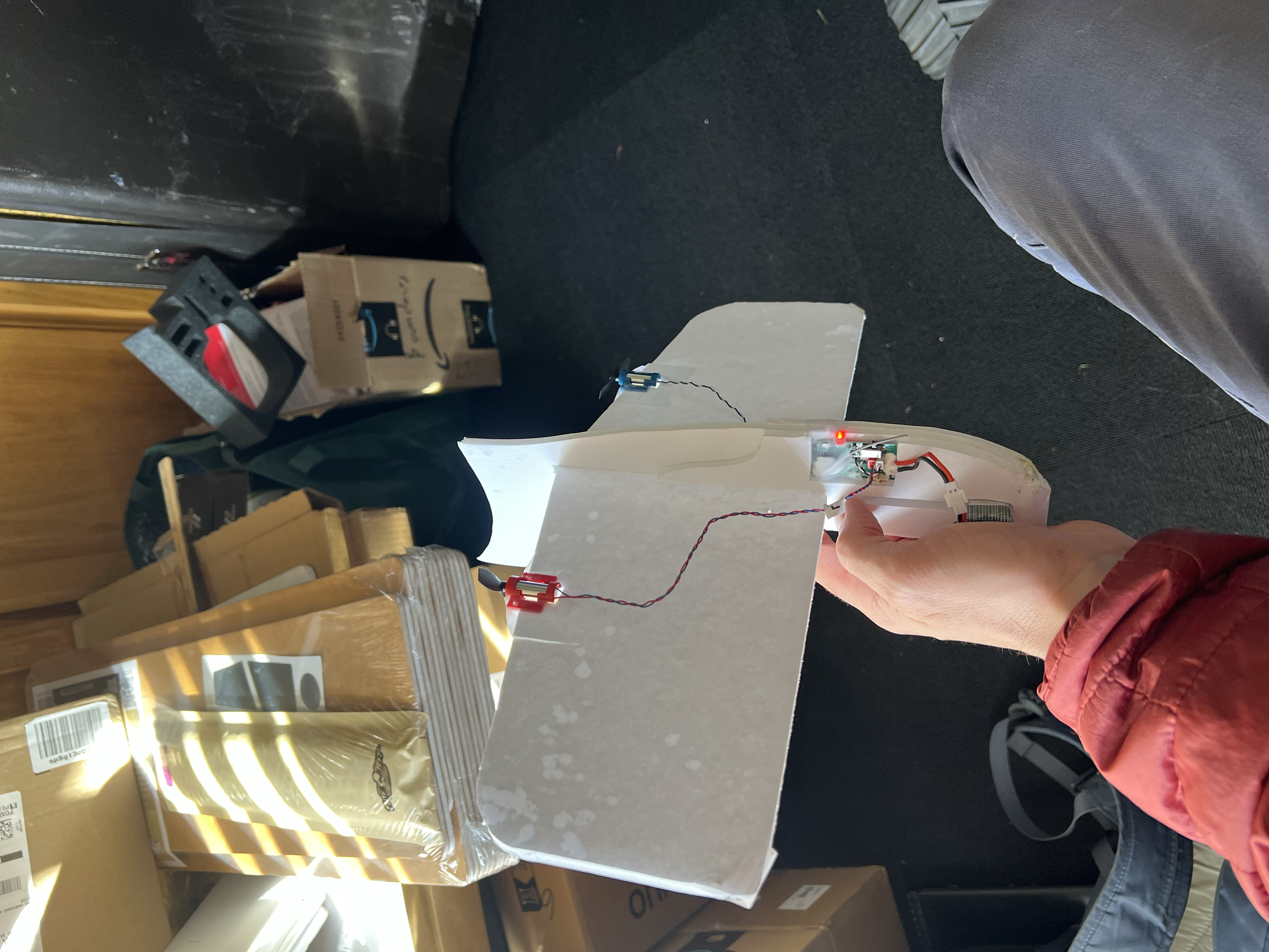

Hi, I have been working with my local school building the EZ first flyers plank with the 5th graders. Yesterday we finished the planes and went to fly them, and we had some issues. I have run summer kids programs with the EZ flyers before and not had these issues. All but one of our planes did a hard nose dive. As soon as they left the throwers hand, they would dive straight into the ground. Why would it do that? I haven't had this issue before. I checked and double checked the planes. All of the electronics are set up correctly. I adjusted the flaps higher and it helped some, but I have them where it is recommended, and I have not needed to put them higher than this before. If it was just one plane, I would be more inclined to think that this plane is an anomaly, and crank them way up. However, since they were all doing it, I thought I might be missing something else.
I will attache pictures of the plane that I built.
Any help will be much appreciated.

The #1 problem I've noticed when people fly EZ planes is they lower the throttle to zero while flying. As soon as they do that the plane has no controls.
The THROTTLE MUST ALWAYS BE ACTIVE for the gyro, stabilizer and controls to function. A minimum of ~5% to 10% is needed for it to be controllable.
EDIT: I should add that about 90% of the pilots did not know how the EZ boards worked or that a little throttle was needed for control.
