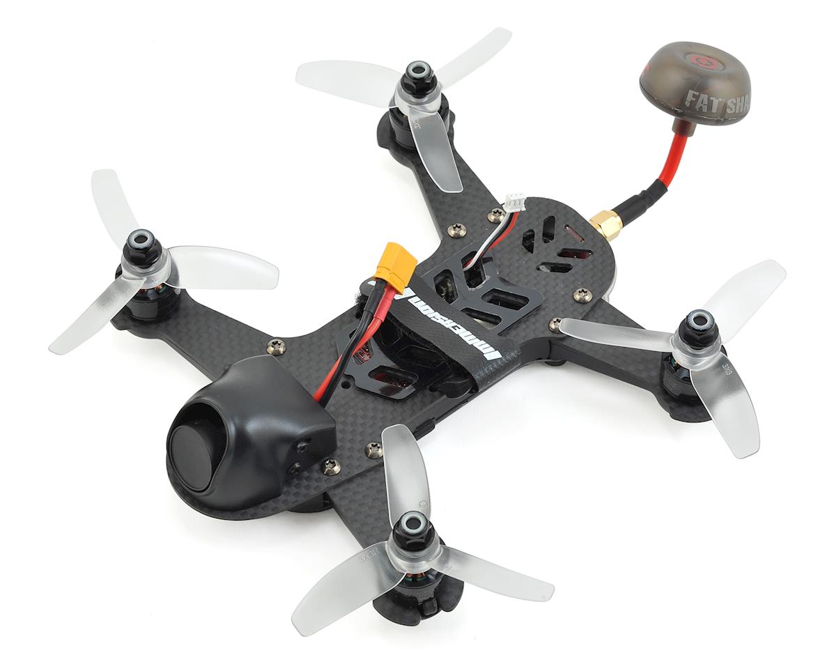

Maaaaaaaaybe, I found a used one. But I still want to do it the diy route.
Oh okay, I was going to say that you can get one just as nice if not better for less at speedyfpv. like this one my brother has been looking at.....
