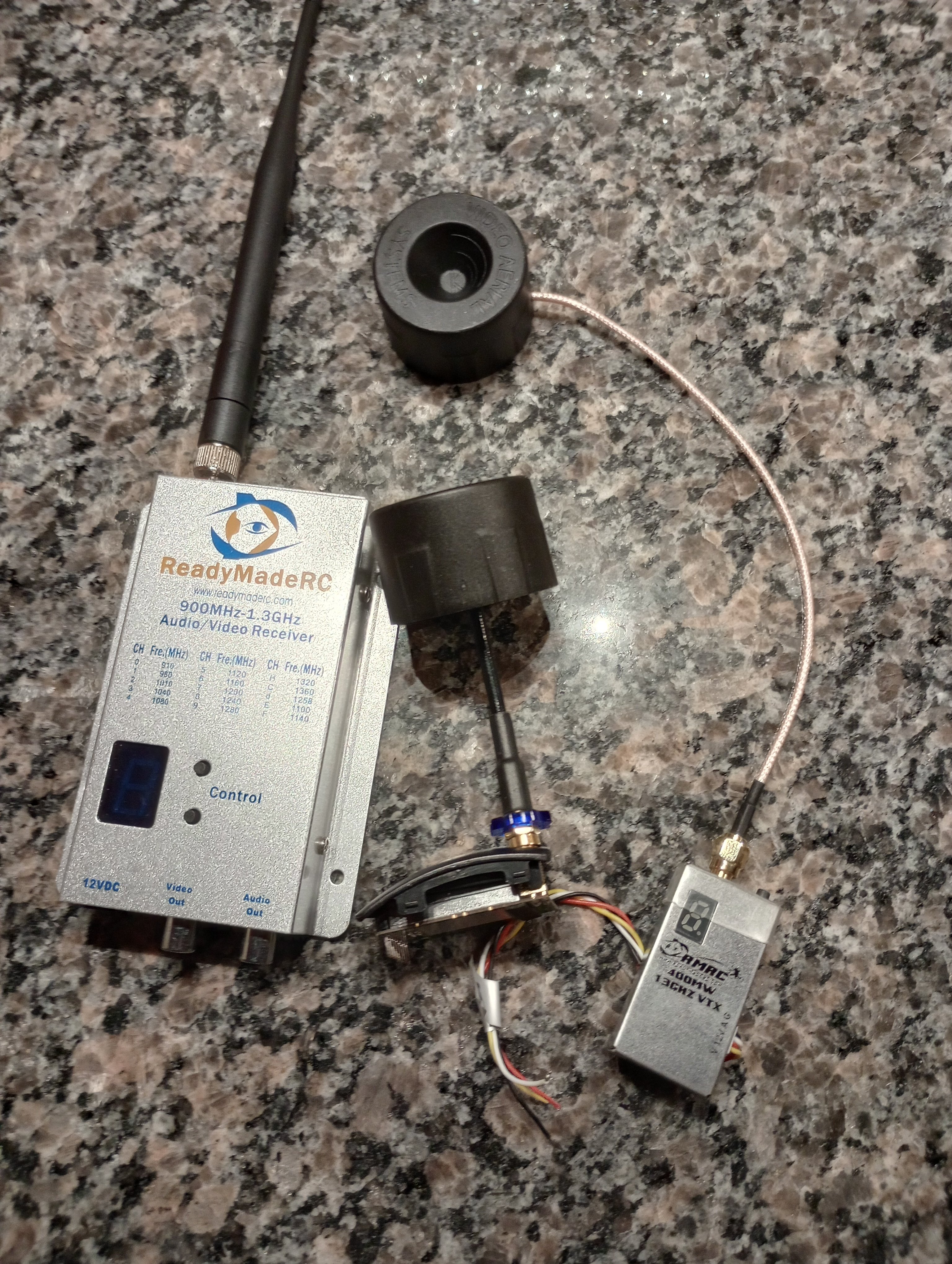

I have 1.3ghz gear. Here are 2 different receiver modules and a VTX like the ones you pictured. Lower frequencies use larger antennas.
1.3Ghz is less common except in the long range circles. If you are in the US, there are only two frequencies that these transmitters can legaly operate on. You can interfere with navigation if you operate in that band on the other frequencies.
5.8 Ghz is the band most people use, and with the modern digital protocols, are getting similar range results with better image quality (ie HD)
