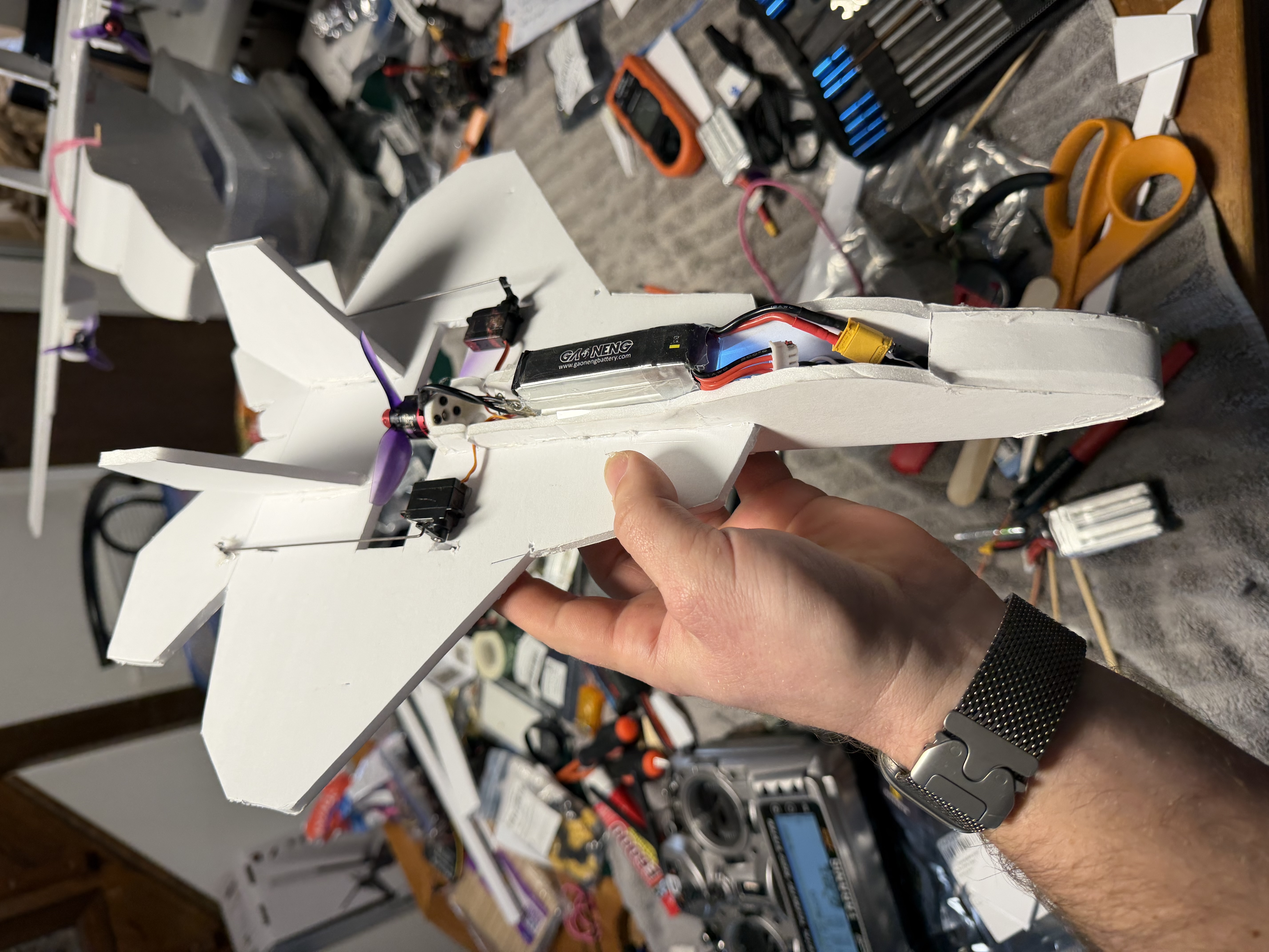

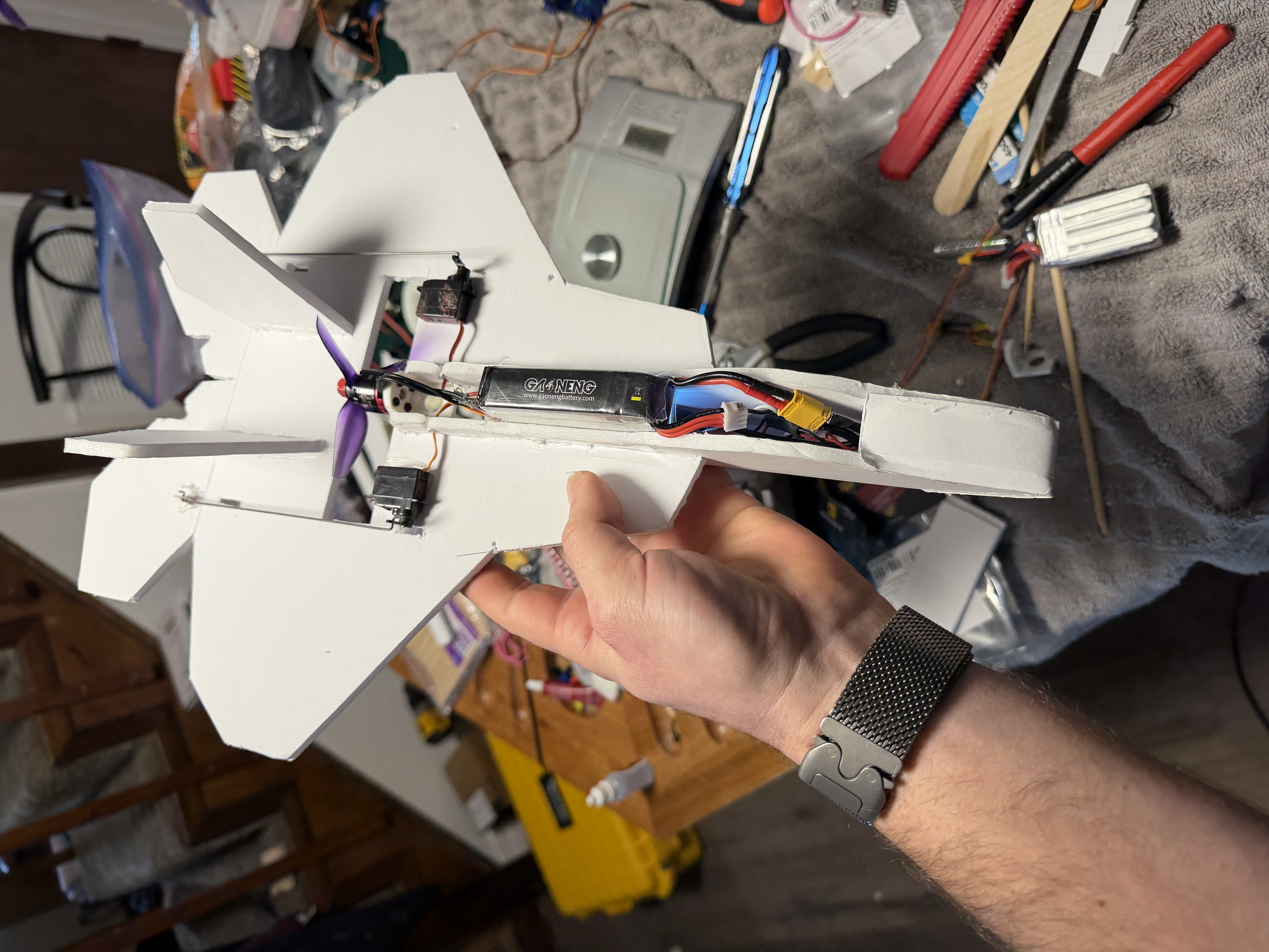

This is a build thread under construction for my micro FT22 (more details coming soon).
Test flight on GNB 3s 850mah went good today. It should also fly great on two tinywhoop batteries (2x betafpv 1S 450mah, wired in series)
The jet is hard to see and super fast!
Motor: emax rs1306 4000kv
Prop: 3x5x3
Esc: 30amp
Servos: 4g micro servos
