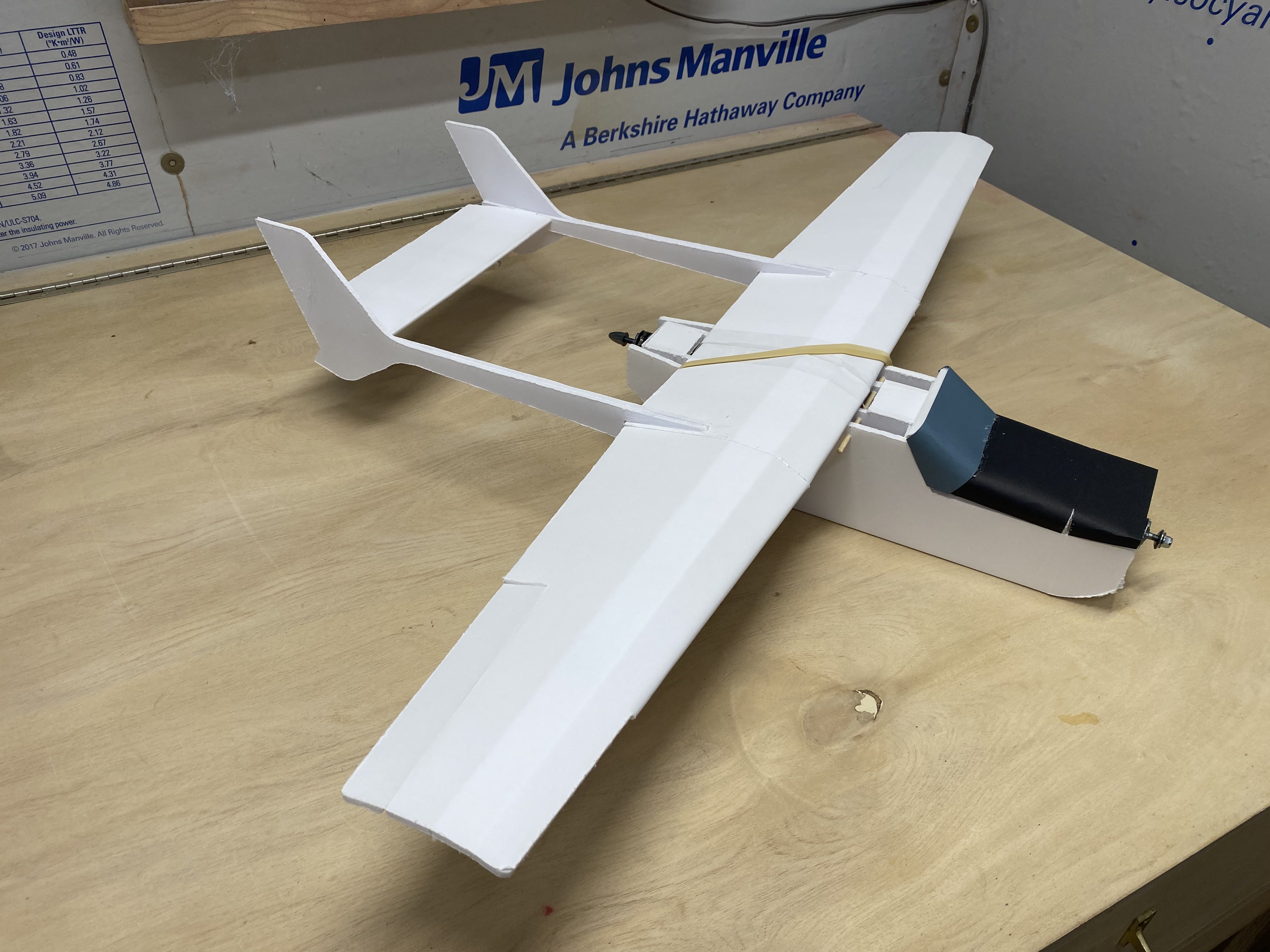

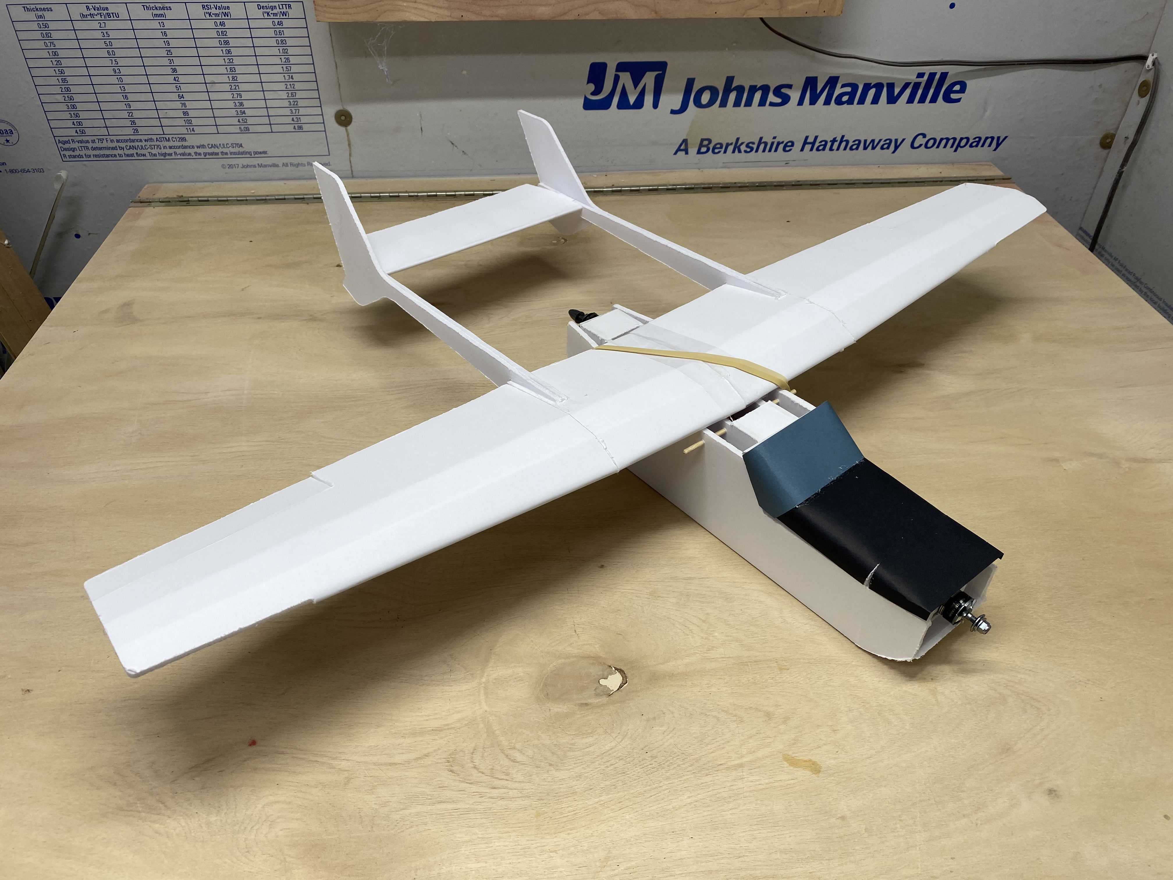

I wanted (needed) a break from complex ms style builds but I wanted another Skymaster. It only has one piece of peeled paper, everything else is a crease or A/B fold. Powered by 2 "A" pack (1806) motors, 6" two blade or 5" three blade props, either an 850 3s or 1300 3s battery, 36" wing and 2 1/2 or 3 sheets of dtfb and should build in an afternoon once the parts are cut. Plans soon as soon as it maidens.

When are the plans coming? I was originally planning on building the larger 60" one, but I don't really have the budget for a twin C pack right now and don't have too much time. This looks awesome!
