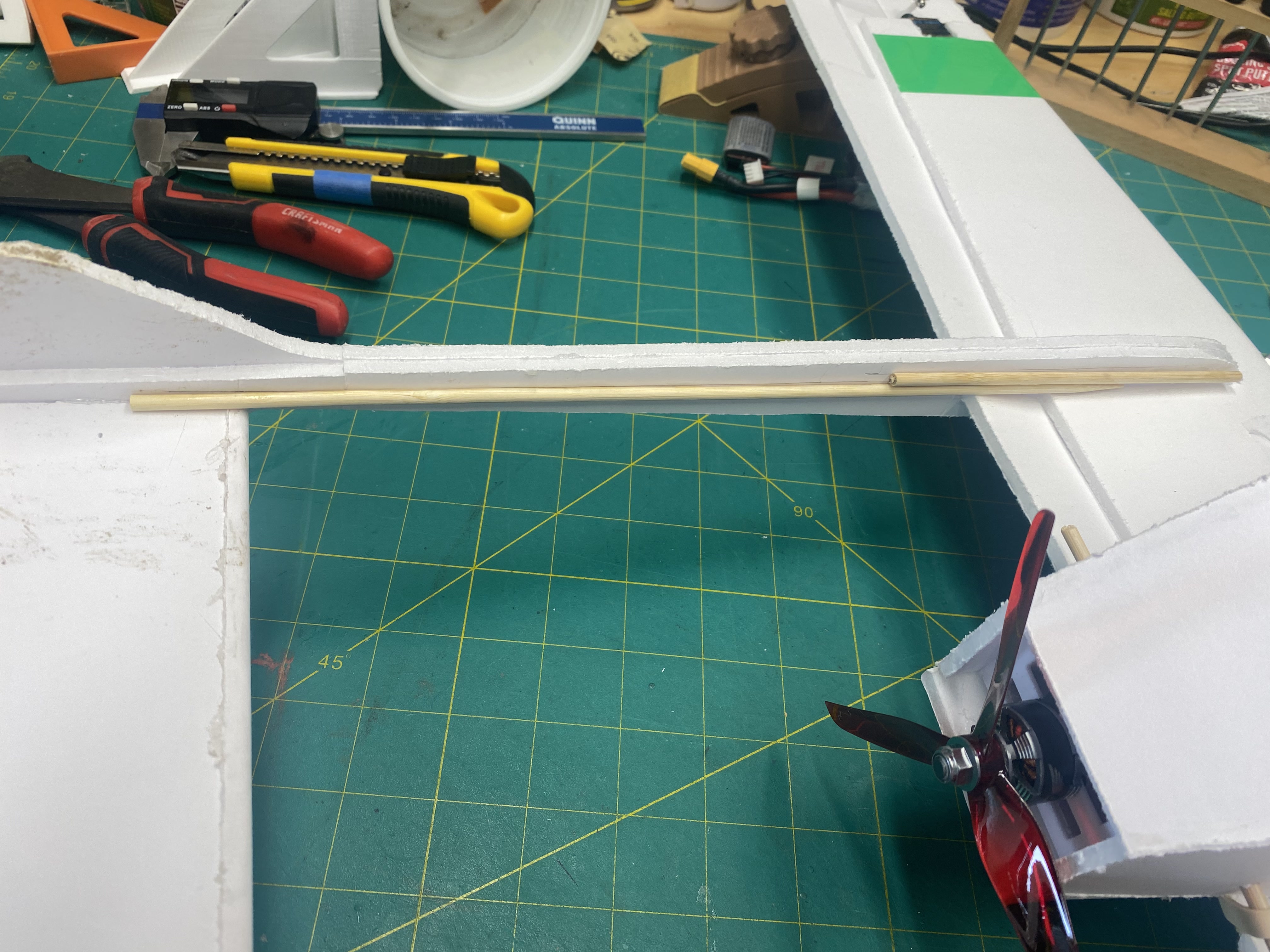

Airworthiness Directive: The booms are beginning to weaken just behind the wing and just before the horizontal stabilizer (yeah, I saw that coming but.....). Reinforce with a bbq skewer or cf rod.

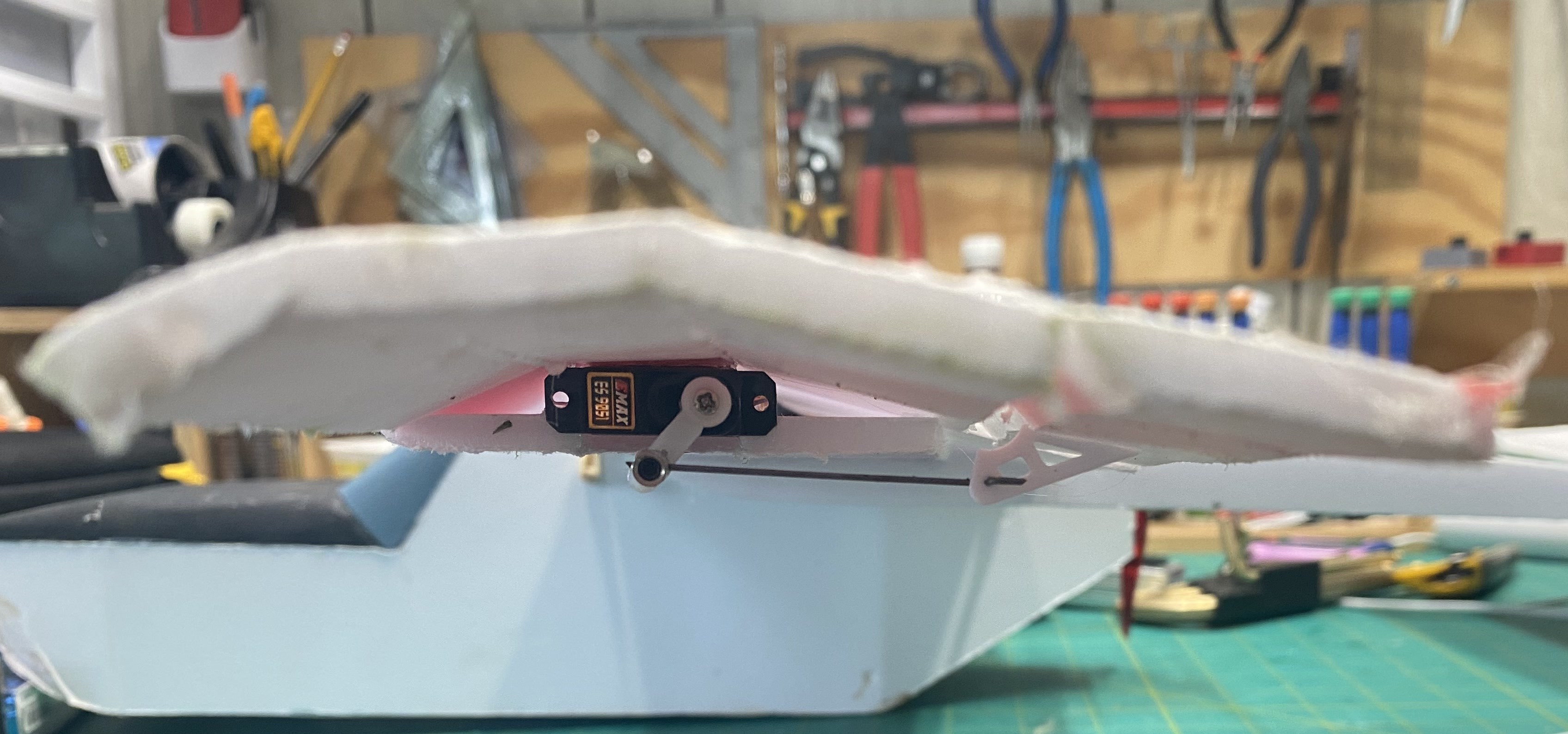

Airworthiness Directive #2: Now that the booms aren't flopping around I found the worst adverse yaw I've seen since the big DR1 I built. The fix is to cant the aileron servo horns forward so that you get more up deflection than down. I guess it's that or put on rudders.

So.... Even with skewers the booms didn't last long. I've made the booms a little taller for strength and increased the V stab size to help with the adverse yaw. Also put 5mm cf tube in the booms - it adds about 20g to the overall weight but the moment arm is easily compensated for by moving the battery forward. I'll let you know how it works :p
