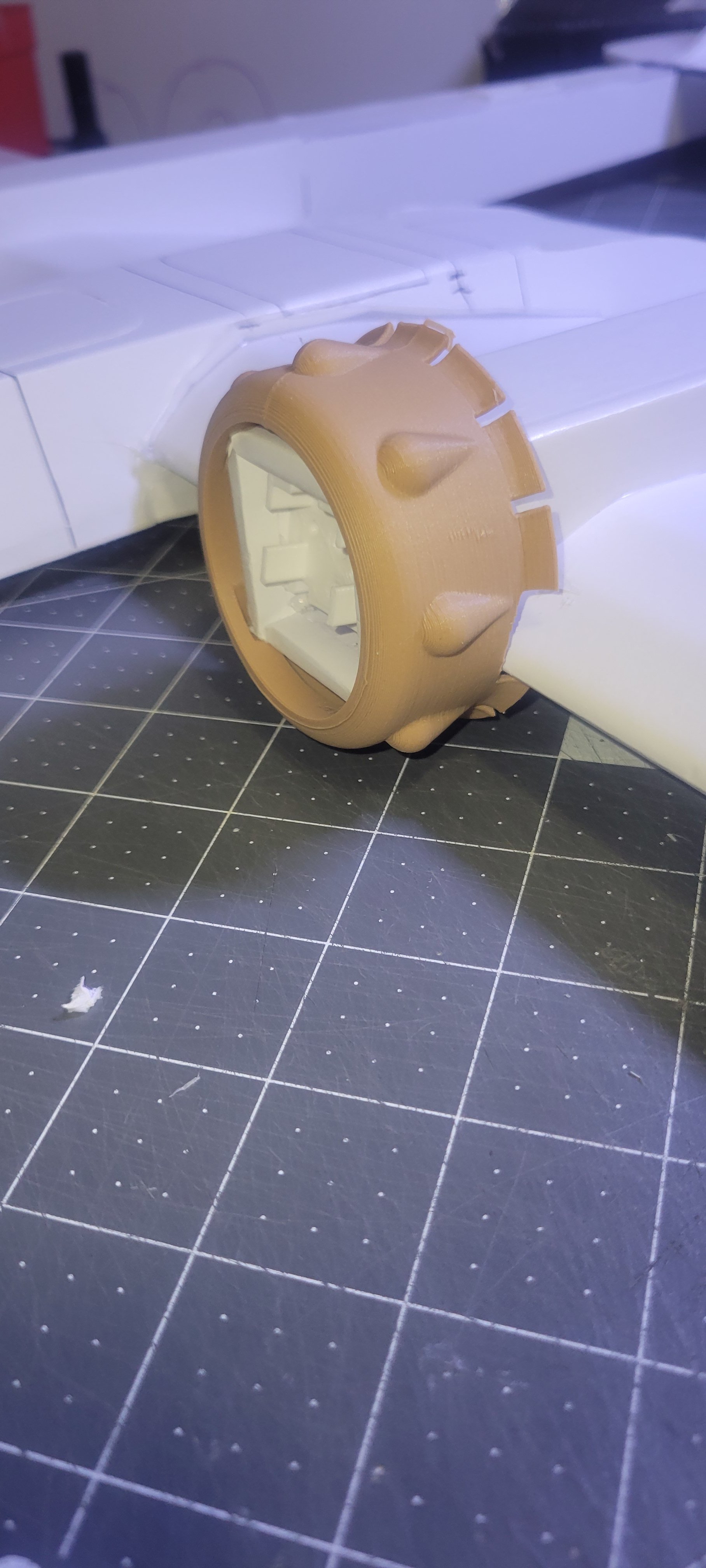

I prefer to print with the "face" of the firewall on the bed, I have tried verticaly but it is much weaker.
