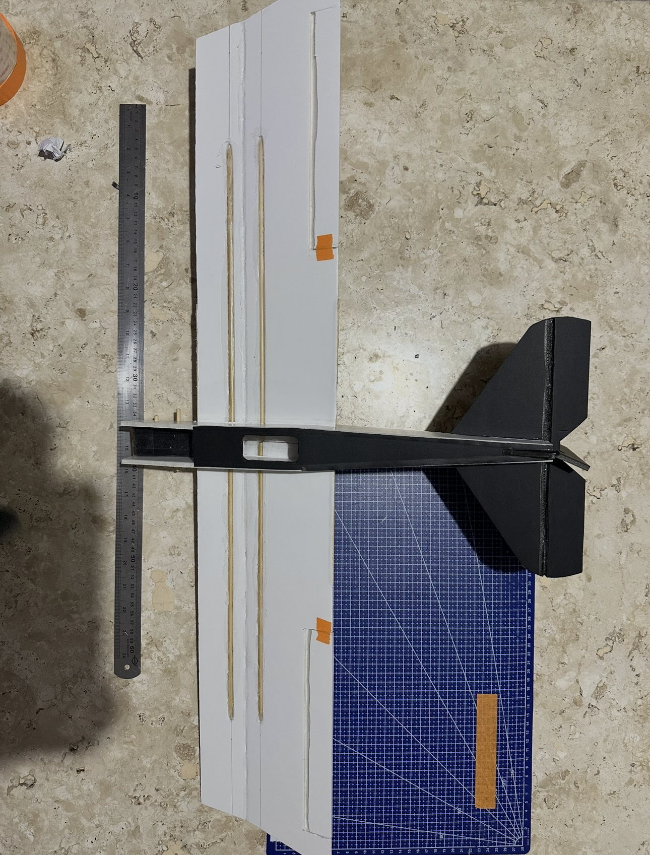

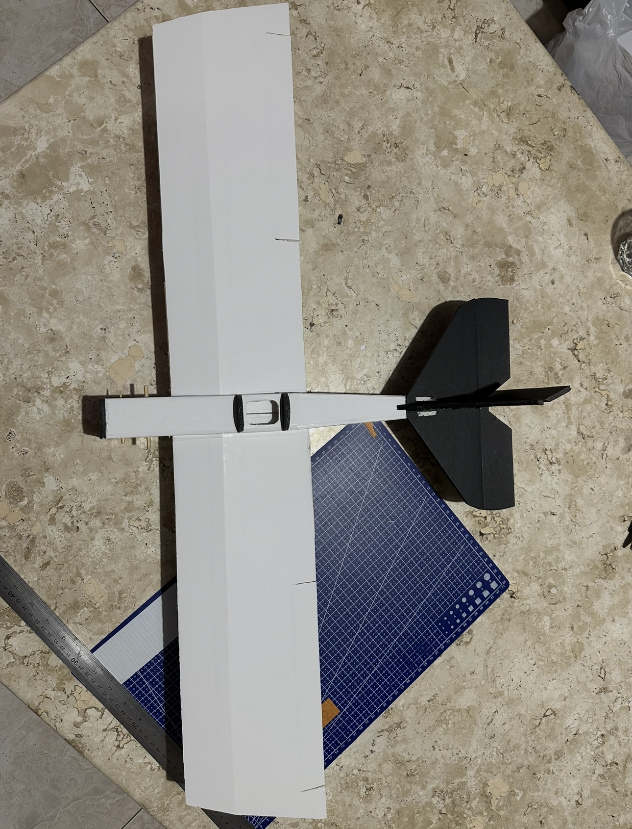

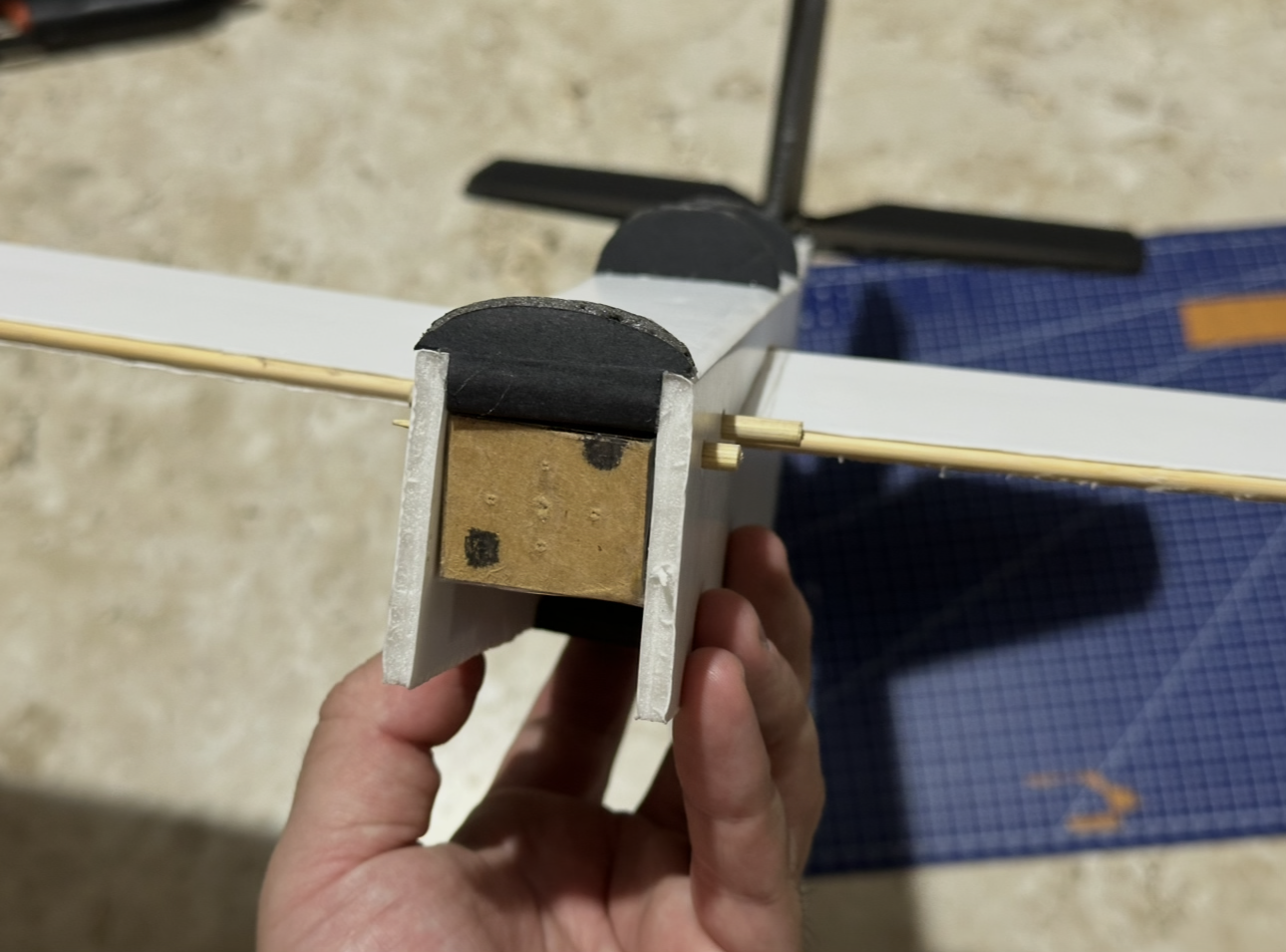

Update: I’ve assembled most of the fuselage. The 900 mm wing, even with two bamboo skewers, was still way too flexible and twisting a lot, so I decided to add two more skewers—one along the leading edge and another along the trailing edge—tying both wing halves together at the root. That made a huge difference in rigidity.
I embedded the skewers into the leading and trailing edges using something I stumbled upon by accident (though it’s probably a well-known trick here): I used the tip of a hot glue gun to melt the foamboard between the paper layers and open a channel for the skewer, then fixed it in place with hot glue. It worked surprisingly well.
And yeah, I didn’t do the scalloped details on the trailing edges because I wanted to keep this prototype more experimental and fast, but after seeing how stiff the wing is now, I think it’ll work out fine.
In hindsight, it might have been better to build a folded wing like the larger version. I compared it to the wing on my EZ Glider, and even without spars the Glider’s wing feels very rigid.
After New Year’s I’ll install the electronics and weigh everything to get a better idea of where things are going w/ the project.

Might want a spot of wider tape covering your spar skewers just to keep them in place. Yes I know they are glued in, but I might demonstrate delamination of the foam during flight leading to torn out pieces AND upward folded wings but perfectly attached fuse to wing joints.
