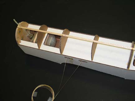

Yes you can use cardboard to make a plane but as a material cardboard is heavier than foam so it does need some careful design to arrive at a similar strength to weight ratio.
Making an entire plane just out of cardboard will not make the best use of the material. Better to use the material best suited to the load it has to carry or in other words exactly the sort of techniques used in full size!
A 40" wing made from cereal box cardboard on my "test" fuselage
It uses 5mm thick foam (underfloor insulation) wing ribs to support the skin.
A little heavier than the all foam original but aerodynamically just as efficient and about as strong.
