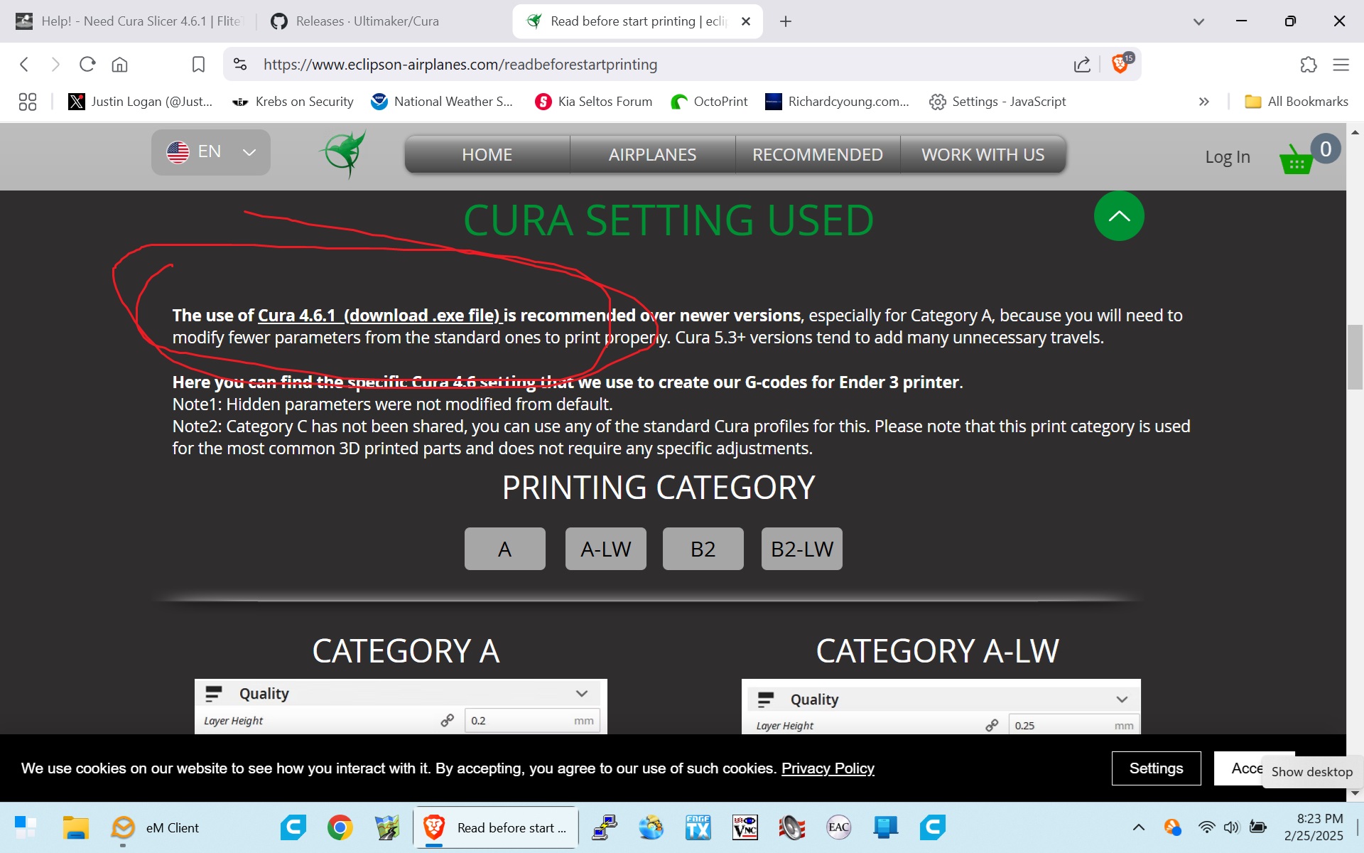

Can't find Cura slicer 4.6.1 for printing LW-PLA. I am trying to print Eclipsons Gö 1 Wolf, Just wondering if anyone has any tips

Thanks, but Eclipson recommended the 4.6.1. I tried 5.9.0 but I am fairly new to 3D printing and all the setting were a little overwhelming.

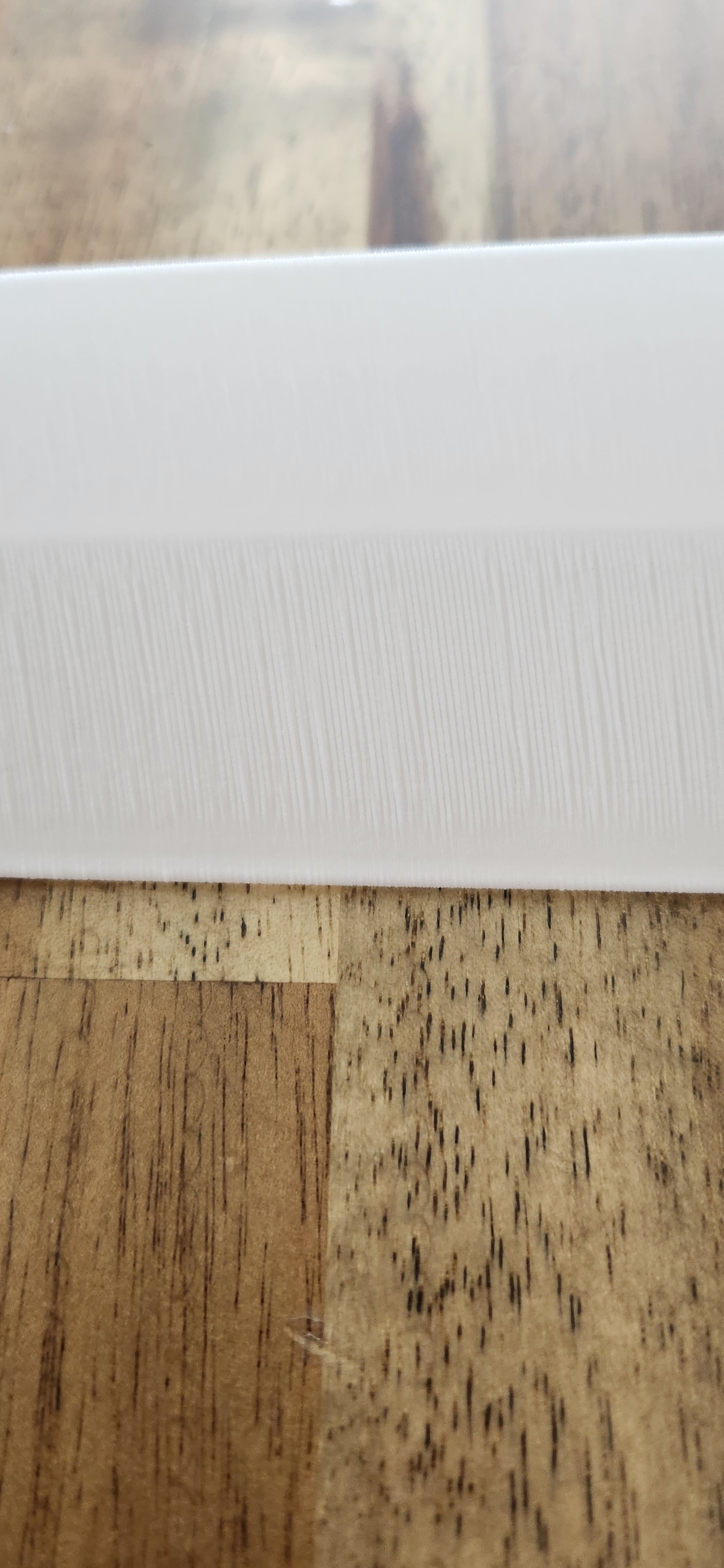

Before sanding

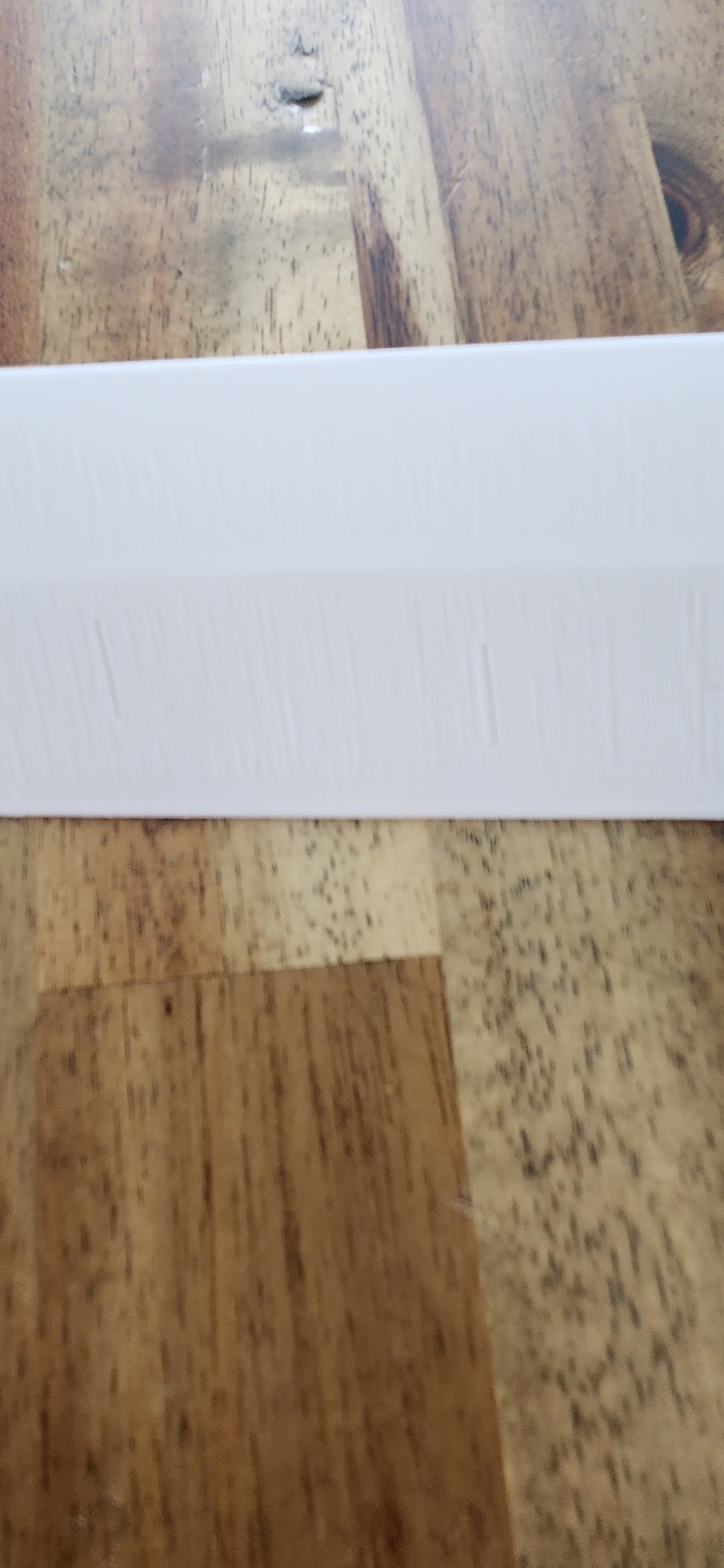

After sanding
Don't think it is supposed to have those lines.

Should I adjust my speed on my printer setting while printing, or adjust the flow rate on the printer.
I am using eclipsons gcodes.

The picture you posted are quite low quality and do not really show the problem you describe so it is hard to recommend a possible solutions.

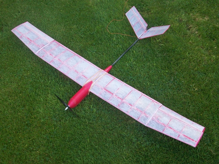

Printed structures in PLA are relatively brittle across the layers but about 5 times tougher along the line of the layers.
This tissue covered electric plane has a conventional "stick and tissue" wing construction except all the wing & tail parts including the sparo_O are printed in PLA and glued together!
The fuselage is also printed except the tail boom.
Its all about ensuring the PLA is laid down for each part in a direction best suited for the loads it has to carry.
It flies pretty well. A bit heavier than if it was done in balsa but then PLA is at least twice as heavy to start with.
