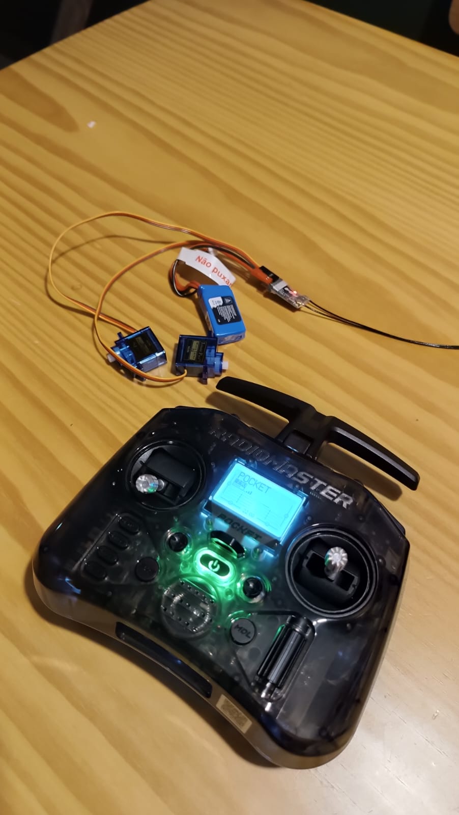

I alredy have the radio (rm pocketcc2500), 4 servos, foam board, glue and tape.
If I get another R84 reciever could I power it with 4aa batteries for testing in the plane? Is it possible or normal to get a battery pack that could stay in the 5v range so I wouldn't need a bec?

The power input range for the R84 receiver is 4.5-8.4V. So any battery that can supply that voltage would work. A pack of 4 or 5 AA batteries should be in that range. A two cell LiPo (7.4v) would also work and be lighter.
Thanks for the explanation my friend. Just to check, as long as I keep around that voltage I can go directly from battery to rx right?

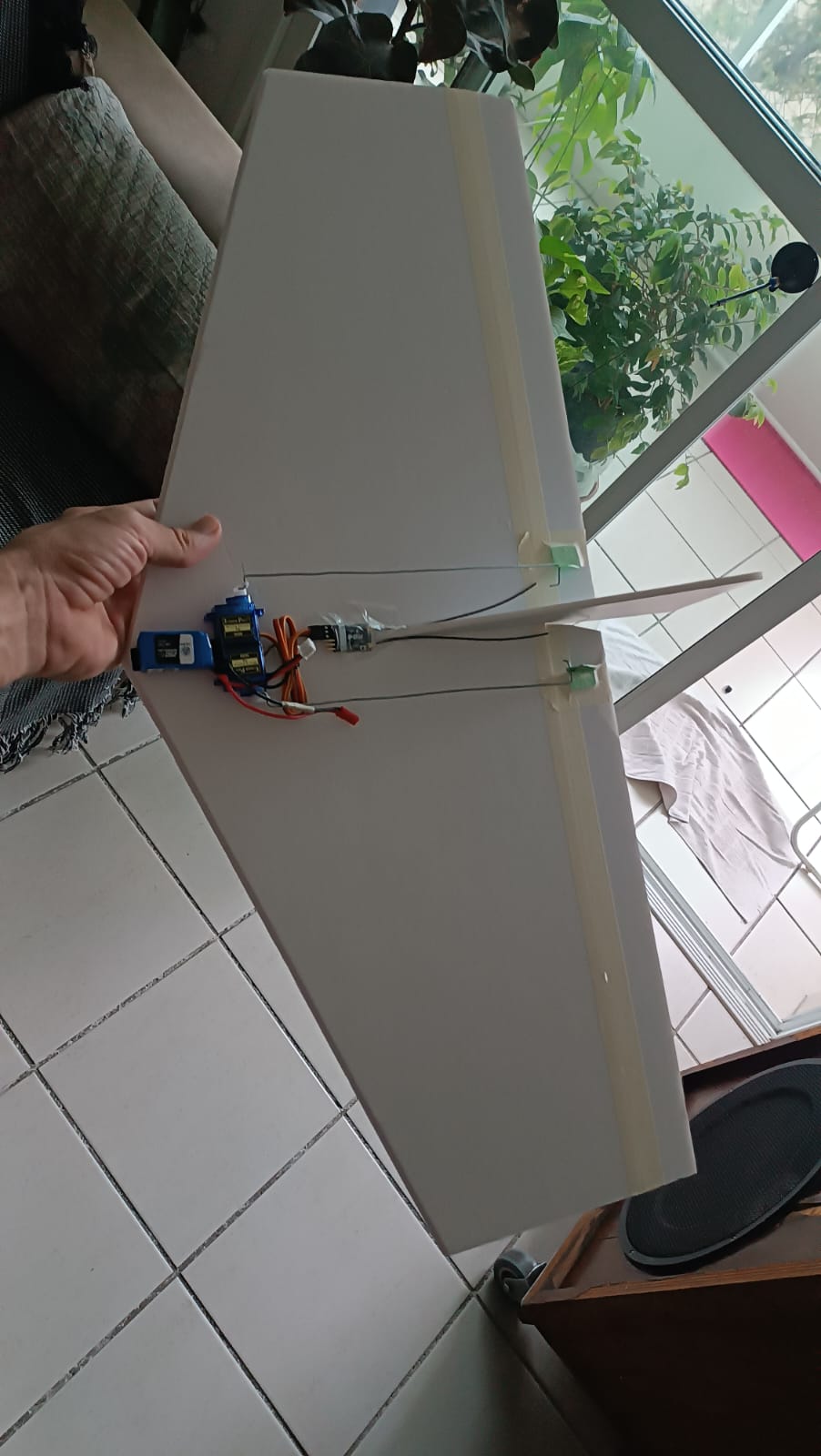

I want to thank all you for the help, thaks to you my first project is done.
AUW 109g
