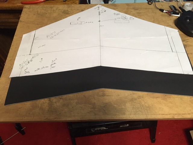

2) Enlarged plan.
Did 5 sizes and calc CG. This one was gut size feeling (short sides and longer). Fun part was to place electronics and balance 4 motor/props so all stuff is a go at 1/2 throttle.

2) Enlarged plan.
