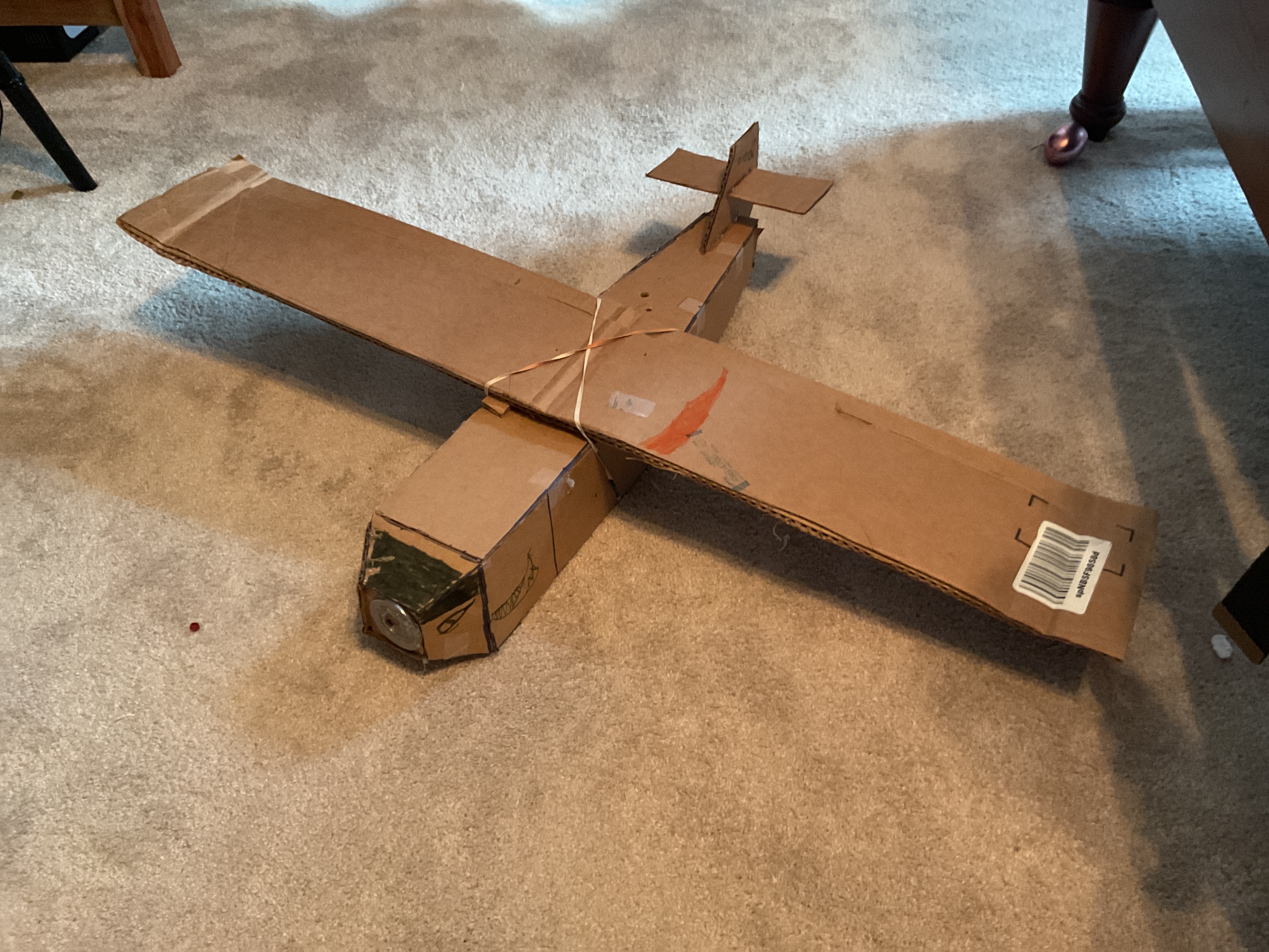

29rturner
Also here’s a picture of the first model
Tail is REALLY small, enlarge that a lot, the wings look saggy, and overall cardboard is not the best choice as it's strength to weight ratio and just overall weight isn't ideal for model airplanes
