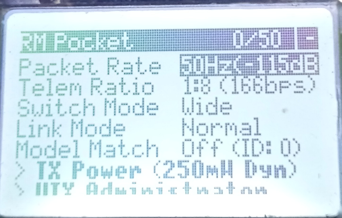

Make sure you are using 50hz with analog servos. They can not handle faster pulse rates.
Go to SYS -> ExpressLRS -> Packet Rate
If it is higher than 50 Hz, that is what is doing it.

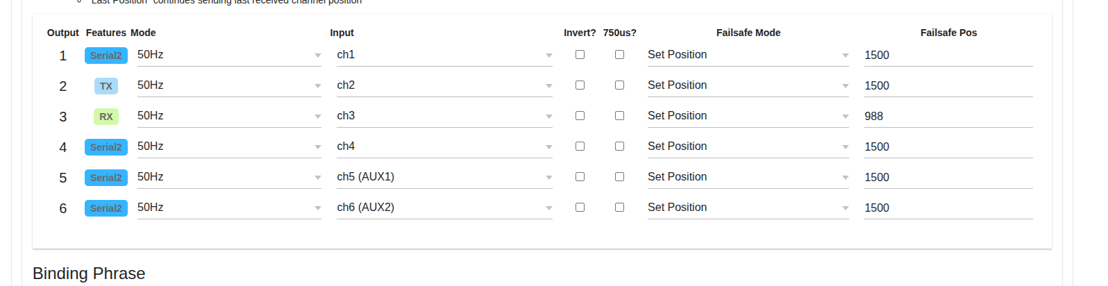

Thanks for this @LitterBug ,
I have thought about that and I have checked my RX's webUI menu and it shows that it is set to 50hz on the receiver. See below screenshot

I am a bit confused now, is "Packet Rate" in the ELRS menu the setting that sends the signal strength to the servos or is it this "Output menu" on the receiver itself that sends the signal to servos?
I ask this because my "Packet Rate" on my Radiomaster TX15 transmitter is set to 250 2.4Ghz as my research said that is a good balance between latency and distance. My thinking is that this is just the signal strength setting between TX and RX and not signal from RX to servo.
You are correct it is the setting on the RX web interface that matters, not the packet rate.

All 3 of my new radiomaster RX's are set to 50hz on the webUI.

I also would like to see what that page looks like for you @cd0g17 . Most ELRS switch modes have extended ranges on by default and EdgeTX might be reaching those ends by default even though it says it's only going to "100%" (like 100% in TX is mapped to 120% in servo timing) . Have your servos been failing without more than half deflection stick inputs or D/R limited inputs? I have definitely experienced some cheaper servos driving themselves past their maximum throw without showing any visible or audible sounds and then dying shortly after.
