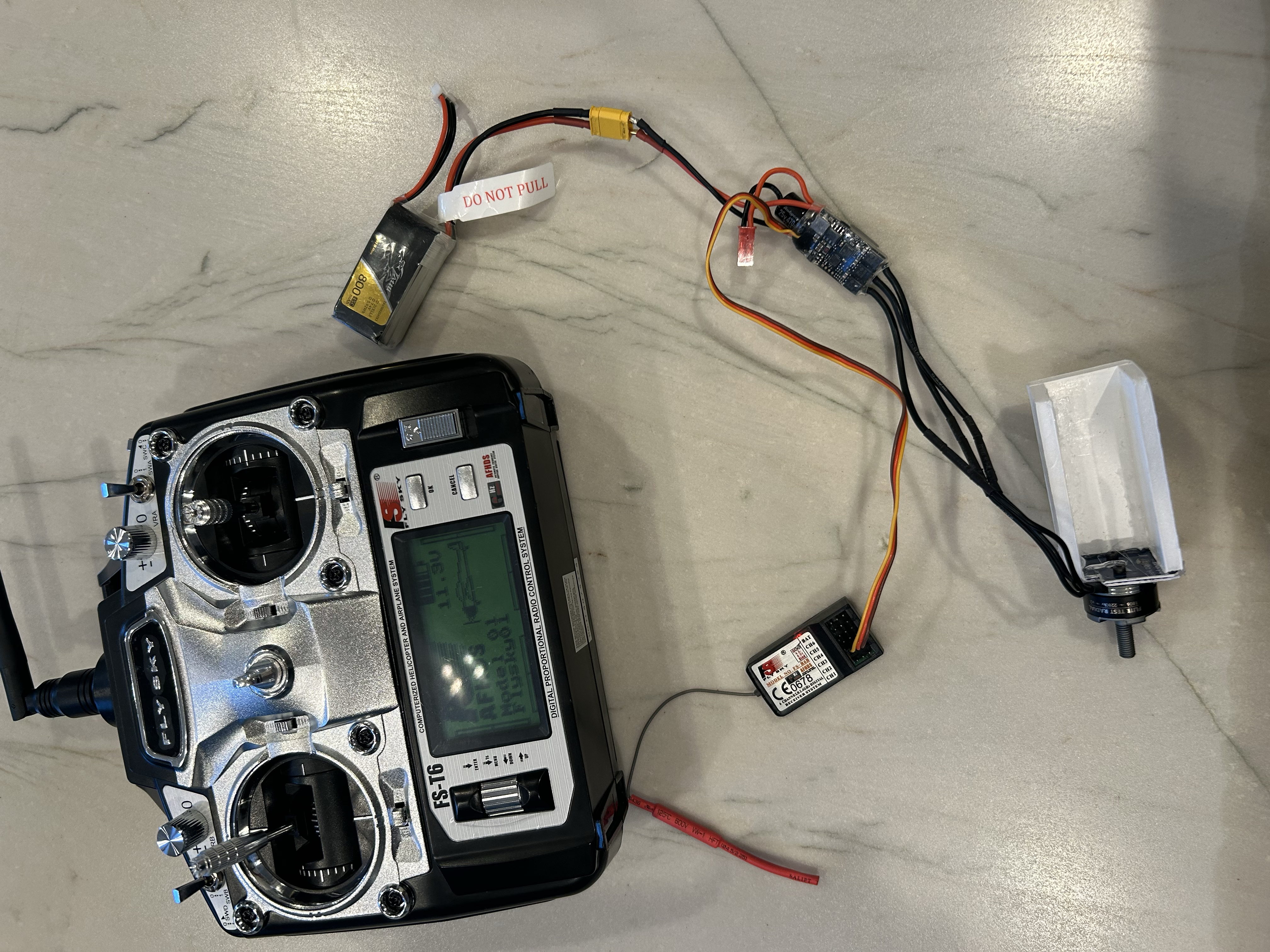

Hi, we're new to RC planes, and my son built the FT mini trainer as his first plane. We were successful in getting all the electronics to work and started flying. After several crashes he decided to rebuild the airplane and his new build is much cleaner and ready to fly. However, as we connected the electronics we could not calibrate the ESC and we have no throttle.
Equipment: FlySky FS-T6 transmitter and receiver, Flight Test Power Pack A model electronics. All same equipment on both builds. Picture of setup attached.
Receiver pairs (light goes solid), but when we try to calibrate the ESC, there is no beep, and no throttle. We bought a second ESC and have the same issue. Any ideas we can try or ways to test what may be the issue? I haven't seen anything on this forum that has helped. Thanks!

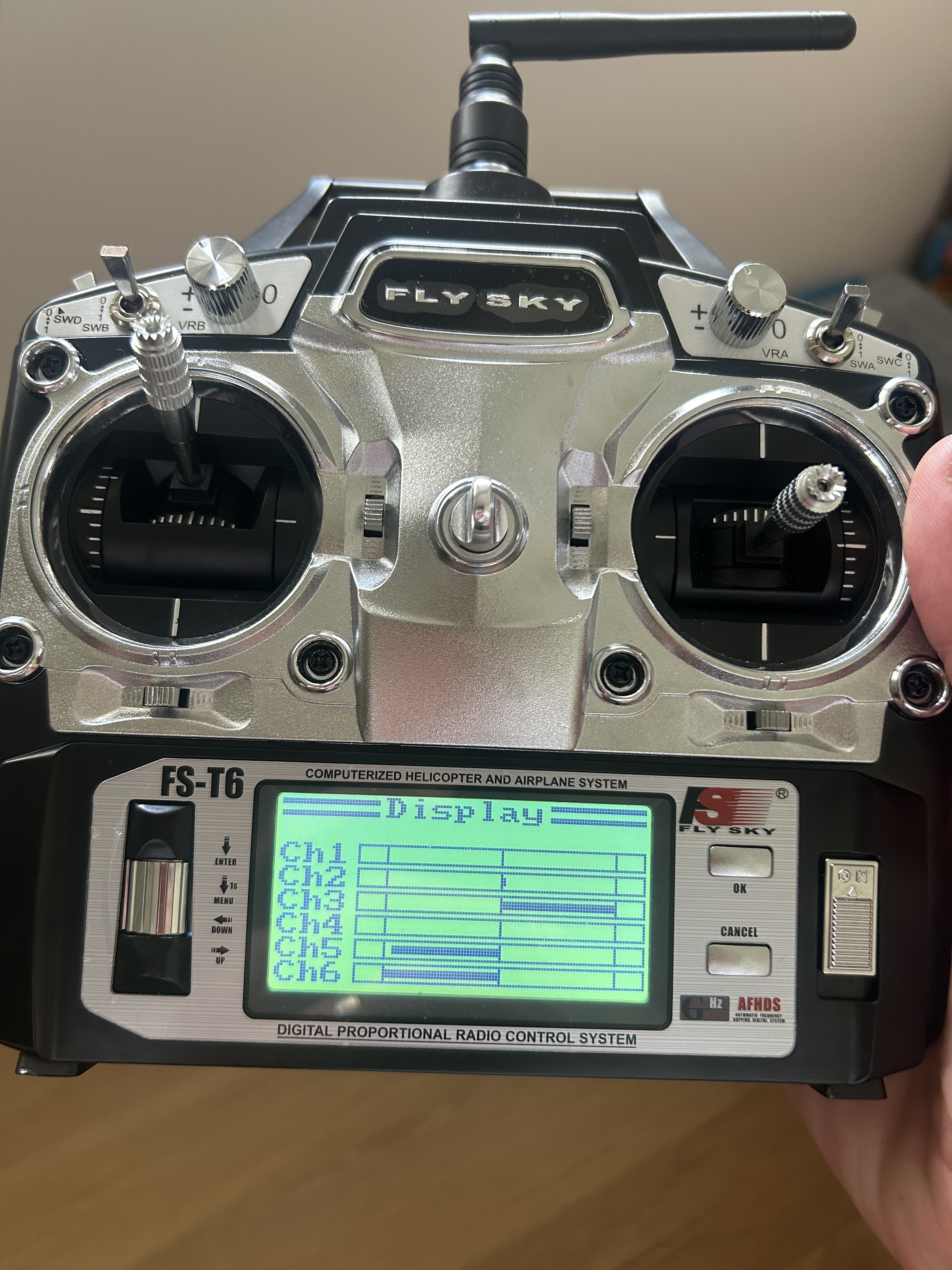

Newbie001
I’m not sure what the Modes are, but this shows that the left stick vertical movement is controlling channel 3 (throttle).

Foamforce
There ought to be beeps of some kind, even if it’s not hooked up correctly. I suspect that the motor was burned out. The motor itself is used as the “speaker” to make the beeps by vibrating it rapidly. If the motor is burned out, you won’t get any beeps.
If you turn the motor by hand when everything is unplugged, do you feel any resistance? You shouldn’t, other than a tiny lumpy feeling as it passes the windings.
To rule out the receiver or binding as the issue, plug the ESC into the BAT port. Then plug a servo into port 3. When you do that, the throttle should now control the servo. If it does, then your binding and receiver are both fine and since you already replaced your ESC, then it’s probably a burned out motor.
Motors can easily burn out if you have a crash and accidentally leave the throttle turned on for several seconds while the prop is held, so that makes this plausible.
