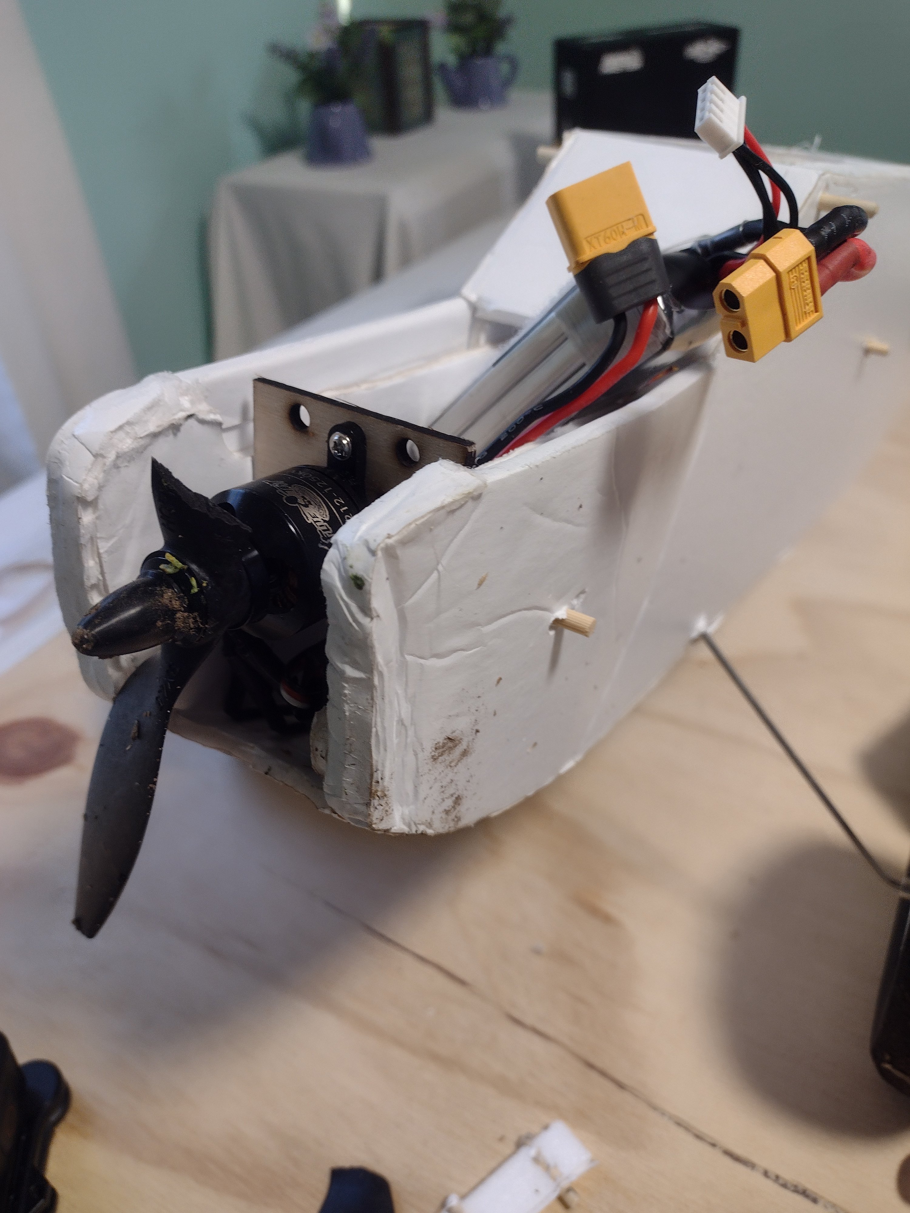

I took the plane out intending to try some short take offs and landings. As I increased the throttle and pulled back the elevator it would go straight up and stall and pull to one side before crashing. Should I have toggled the rates to 50 percent? Thoughts on what I did wrong?

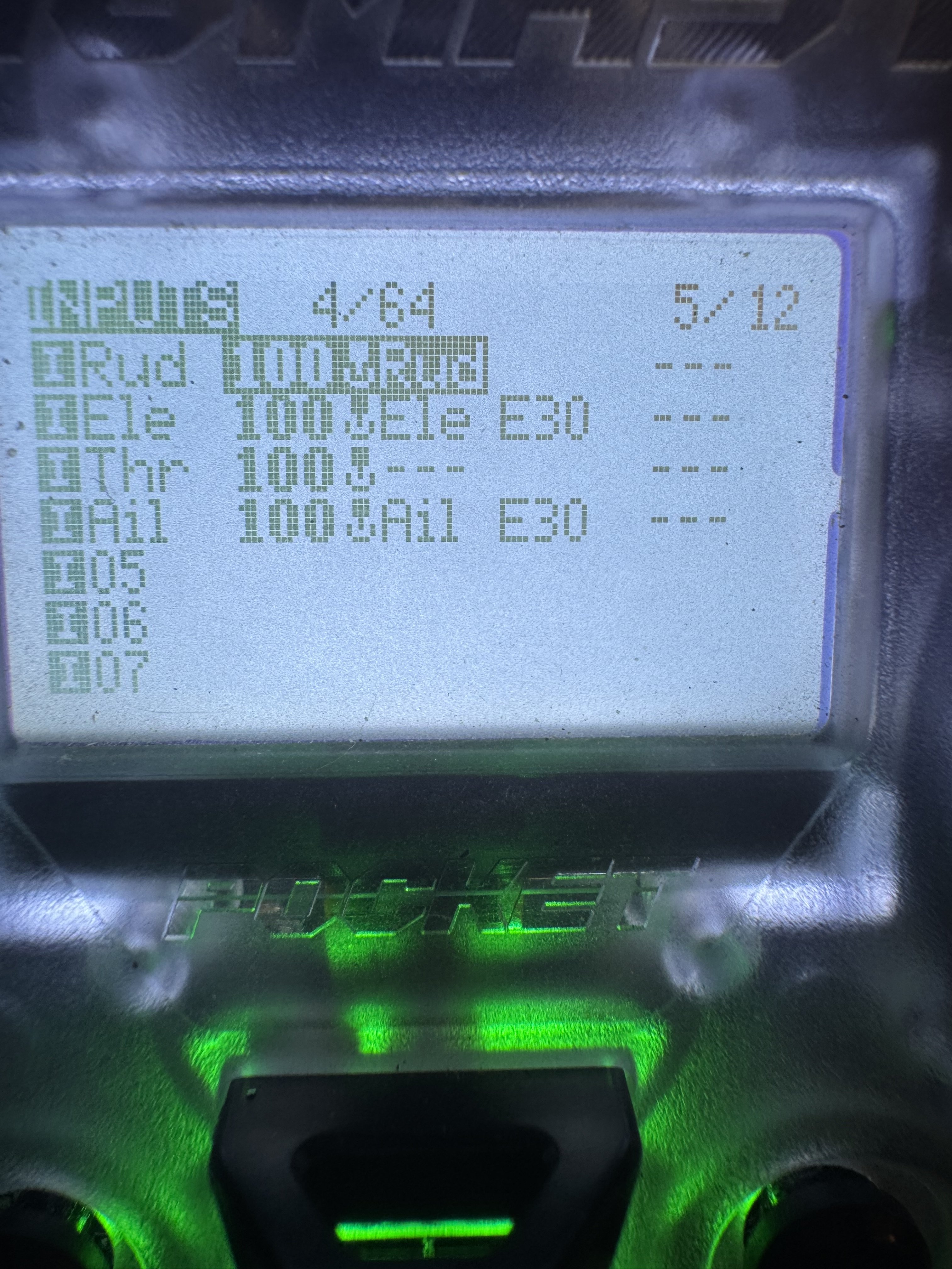

First, let me thank you for your willingness to help a complete novice, it is much appreciated. Does this screen show the expos at 30 percent? I'll check out the video when I get a chance.

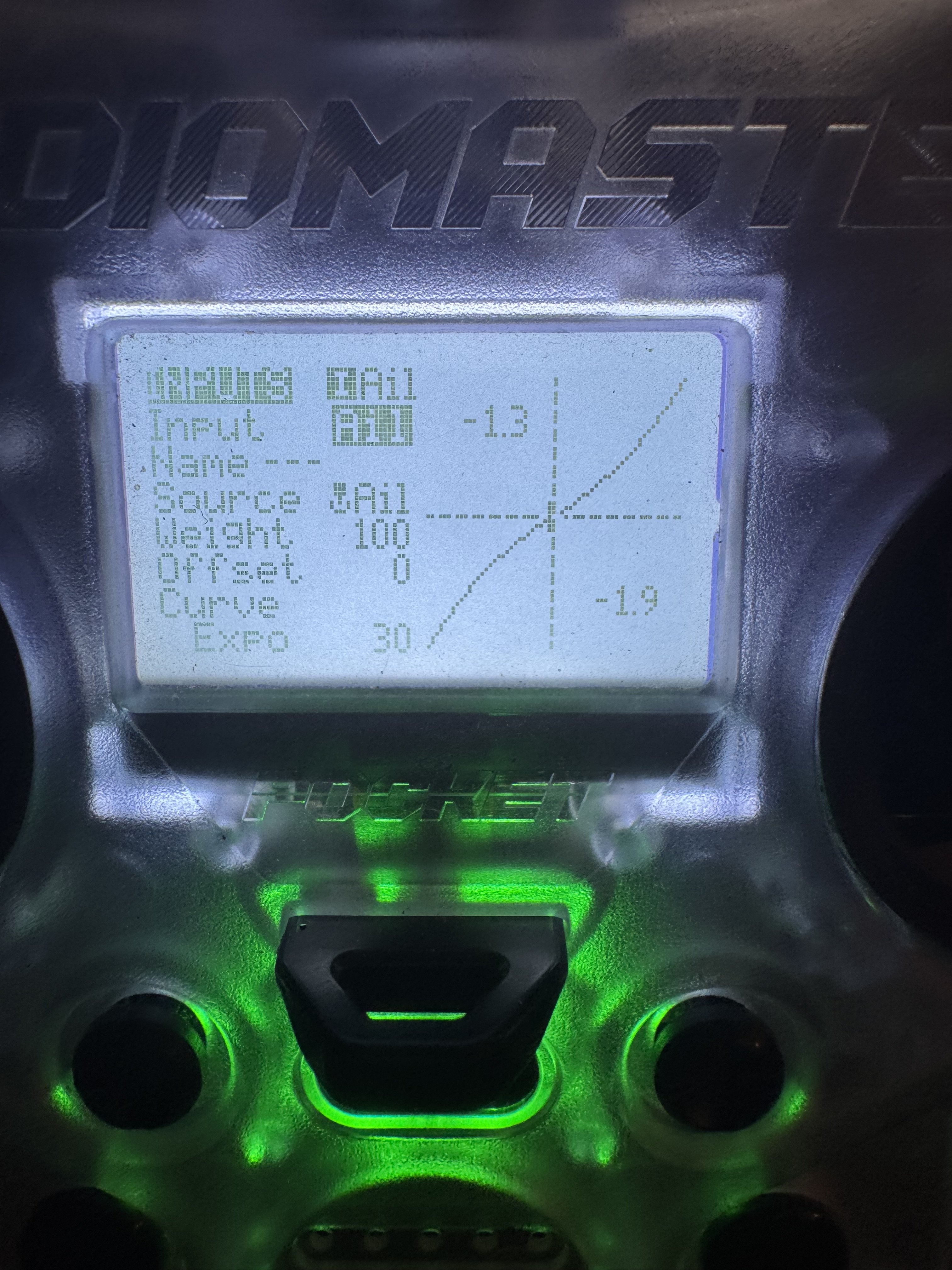

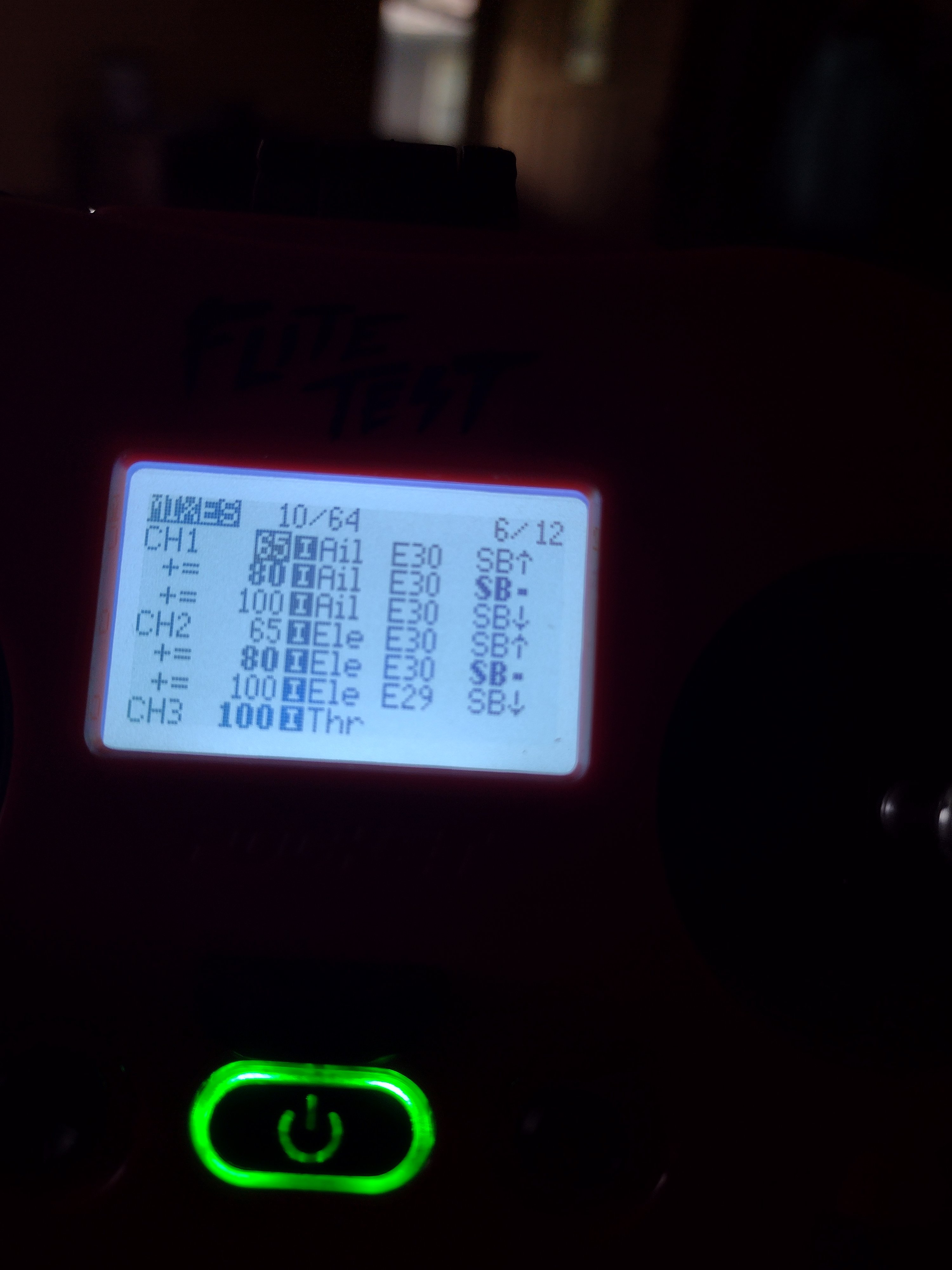

i run expo on my input, hold down “select” with the spinning wheel until a window opens, select edit, scroll down.
pics below yo 👇🏻
yes, you applied expo on your mixes page.
i just personally do it on my input page so its first in the chain and goes to everything.

I didn't put the expo in on the mixes tab, it came that way. But if the expo shows 30 percent, why does the graph remain blank? Should I still try and add it in the input tab? I get it, it is quite addictive.
alan0043
