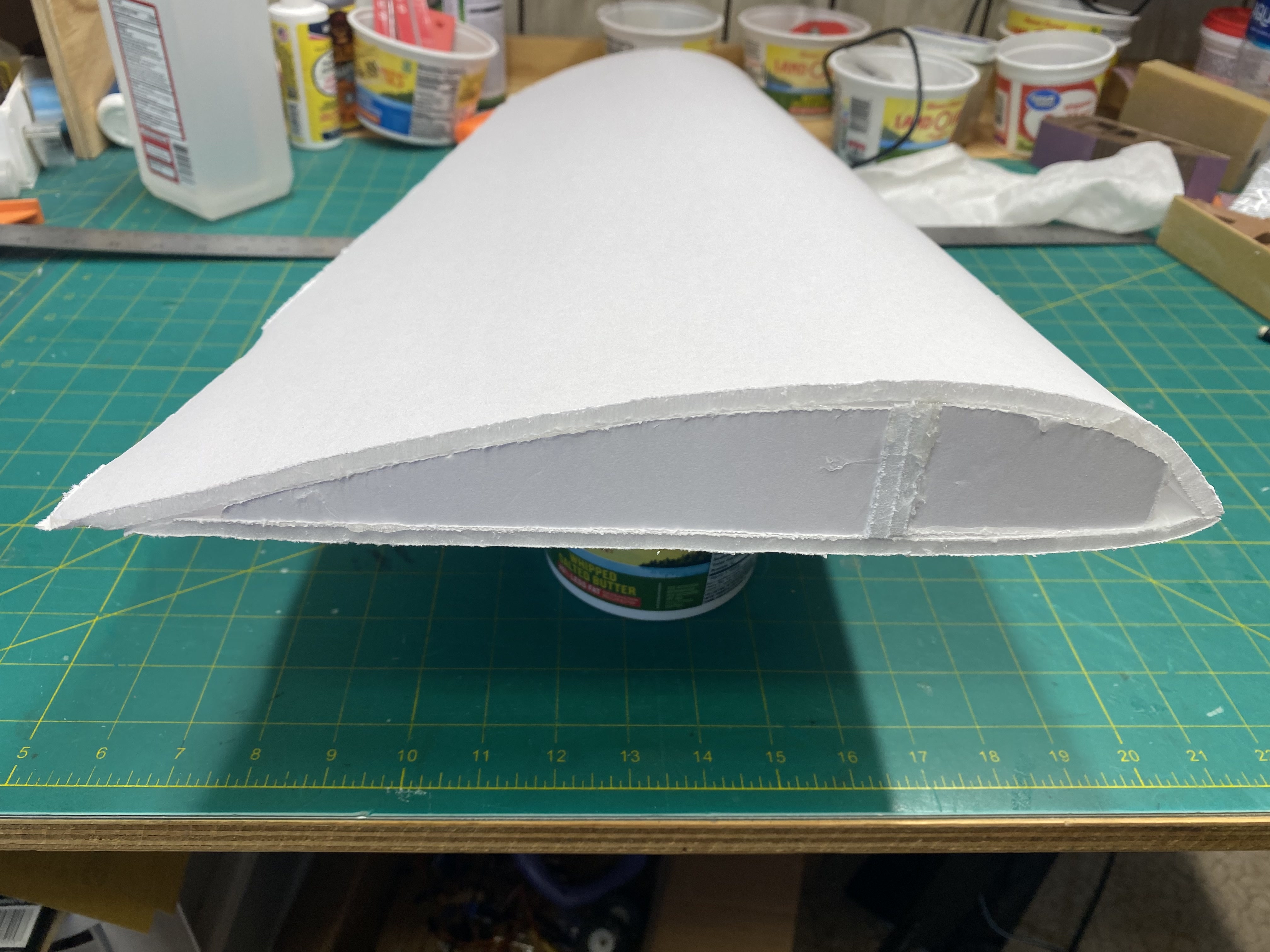

All the 3 views and cross section plans show a thick airfoil, about 1.5 times thicker than a Clark Y. It will be interesting to see what it does. I was impressed with the sharp trailing edges on the PrandtlLight so I thought I'd try that too.

That might be the nicest looking foam airfoil I've ever seen. Sharp trailing edges look good and are a bit lower drag, but they do also slightly hurt the stall characteristics sometimes
