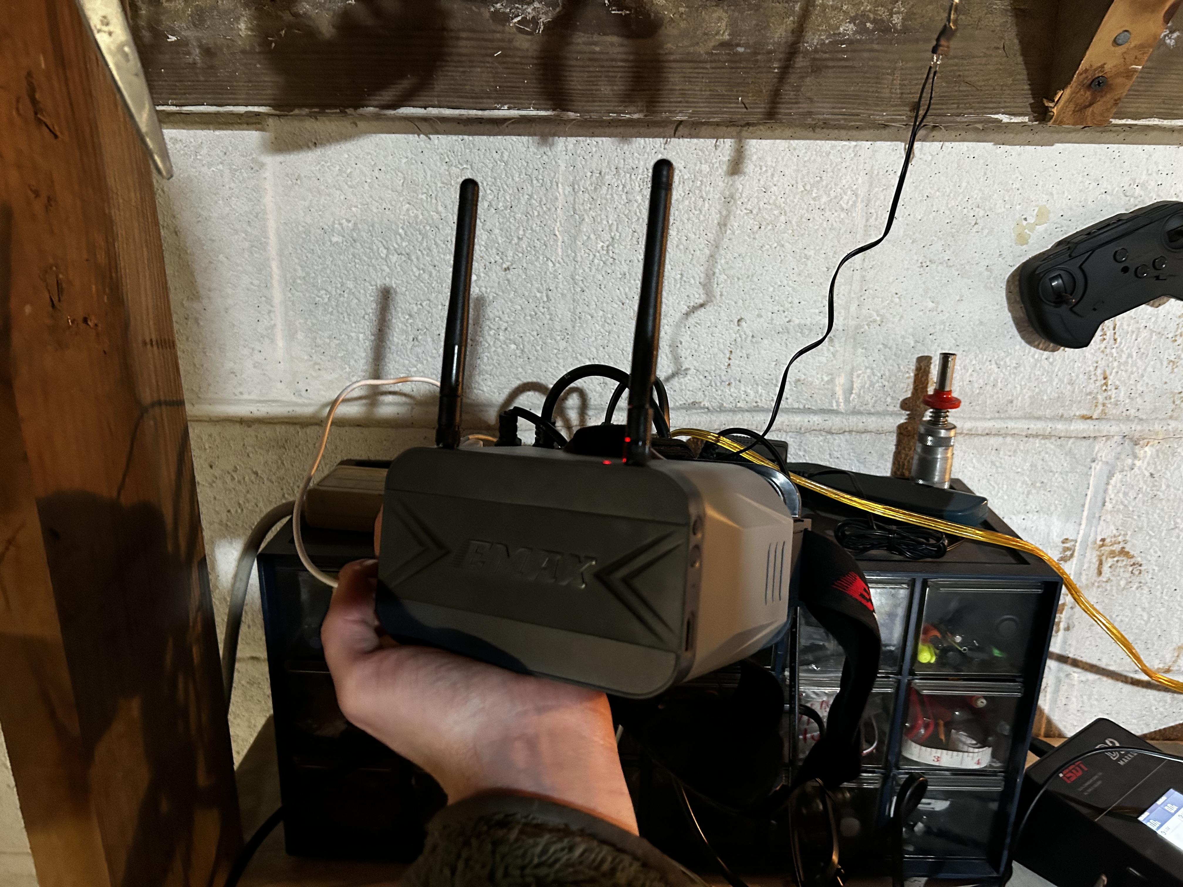

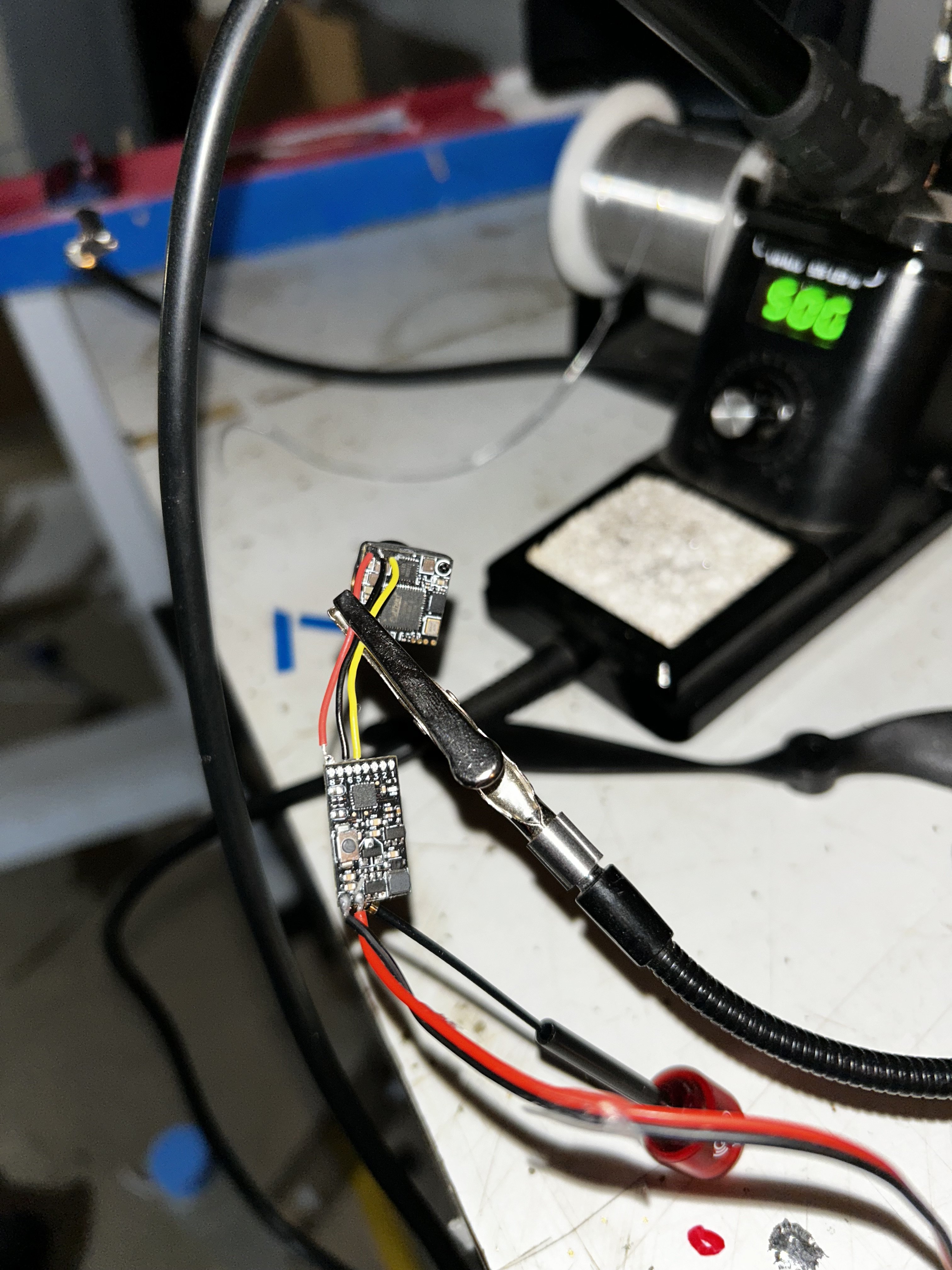

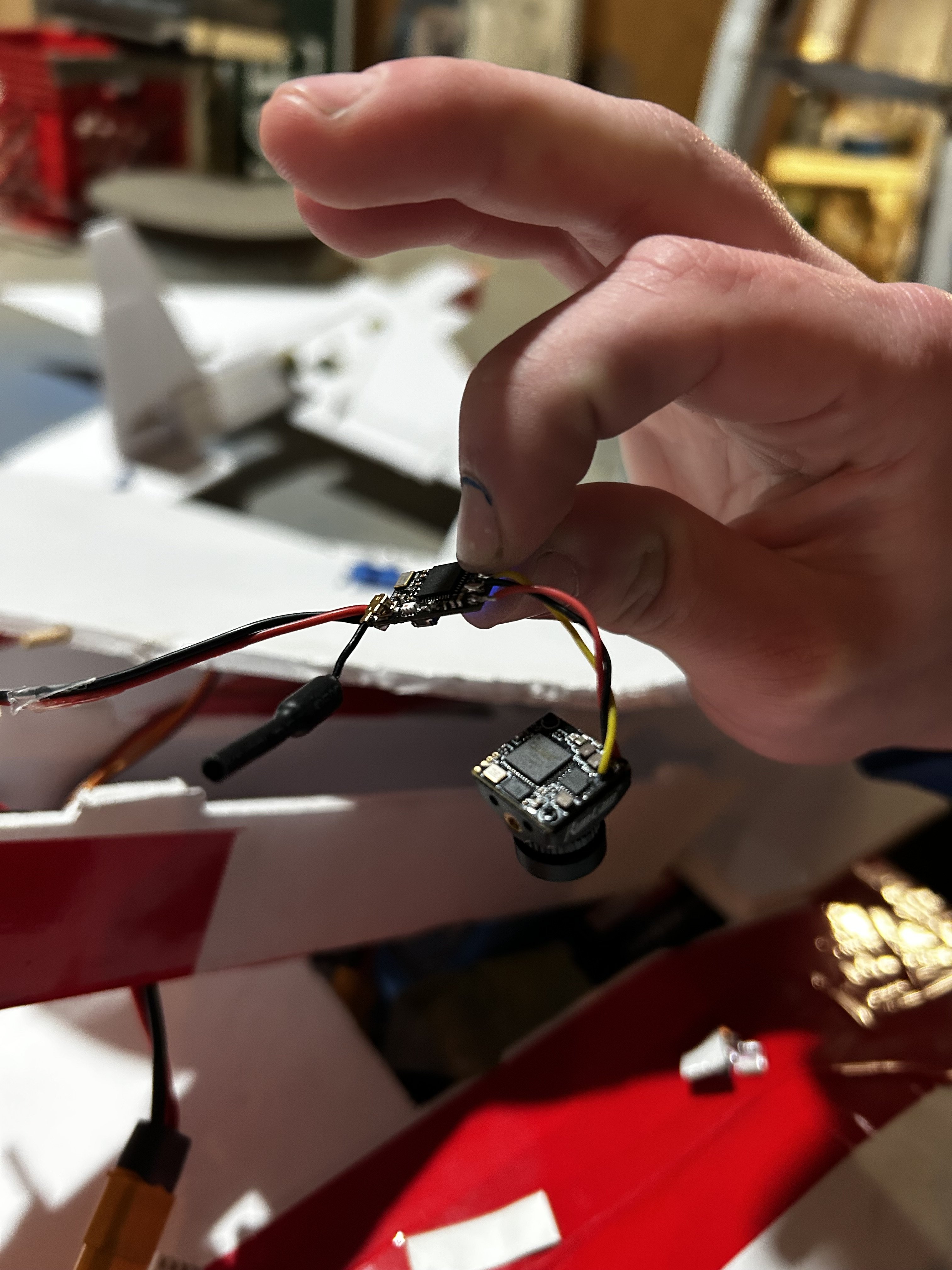

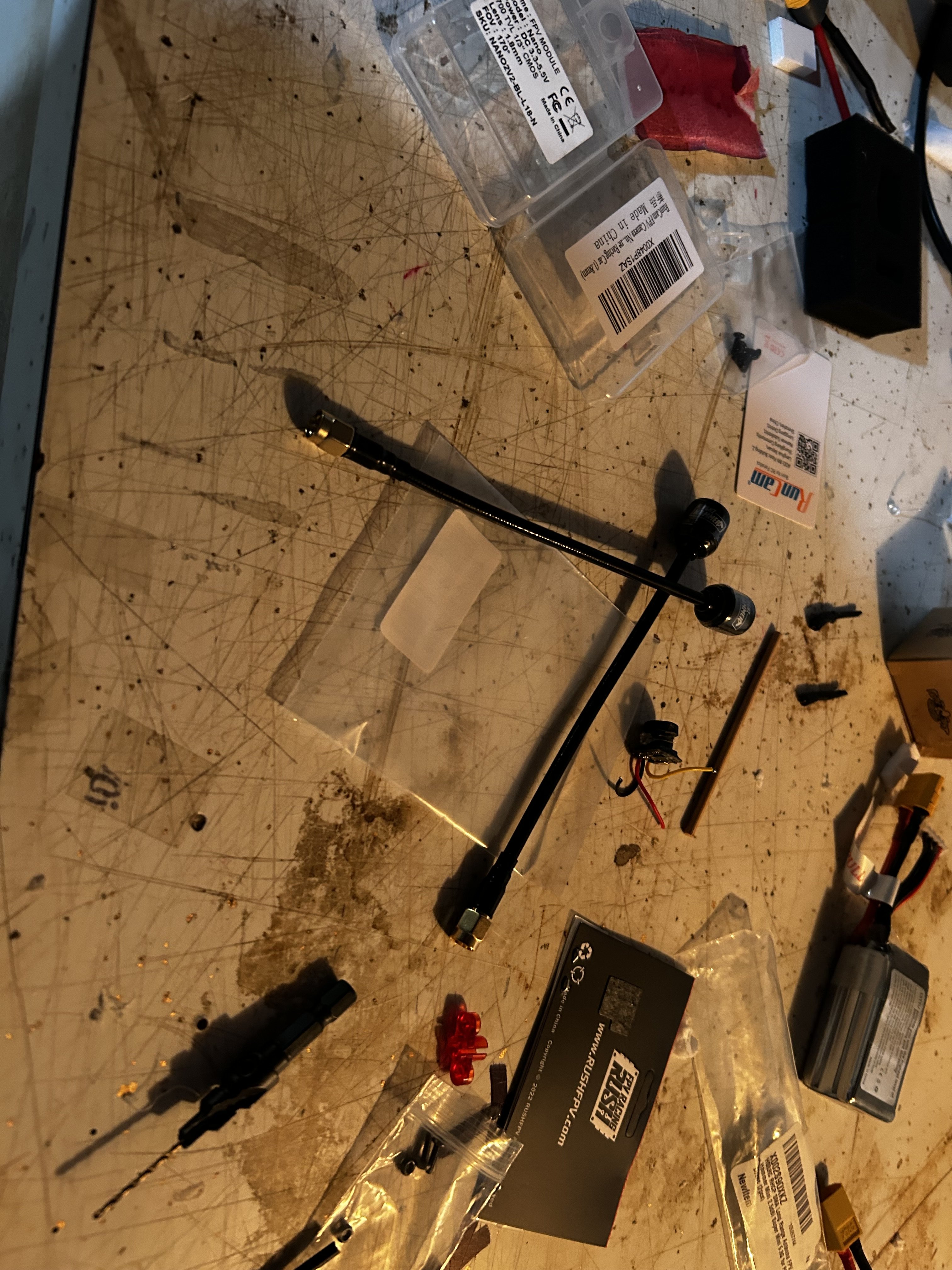

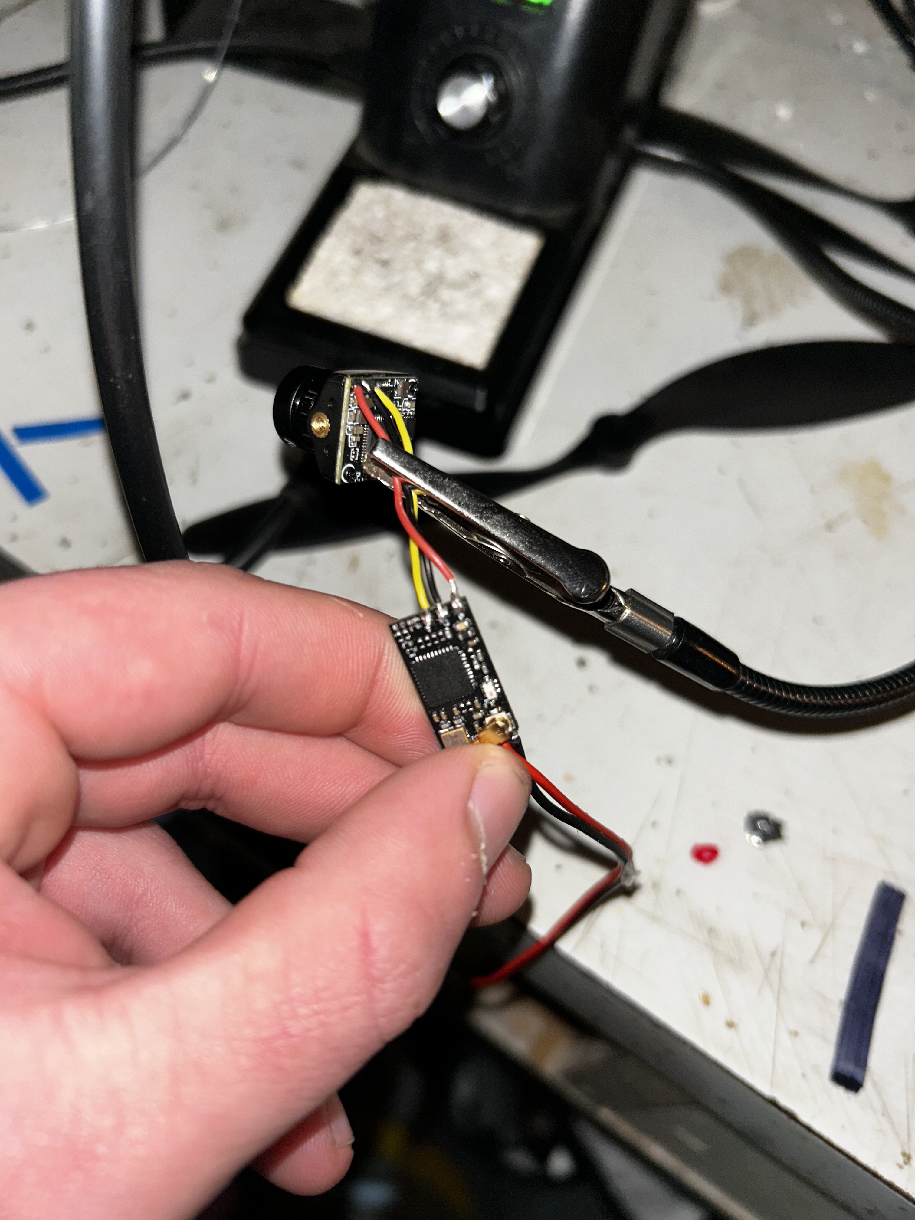

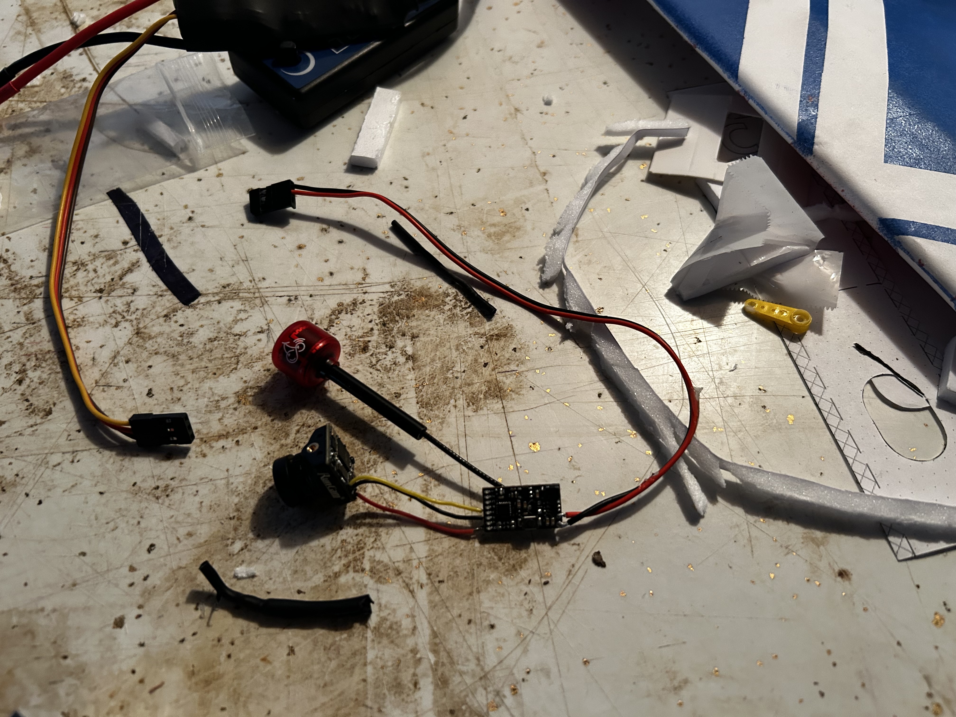

Does anybody in this thread do fpv? I recently got my first FPV setup, it is Emax transporter 2 analog goggles, and an AIO camera/transmitter. I recently crashed a plane with the camera onboard into a wall, and my camera stopped working. I bought a runcam 2 mini and some different antennas on amazon, and have been trying to get the two to connect. For some reason it only barely connects when I have my finger on the transmitter, and even then it is very jumpy, and not clear at all.
I have pictures of my setup if ya'll need it. Thanks!

The AIO setups tend to be questionable at best in my experience. It sounds like you're trying to connect the new Runcam to the AIO? Can you show us how you're doing it? How are your soldering skills?
MadMonkey
What about the antenna? Is it using the stock connector?
Since it's working (slightly) when you press on the connection, maybe trying to solder it again would be worth a try, making sure ALL of the connections are solid and clean.

The antenna is a new one, it has the same connector as the stock antenna. I have tried it with the original antennas as well with the same results. I will try to resolder it.

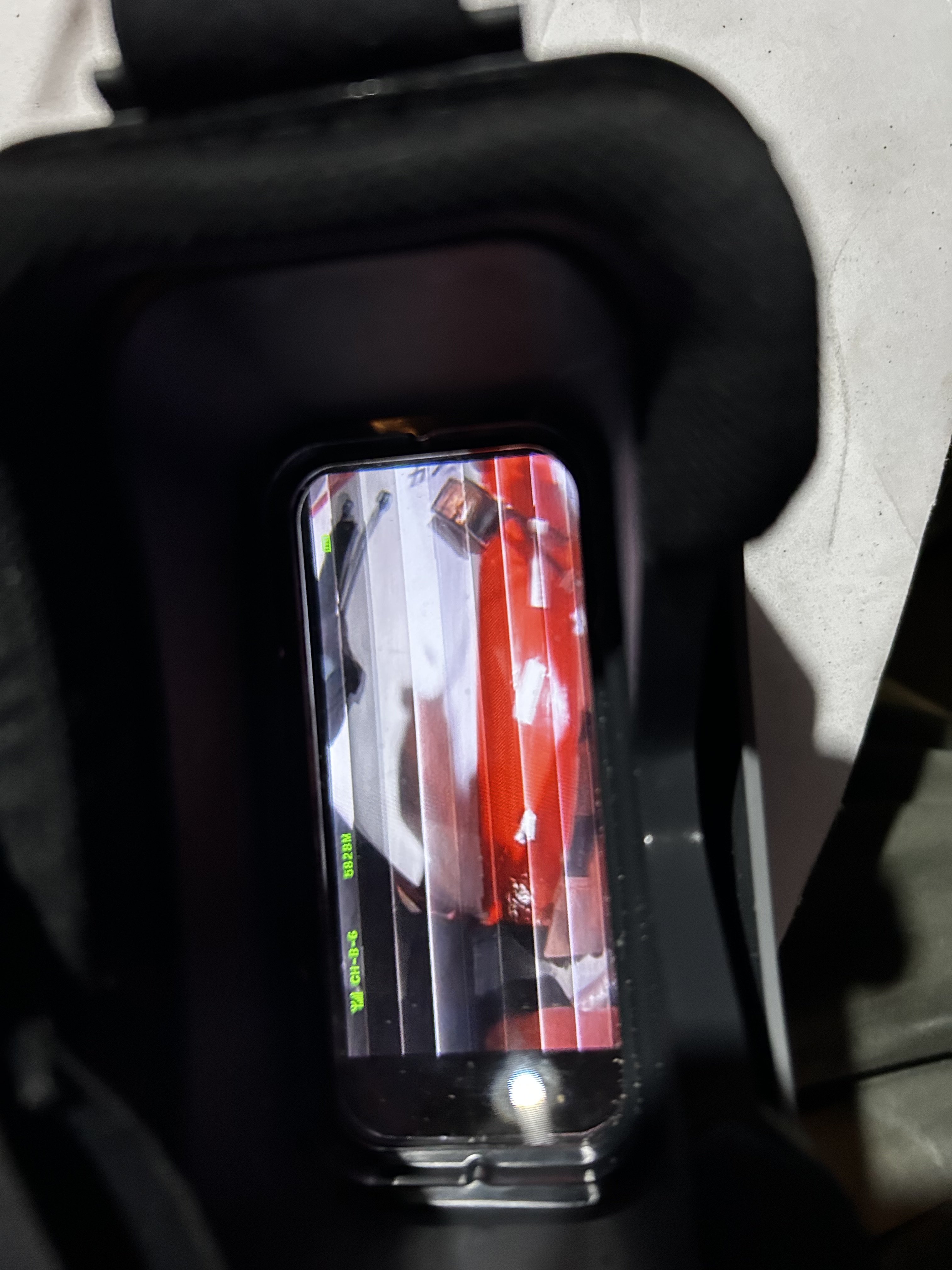

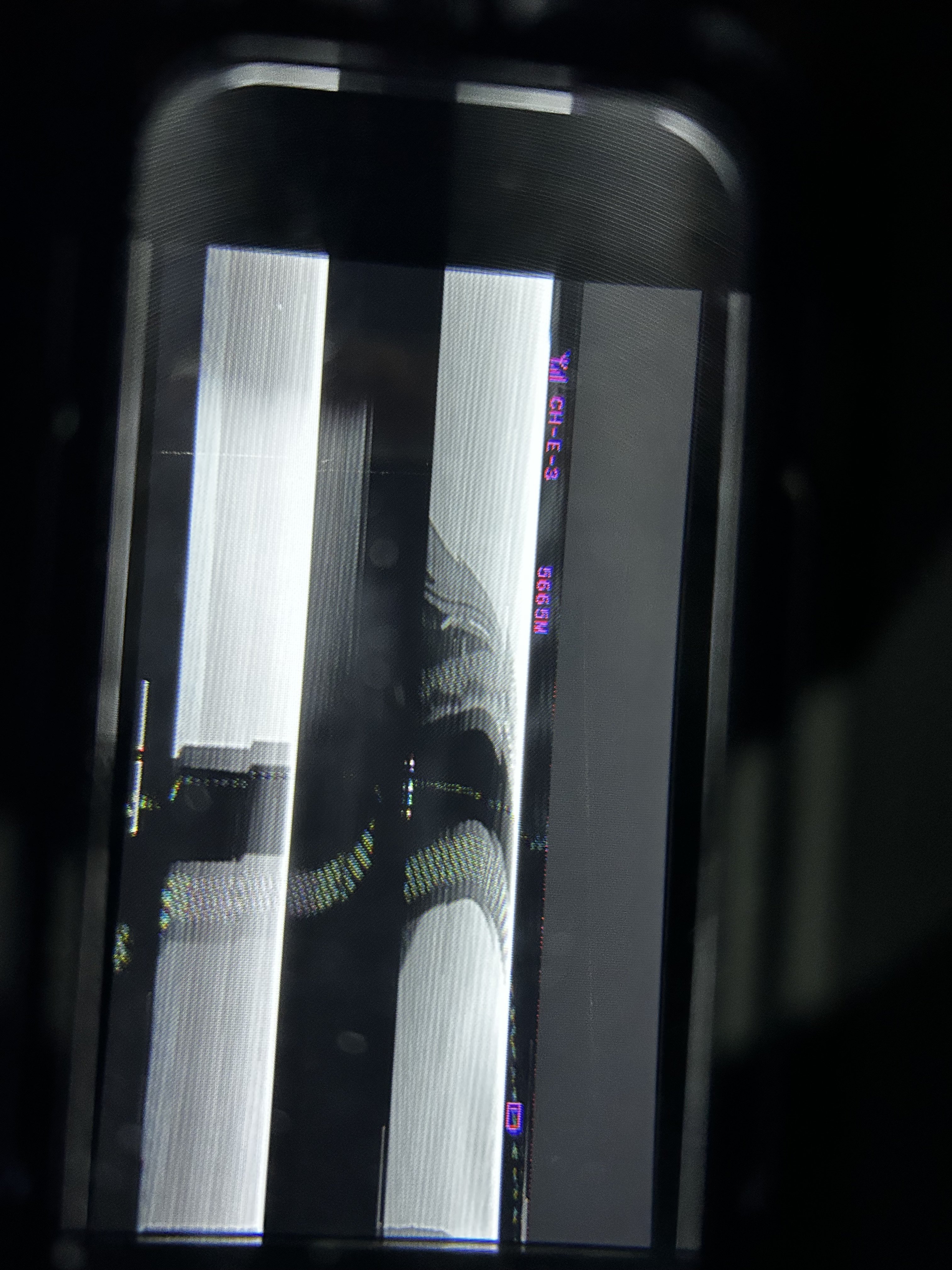

I have checked the connections, and they all appear to be fine. I have found that when I pinch both sides of the transmitter in a specific spot the picture comes through.
Since I have used a little bit of hot glue to hold the transmitter to my planes, I am wondering if I pulled off a resistor on the transmitter board or something. Thanks for all y'alls help!

Yeah, it's sounding like that wall whack knocked something loose. That's beyond my abilities unfortunately 😞 But at least you have a good idea of the problem now!
