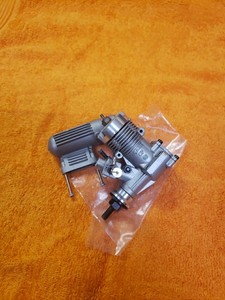

Hello! I recently bought an in box little tiger 15 nitro ARF rc plane, and had some questions about it. Mainly what epoxy I should use for assembly, and how to rig up an engine test stand. I will probably have more questions on it soon since it is my first ARF and "first" nitro plane. Thanks!
When you do your engine run-in, make sure you keep it running on the rich side. That way, your engine will last for a long time.
leo370
The engine calls for 10-15% nitromthane in the fuel, and to use caster oil. I have 20% nitro fuel, should I mix in more caster oil than with the 15%? Or should I use synthetic 2 stroke oil instead?

It's a magnum gp15
Gas tank should be level with the carb fuel lines hooked up, fill tank. Leave glow plug battery off place thumb over venturi turn prop by hand until you see fuel reach the carb. Needles set at roughly 11/2 to 2 turns attach glow plug starter should pop off. If not check glow plug by pulling it out and attaching glow plug starter if it does not glow cherry red need a new one. Are you starting by hand or using electric starter?
leo370
I have only tried to start it by hand now, because I fell that my starter will be to violent. I bought some caster oil as per the manual, but I'm not sure how much I should put in the tank with the fuel.
