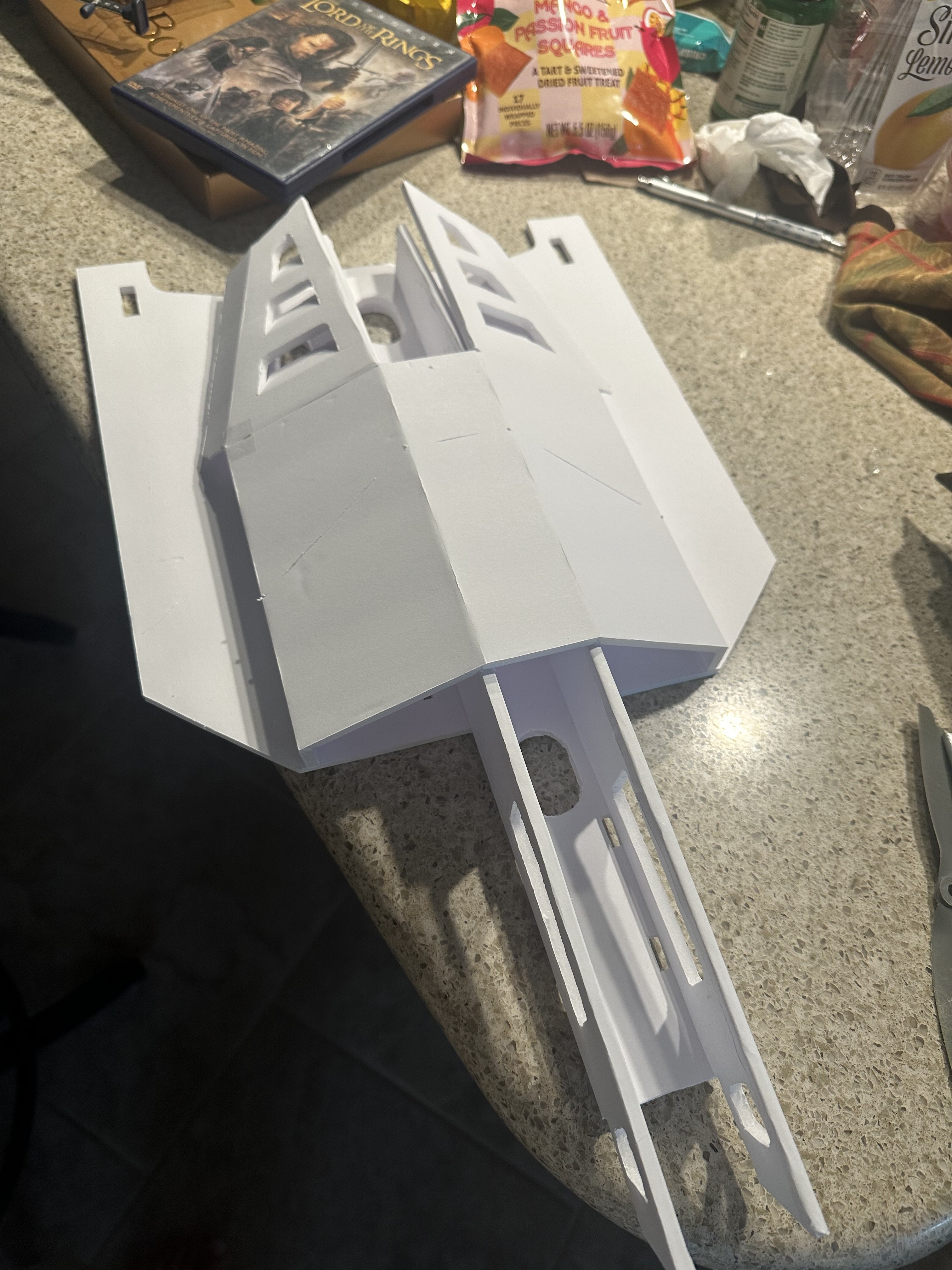

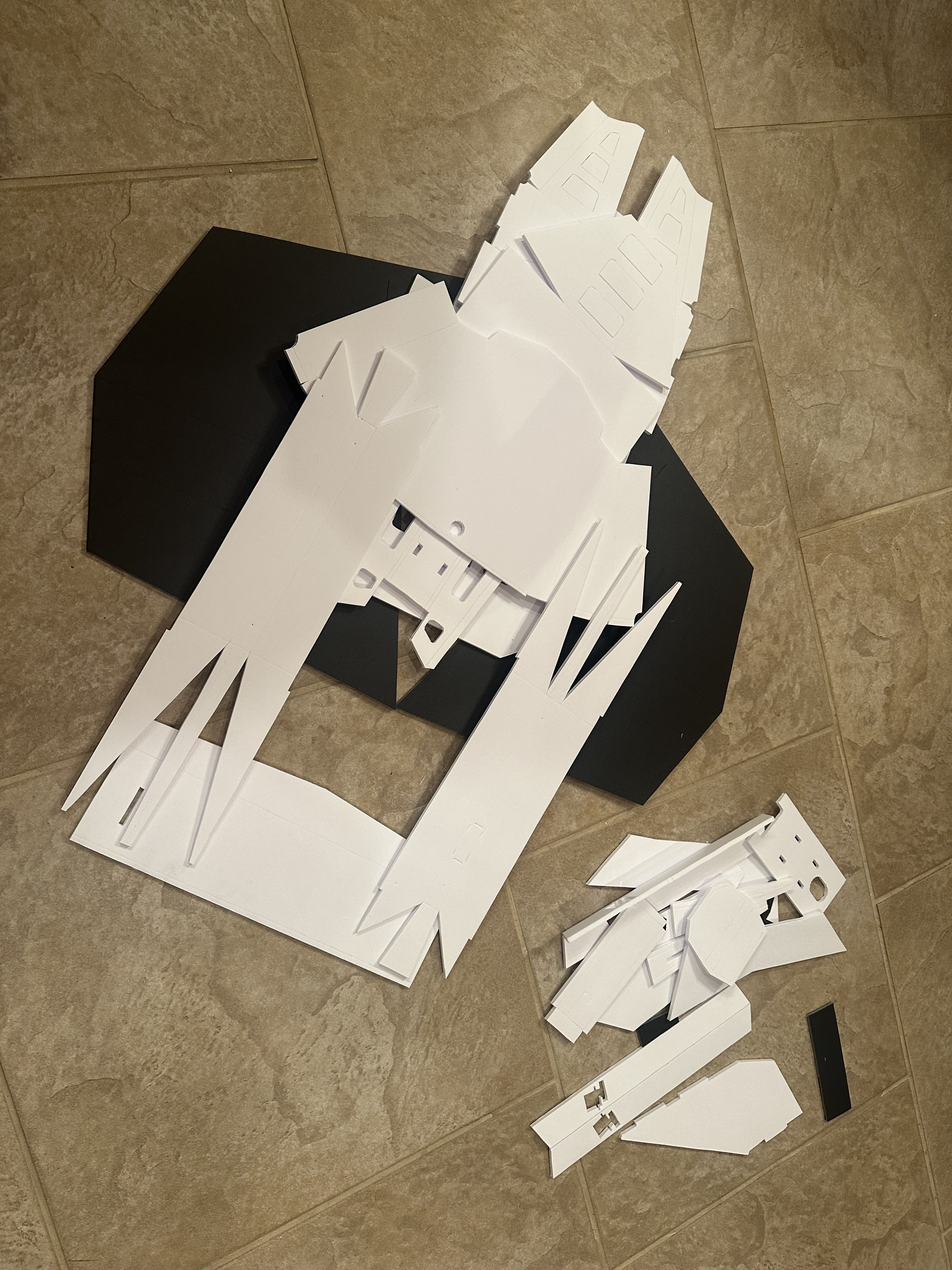

Started a new build! It’ll be my first flerken (boomin version) and so far I love the design. I’ve always enjoyed building low-poly planes and this one has been no exception. I ran out of hot glue so I have a box of 85 sticks coming from Amazon tomorrow - should last me a little while haha.

I have the regular flerken, its a blast! My only issue with it was that I had the CG on the marks when it likes to fly a little behind them.

Nice. Boomin Flerken is alot of fun. After many flights I have noticed the wings starting to get weak at the connection point. I believe due to taking impact from landing, gear works great but no shocks, so the wings absorb it. Next one I make I will put some spars in the wings to compensate. I will use Nerdnics aluminium spar design (modified to fit of coarse) to solve this. If you haven't got too far you might try that (or something similar). With that sat it did take a couple dozen flights to start to show the wear on the wings, but mine will fail soonish I believe. Just something to think about.

I'm planning on making this a hand launch and belly lander, so I'm guessing that will put most the impact strain on the fuselage. I am a little concerned at the complete lack of spar through the fuselage though, I might see about designing a 3D printed spar to go in there.

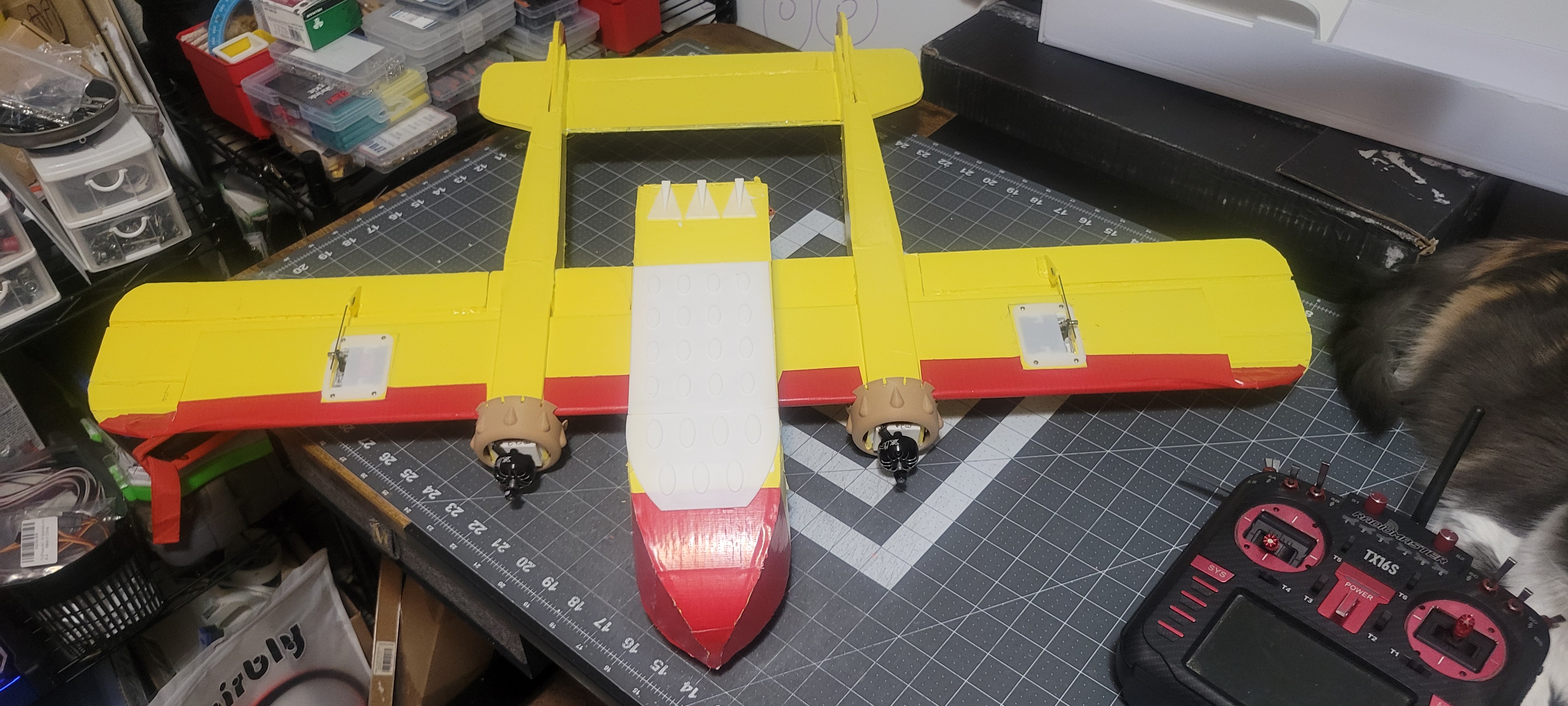

The front has just a slightly different angle at the top to fit the front nose. They just hot glue to the bottom of the plane. Here is a picture of something similar I do to the Sea Duck. Different but same concept. They work great to protect on belly landings since i mostly land on asphalt. Just remember to put the hot glue on the plane first and not the 3d printed part (the print will warp badly if you add the glue to it first).

That makes more sense, thanks. I'll print them off and try them out

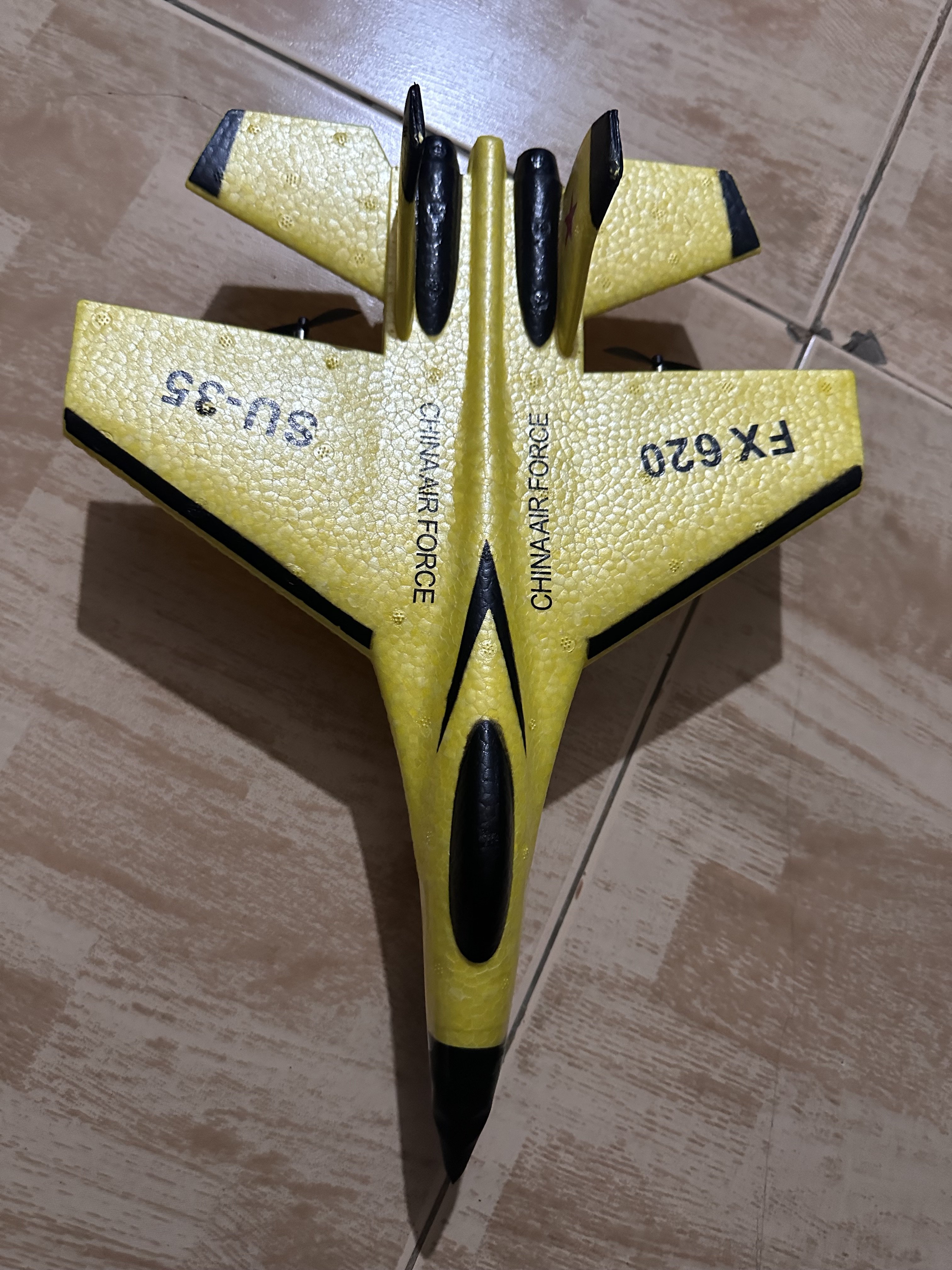

Was scrolling on Facebook when I saw an ad for this 2 channel plane. I needed some parts for my micro planes so decided to get it. Only issue is it didn’t come with a battery…anyone know which electronics I can tear apart to get a small 150 mAh 1s lipo ?
