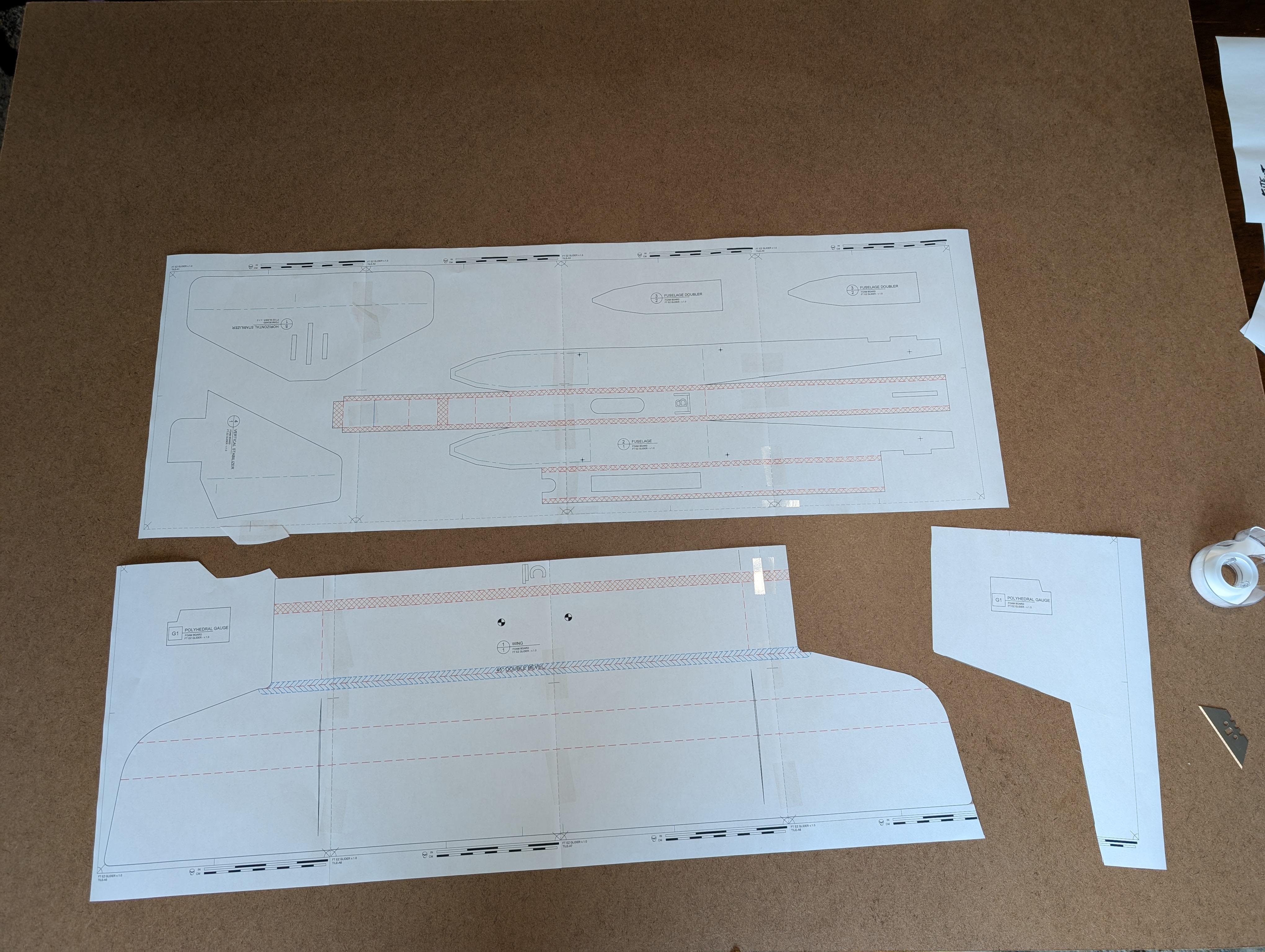

This past week I started getting things ready to build a Simple Scout. Printing off plans, ordering parts, a charger, finding foamboard, etc. Most things have arrived and starting my first build today.
To start, I've printed out the plans for the EZ Glider. This morning I got them taped together and started cutting out the templates, before heading out to run some errands. I'm going to use this to help learn the building techniques, before I begin the Simple Scout.
Later today, I'll get the rest of the templates cut out and start tracing them onto the foam board. Hopefully, even get started cutting foam. We have a busy day, so we'll see how far I can get.

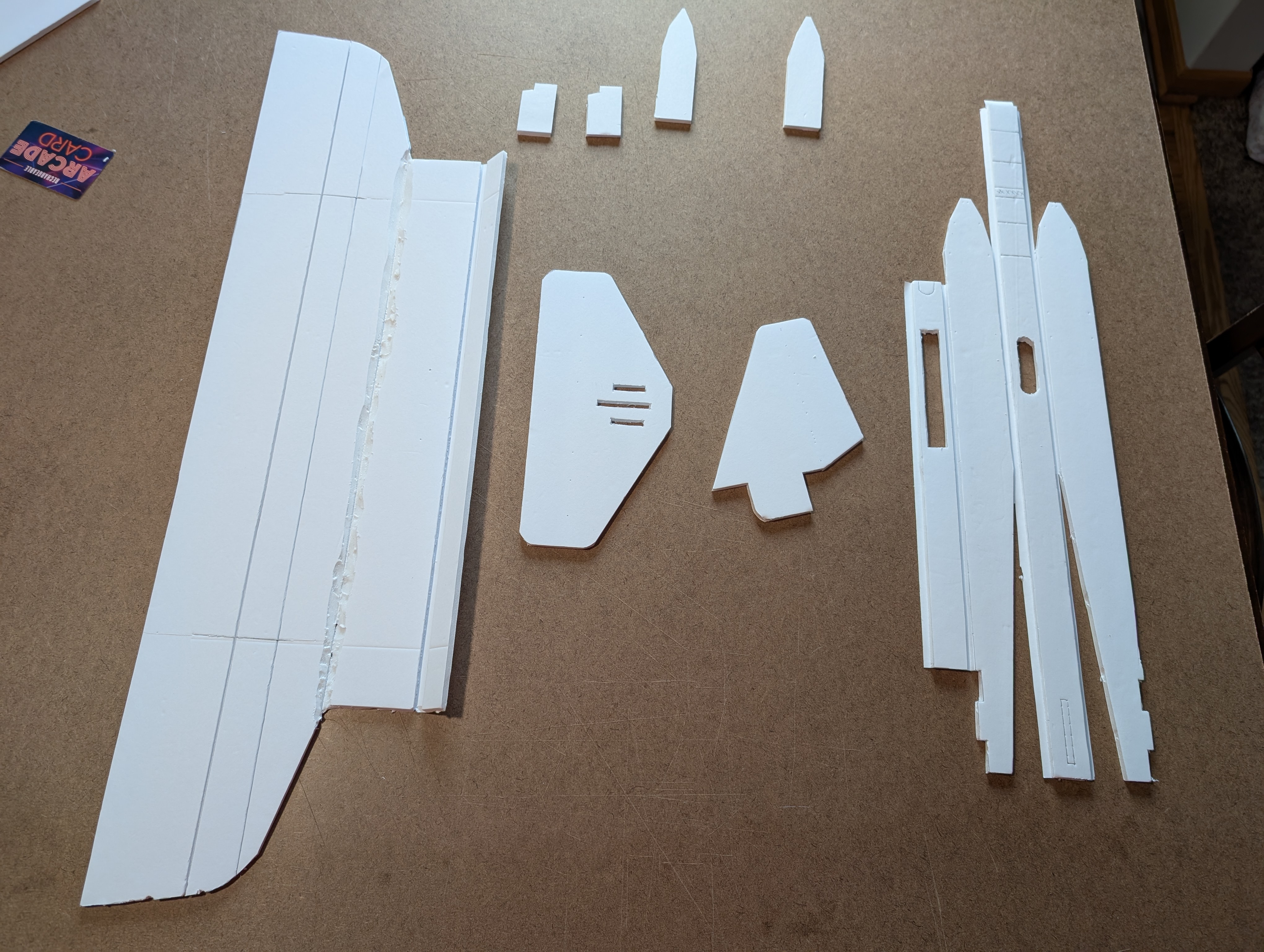

Just finished cutting out the templates and parts. It was rough... I had to cut out a a new fuselage, after making a few mistakes. Also did a horrible job on the bevel cuts. Just need practice.
Tomorrow I'll attempt to put the glider together.

Look just fine! And if you start by practicing cutting the bevels in the wings they will be hidden! (BTW sharp razors are a must when it comes to bevels!)
alan0043
Try this idea for bevel cuts. I use it all the time. Draw a parallel line 1/8" to the score cut line ( the line that makes your hinge ). This line will be for reference. Try to get your knife to follow that new line that you drew. Remember to angle back your knife. Josh does talk about cutting bevel cuts in some of his videos. If the cut line looks wavy, get a sanding block and do some touch up. I hope this makes sense. You can always use tape to repair your hinge on the other side of what you cut. :)

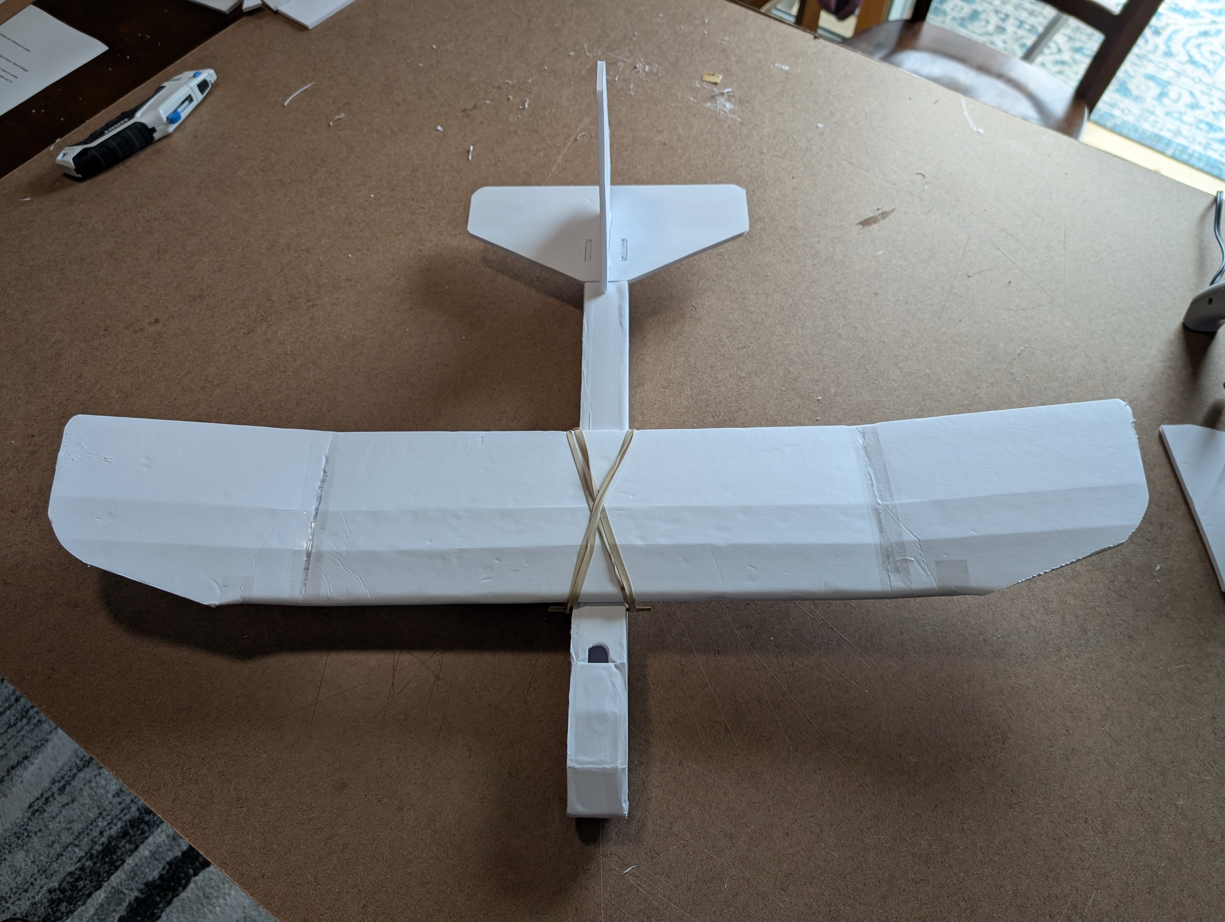

I ended up cutting out a new wing. I didn't like the bevels, plus I figured I could use the practice. However, I've got the glider finished!!!
It's not perfect, but it's okay. I tossed around with my son for a few minutes and was happy overall. It may never fly much, but I learned a few things about making Flitetest models. I know my first Scout may not be perfect either. Just hope it turns out to be flyable.
I will try drawing the line next time. I have some scrap foam I'll use for practice. However, what really helped was angling the blade back! I still had wavy lines but since they were inside the wing, I didn't worry about it this time. I'll pay more attention when I cut the exposed bevels on the Scout.
