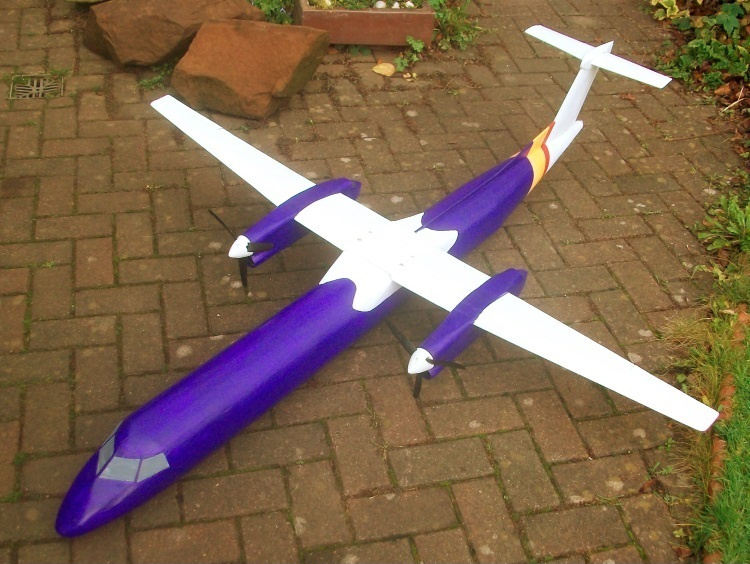

I am still convinced 3mm paperless foam sheet is a wonderful construction material. Not really "whack em together" stuff but it can result in a remarkably low final weight of even a true scale airliner.
All built using 3mm sheet Depron with no carbon anywhere. Just a bit of hard balsa for centre section of the wing spar. The wing is removable held on by 4 nylon bolts. A motor, ESC and LiPo in each nacelle. The Rx is in the wing so once it is on only the elevator and rudder servos to connect to get it ready to fly.
Wow, nice plane!
