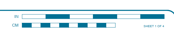

I just had a couple of the plans printed at a print shop here on big paper 36" x 48" paper but the plans on the paper say a certain size, example half of the wing is on the plan and says it is 28" but it isn't actually 28" on the paper. I used to build the plane right on top of the plan on kits I used to buy. I know this isn't a kit but was hoping to be able to lay the wood on top of the plan and build the wing, but it won't be the right size. How do I get these p,ans to print out actual size? Anyone know?

If they were FliteTest plans they all have an inch and metric scale in one corner. Let your print shop know you want them printed at the actual size of the document not scaled to the paper and then check them with a ruler or tape when you pick them up.
