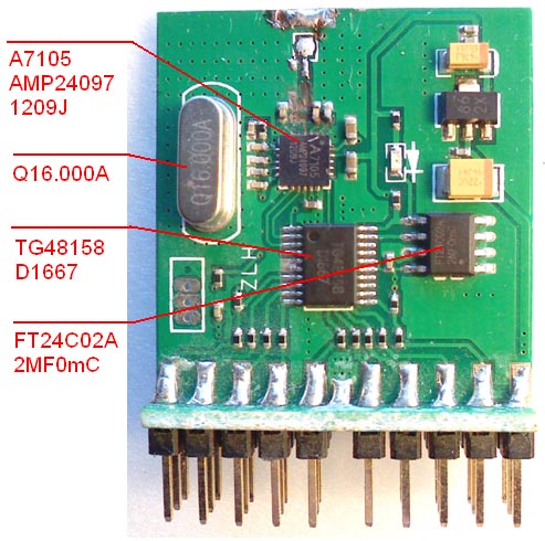

1. Check if there is a short circuit between the center wire and the ground shield at the output of the transmitter antenna. 2. Is everything okay?We need a working receiver to install on the model and check the range. I think you haven't soldered the antennas well. And as a result, the microcircuit on the receiver burned out. A very moody little square chip. I changed it for myself and my model friends. It burns out from static electricity. Have you soldered an antenna with a soldering iron ground on the receiver? Photos of soldering nodes ? Check the receiver for a short circuit of the antenna, too. There is a place on the receiver board to install Schottke diodes, but for some reason the Chinese do not install them. These diodes save the microcircuit from static breakdown.When I changed the microcircuit, I put Schottke diodes. I wonder how much it will cost to send your recipient's mail to Russia. It's probably easier and cheaper to buy a new one.

My first transmitter is a Hobby king 6v2. Then they gave me a Turnigy 9x, and I bought a cheap Turnigy 9xr with a 900 MHz module. All receivers are suitable for these transmitters. I have 8 receivers. I repaired 5 receivers with a replacement chip. Experience of use - 20 years. Turnigy replaced the microchips in the transmitters with more powerful ones. I flashed them to the latest firmware version with ELRS support. You asked for advice, and I gave it to you. The chip is sold on Aliexpress, inexpensive, for 5 pieces. Or ask someone for a Hobby king 6v2 or Turnigy 9x receiver.,I'm not interested in this topic anymore. I shared my experience of ownership and renovation. Goodbye.
