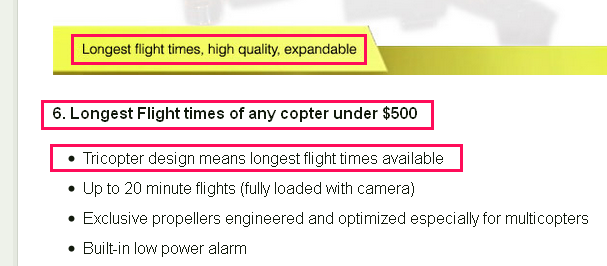

I followed and contributed to the rcgroups thread on this copter from day one. For about a week it looked like they may have had something. But very soon indicators started popping up something was amiss from the guys heading this project. The first was the dishonest aerial footage claiming it was from the PD. It was quickly pointed out that not only was it from a quad (a shadow is seem in a shot), but the quad was using a gimbal as well. Then they ran a video showing the PD had a 20 minute flight time, but did not mention strapping on an extra large battery that was made obvious from freeze framing the video. And claiming it was going to be "revolutionary", when it was also pointed out the PD used ordinary cheap Turnigy motors. And so on, if you read the thread, you'll see roughly half a dozen other indicators it was going to be a mess.
But bottom line, I feel for everyone who got pulled into this train wreck.

Yeh I bet they had fun with it on rcgroups:D I never really go there too much other then to get some great reference information. Looking back now I can't say how much of the hype I really bought into but I always assume they inflated their numbers, that's just what is done these days unfortunately. I would of been happy with half the flight time regardless of all the other hype and buzz words they used. I just though a folding tricopter was cool.
