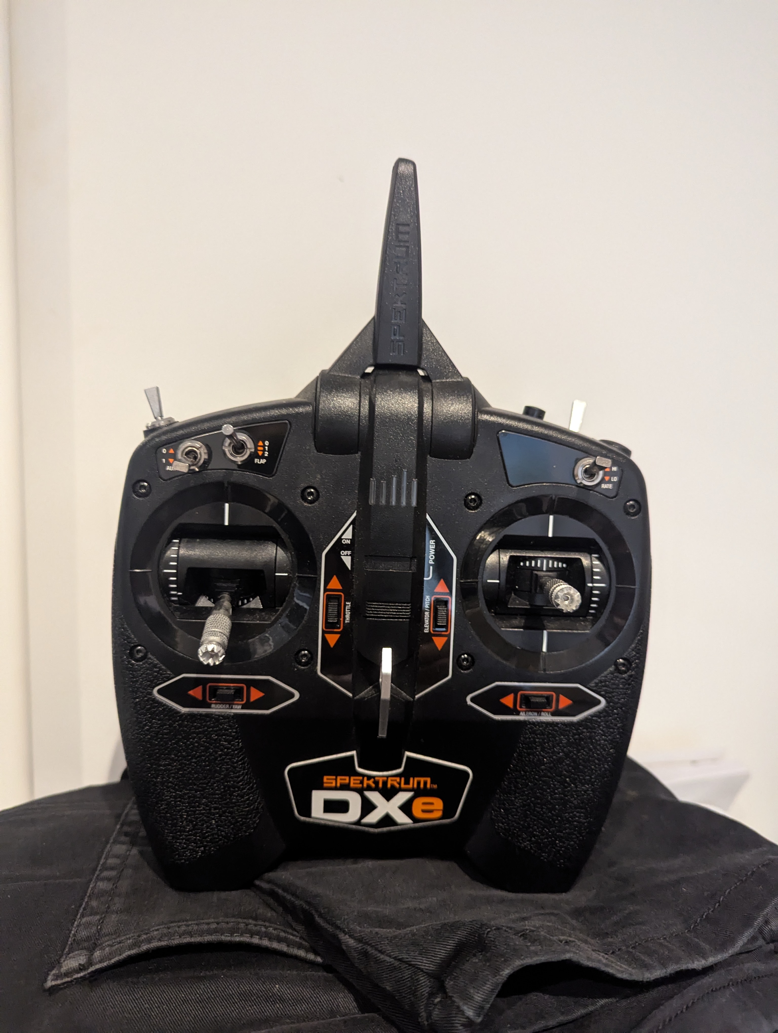

I need your help binding the transmiter DXE DSMX SPEKTROM WITH the umx F27Q EFLITE STRYKER.
Things i tried already :
lowering trhottle trim
distance between tx and rx
waiting 5 sec
I tried binding several times but it dont work
Thanks

quorneng
I assume you are using the correct binding procedure as described in the DXE manual.
1. Lower the throttle to the lowest position and make sure the transmitter is powered off.
2. Insert the bind plug into the BIND/DATA port.
3. Insert the ESC plug into the THRO port.
4. Connect the battery to ESC and turn on the ESC switch, if available. The receiver’s LED will flash rapidly when the receiver is ready to bind.
(if there is no rapid flashing the receiver will not bind)
5. While pressing the Bind button, power on the transmitter.
6. Release the Bind button after the receiver’s LED stays illuminated. This indicates the receiver is bound to the transmitter.
(If the receiver LED is not on continuously it is not bound)
7. Remove the bind plug from the receiver.
Do you know how old your Stryker is?
It is no longer available and was initially released way back in 2011. It is possible the earliest version was DSM2 which is not compatible with the DXE which is DSMX only.
I hope this helps.

The DXE is not compatible with the Spectrum™ AR6400NBL receiver.
The DXE transmitter is DSMX while the AR6400NBL is DSM2.
Many Spectrum transmitters support both DSM2 and DSMX but the DXE only supports DSMX.
You need to swap the receiver for a DSMX receiver or use a different transmitter that supports DSM2.
