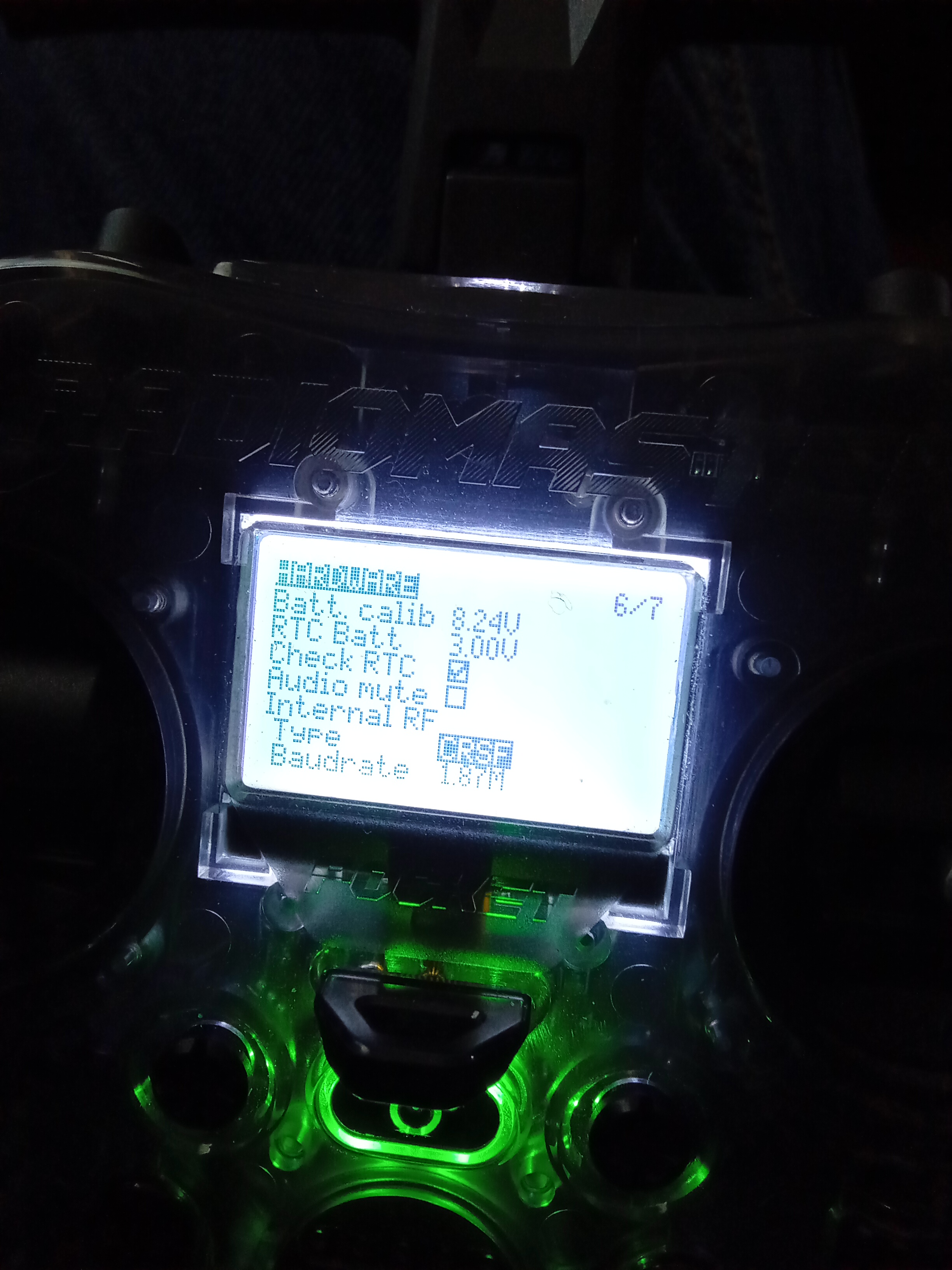

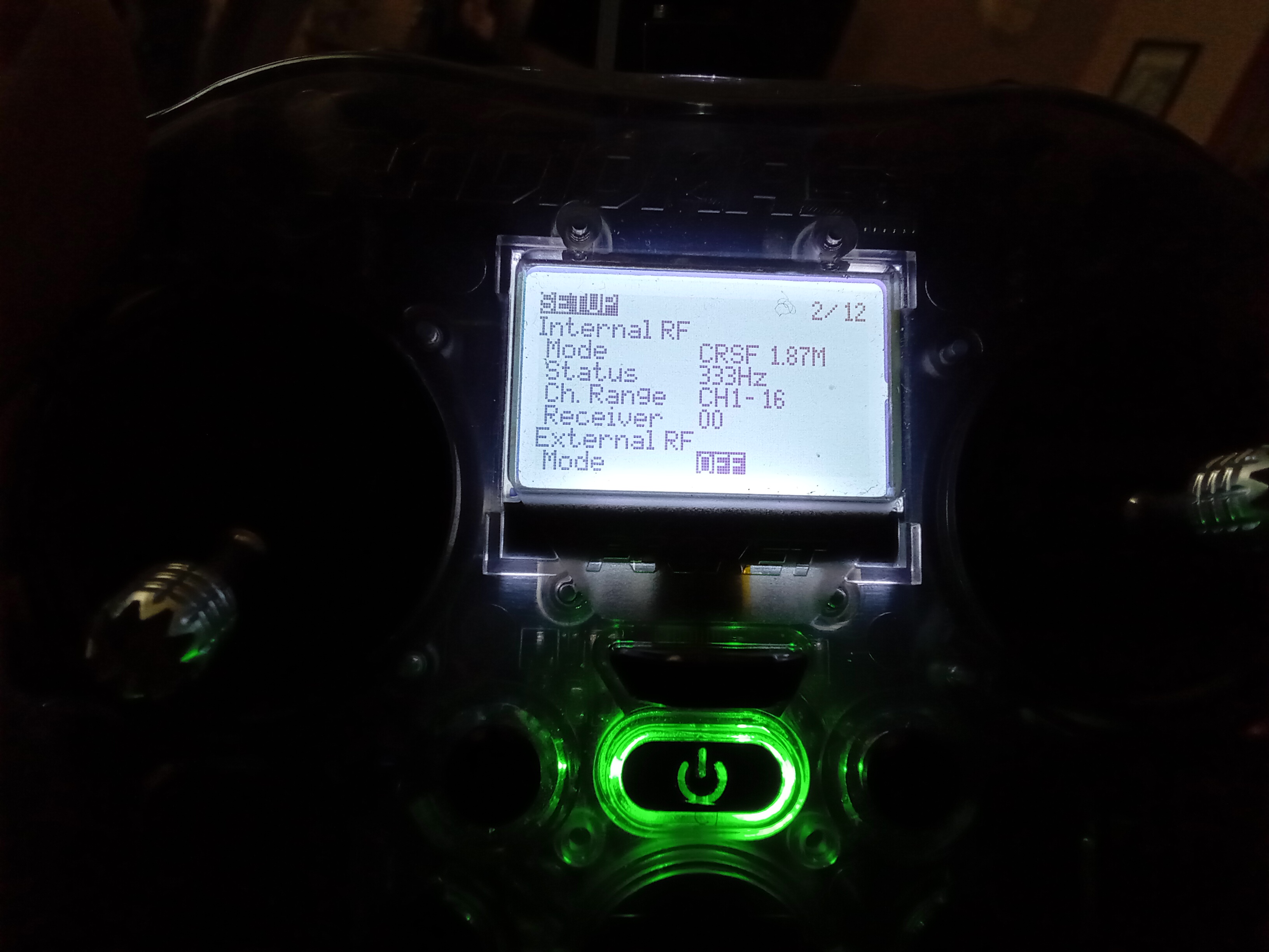

There is a configuraton option in the system settings "HARDWARE" tab which must be set Identifying what type of module is internal. My pocket radio is ELRS for example. This is how it should be set. CRSF is correct because Crossfire is the protocol that ELRS uses.
LB
Even when configuring a model the protocol is CRSF for ELRS

Hi LitterBug, thanks for your help.
I have a couple of questions. My transmitter is 915 MHz.
Do I need to adjust this?
In the case of the baud rate, I see that your transmitter is 1.87 MHz. ELRS uses 420,000 bauds. Is this related? Do I need to change anything?
Thanks for your help.
900 mhz is the over the air frequency. You just need to make sure your receivers are the same frequency. Leave the default baud rate of 1.87 Mhz for the protocol unless you run into issues.
