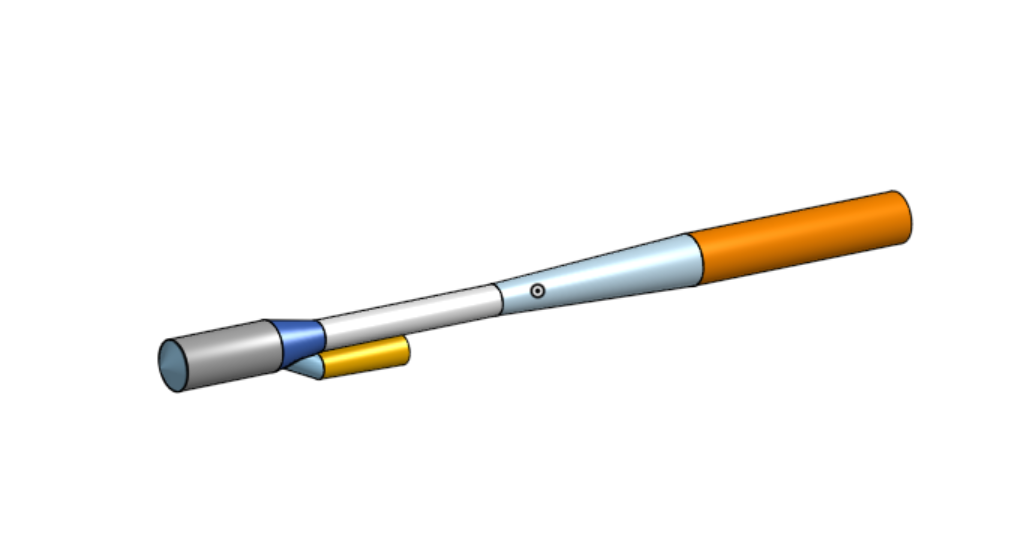

Got the new one designed from that drawing. Also watched some YouTube on bending metal into cones. I am hoping to get all parts cut out today and maybe start ending but well see hw that goes. I only have access to a stick welder currently so I may have t wait on that too. Any advice on bending/welding sheet metal would be appreciated!

Bricks
Years ago replacing car panels we would use lead and acetylene torch not sure if the melting point is high enough at 621 F. Welding even with a wire feed metal that thin is a trick, takes practice and a properly set up wire feed welder, don`t think rosin core wire feed welder will do it

@Patriot Rc (My brother) has done a good bit of welding! You got any tips or ideas patriot?
Patriot Rc
Here is a link to a tig welder thats a pretty good price (seems to have some good reviews).

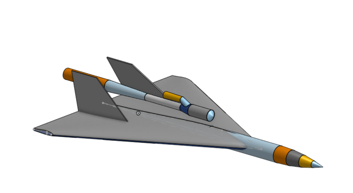

Just did the final rough draft with the new engine and I think I'm going to stick with this design. Should be going to make the engine soon not sure when exactly tho. Let me know what you think I'll probably start refining it tonight.

telnar1236
What airfoil are you using? For flying wings and deltas you want something with reflex or symmetrical since cambered flat bottomed airfoils produce a nose down pitching moment generally
