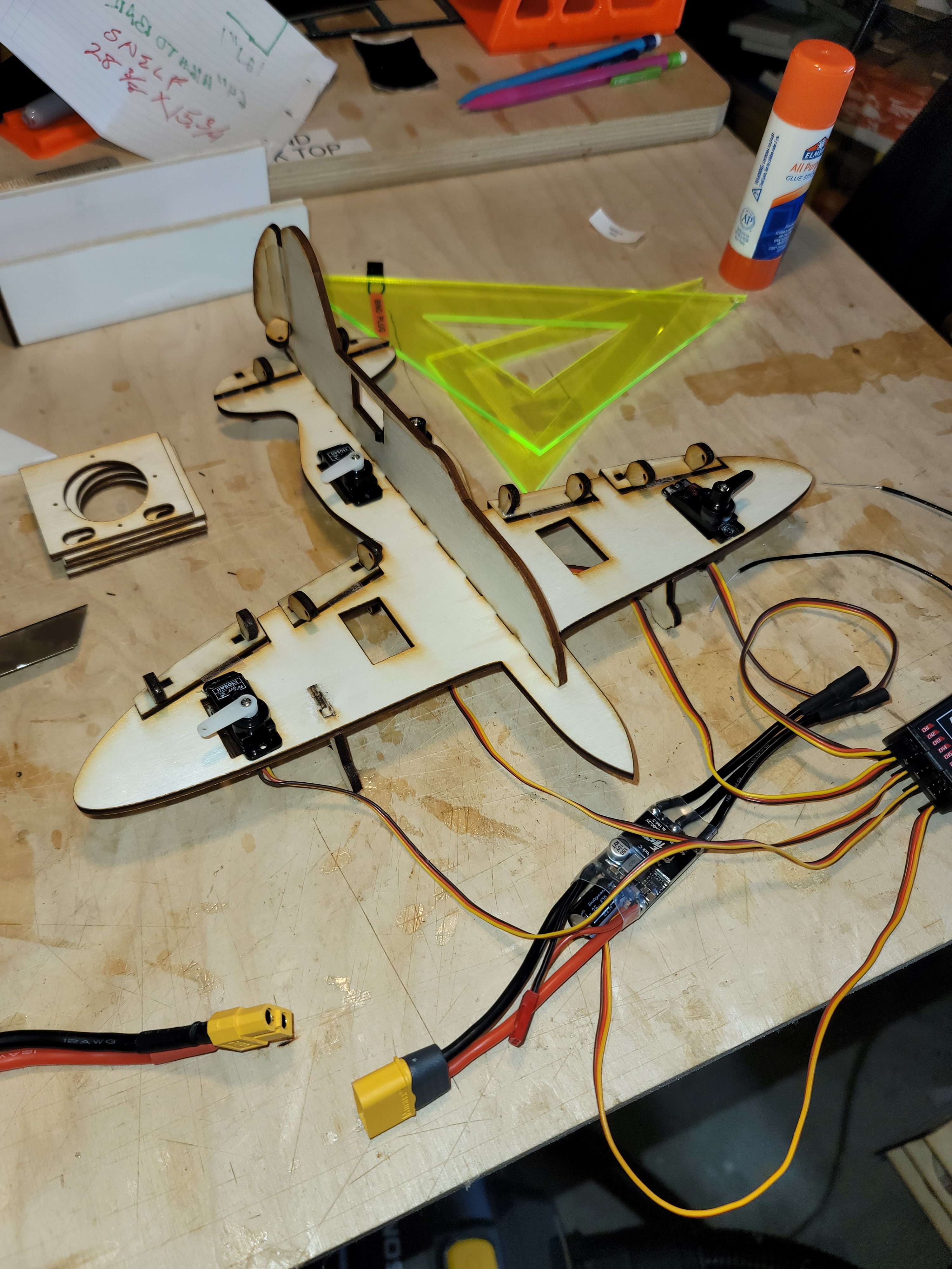

Any time I am dealing with a wing span of more than 30 inches, it can get cluttered trying to fiddle with the radio, gyro (if used), and servos, so today I did something to make that easier.
There is an overabundance of control horns, as I want to be able to simulate any number of airplane setups.
There will still be fine-tuning to be done on the actual model, but this will serve me well for getting the servos all running in the right direction, etc.
I cut the hinges from a heat press document holder and ironed them down.
