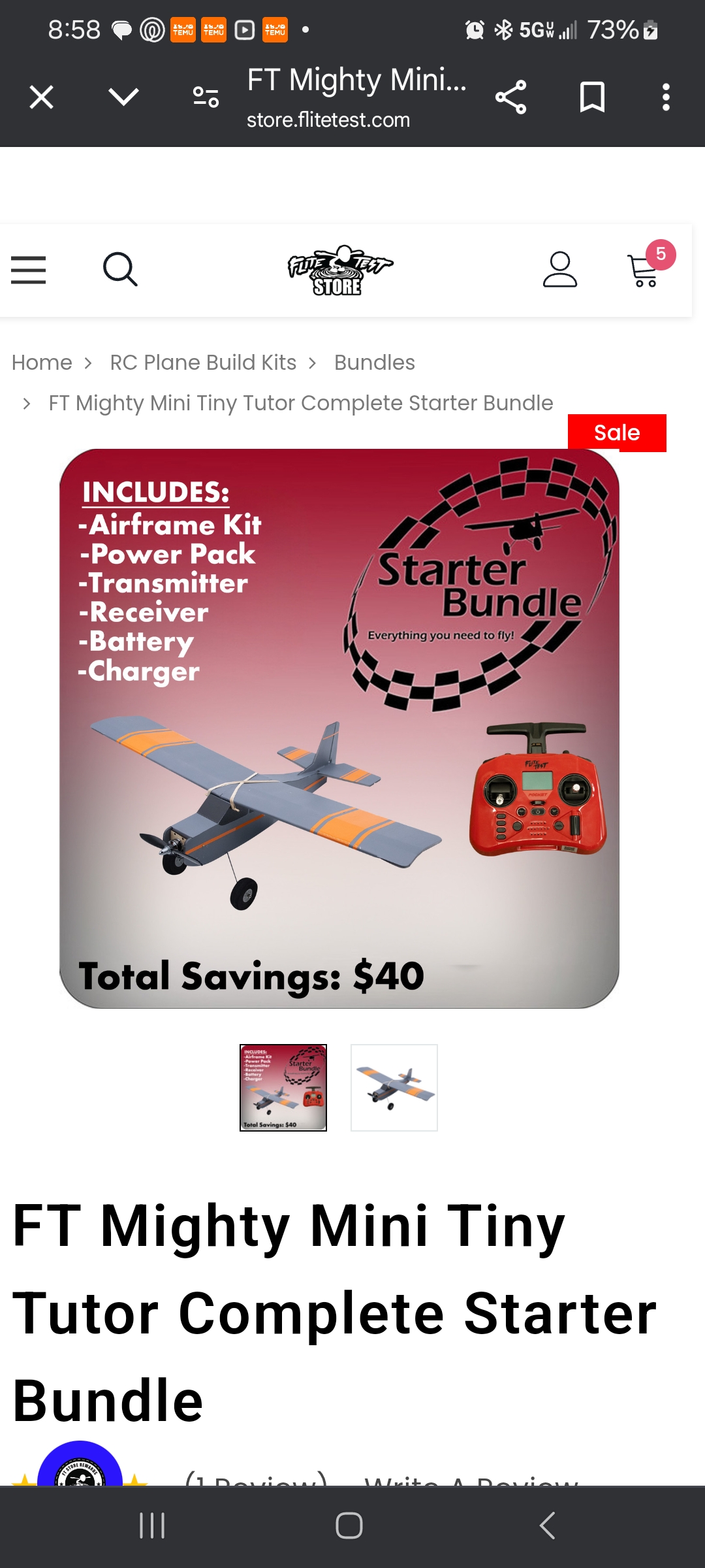

I was hoping to not have to wiring the RX to the Aura Lite. Does either RX work with the pocket TX that comes in the value bundle? Or will I have to get a different one?
Which TX comes with that bundle? Can you post a link to the bundle? The DSMX RX would be plug and play, but we need to make sure the TX is compatible before you pick that one.
Branded Pocket CC2500 and a R84 receiver.
You will need the R81. The CC2500 is not DSMX compatible. You should be able to solder a 3-wire plug to the RX to plug it in to the Aura5
