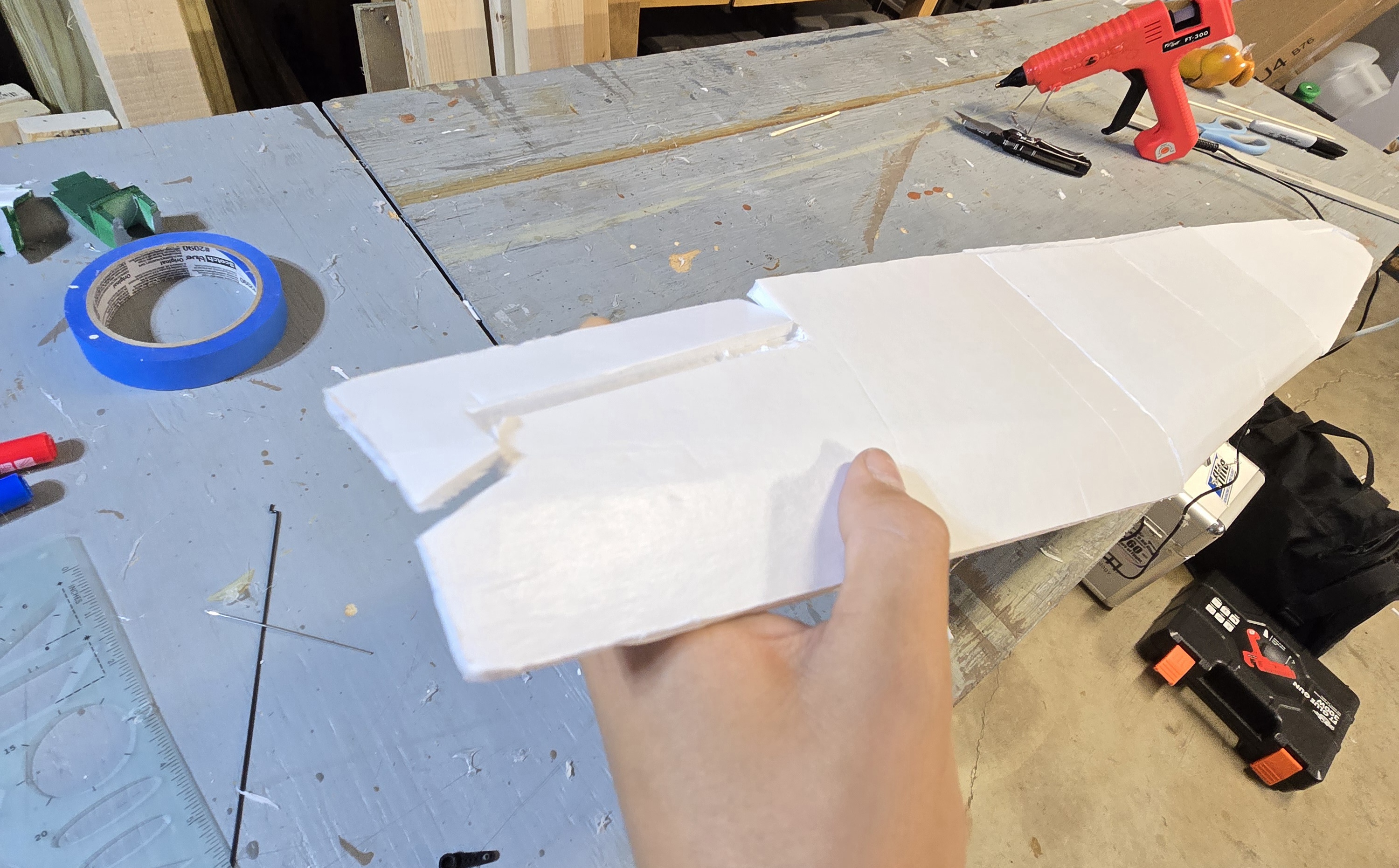

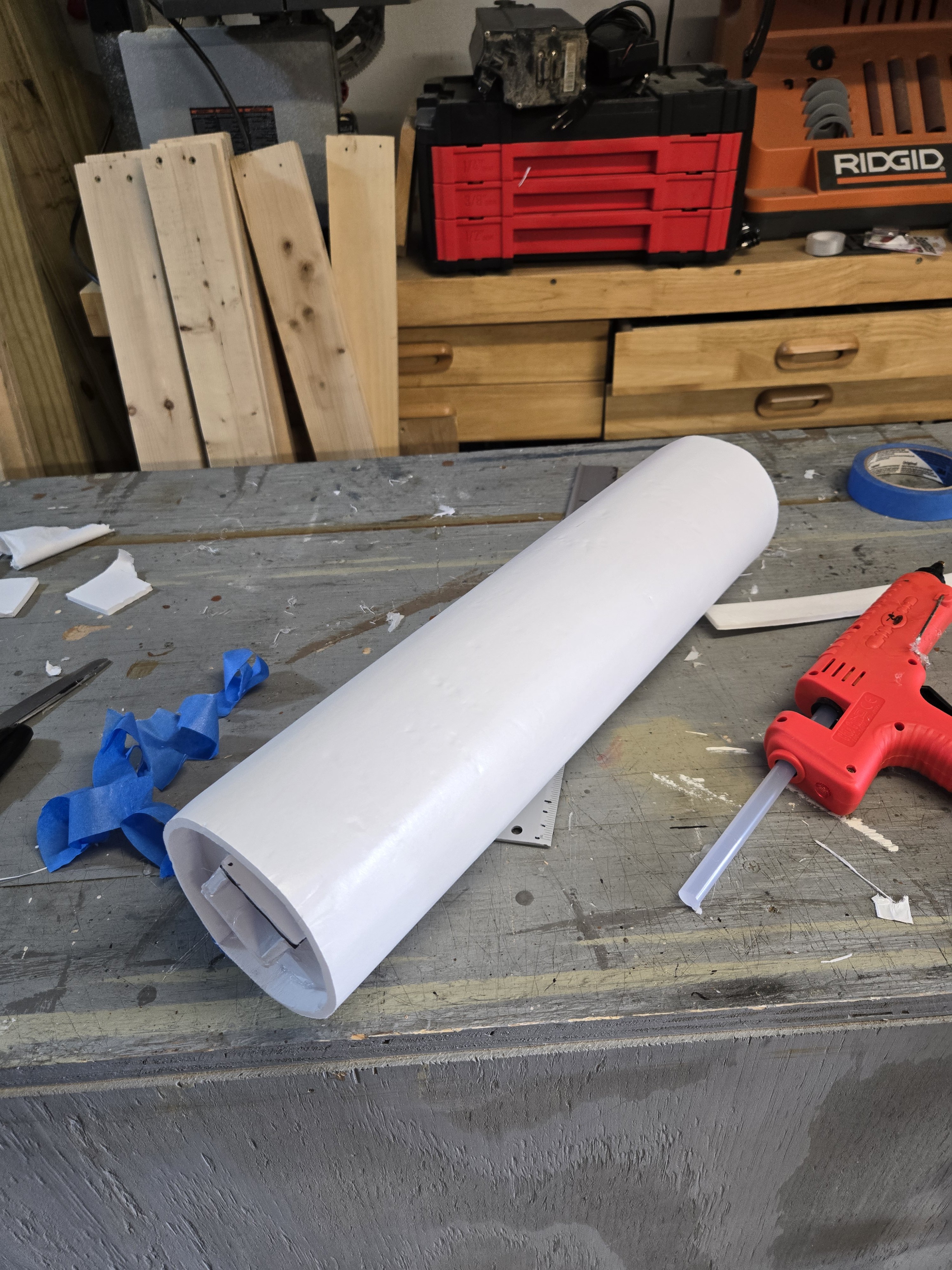

Help! My fuselage is giving me trouble, I tried covering it with a warped piece of foamboard, it did not fit well. then I tried to cover it with poster board, that worked but I'm skeptical. I am about to score multiple pieces to make a circle. Anyone have any advice??

Peel the backside of the paper off the foamboard, then it’ll bend easily. (Perhaps watch a Flite test master series build vid)
