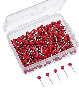

Are you talking "red map pins" like these?
Flying Monkey fab
I know the ones you are talking about and my googling seems to say they are a European thing. T headed pins are common though and can be picked up at any sewing shop.

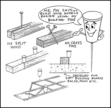

I started using scrap balsa to pin down as a clamp rather than pinning through the actual airplane part. Either that or angling the pins so they hold the part down without pinning through it, like in this drawing I found.

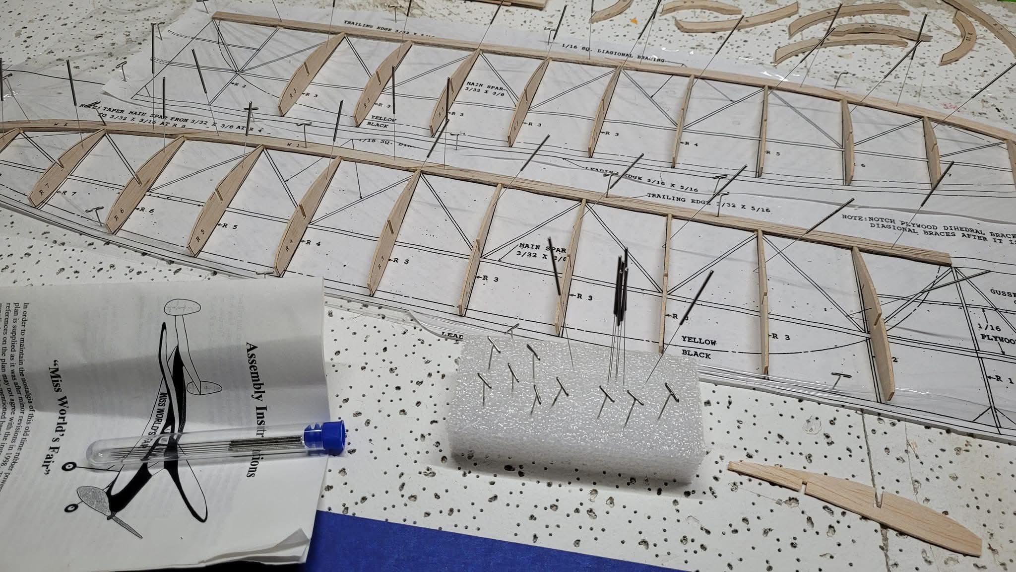

I never thought I'd use the words "ACUPUNCTURE " and "Model Airplanes" in the same sentence, but I'm loving these pins! Oh yeah, that's right, we probably shouldn't call them acupuncture pins, since they're actually "3D printer nozzle cleaning pins" 😉. Very cheap on Amazon. Tee pins have their use, but these are so thin you can thrust right through small balsa sticks without splitting.
