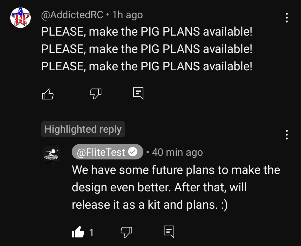

Now that pigs have flown, they have no excuses for not having releasing the plans.
