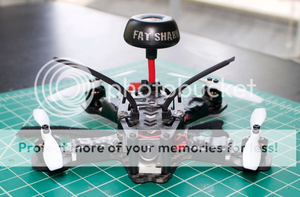

Awesome looks as great as it flies. Isn't it crazy how fast you feel like your going with that super wide angle lens? At least that's how I feel with the blade 150 build I just finished with the same camera.

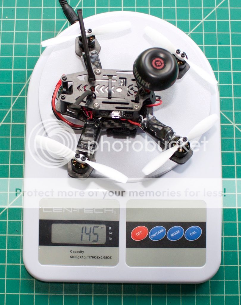

Hmm, that's when I've been landing mine as well. My build did come out about 15 grams lighter than yours, didn't think that would be enough to account for an extra minute of flight time, but what do I know?
That's probably the difference, or at least most of it. 15 g may not sound like much, but it's over 10% of the AUW.

Very sweet. The really cool thing is you can bang it hard into stuff and almost certainly have no damage.
But the really unique aspect is, if you crash into foliage, it has a very likely chance of making it to the ground. And if it IS caught, it's much easier to shake or disturb the branches to shake it out.
