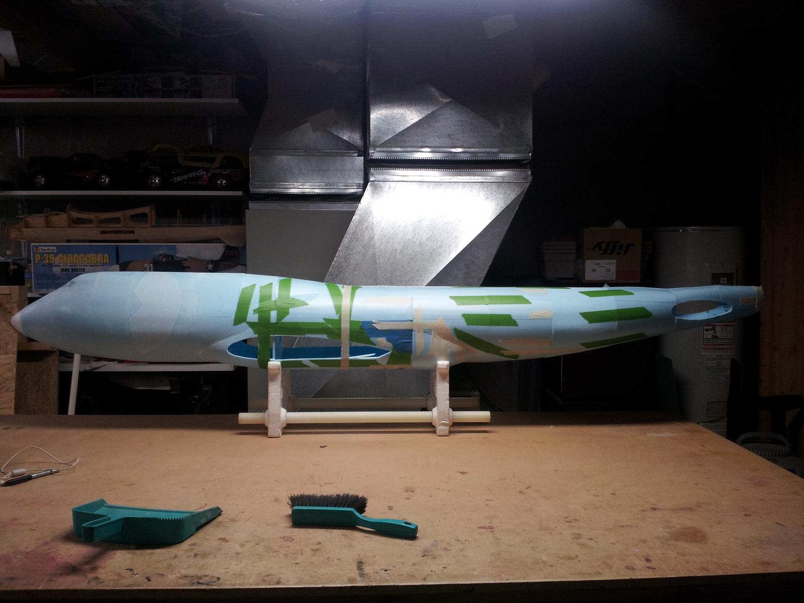

HodgeHound Mercenary
This is just the prototype, so I'll probably use an e-flite power 10 outrunner and a 11 or 12 inch prop mounted on the back end. I'll probably load up a 3s 5,000mah lipo on the front end for ballast as much as anything else. This is really just a quick-and-dirty-let's-see-if-it-will-fly kind of build.
