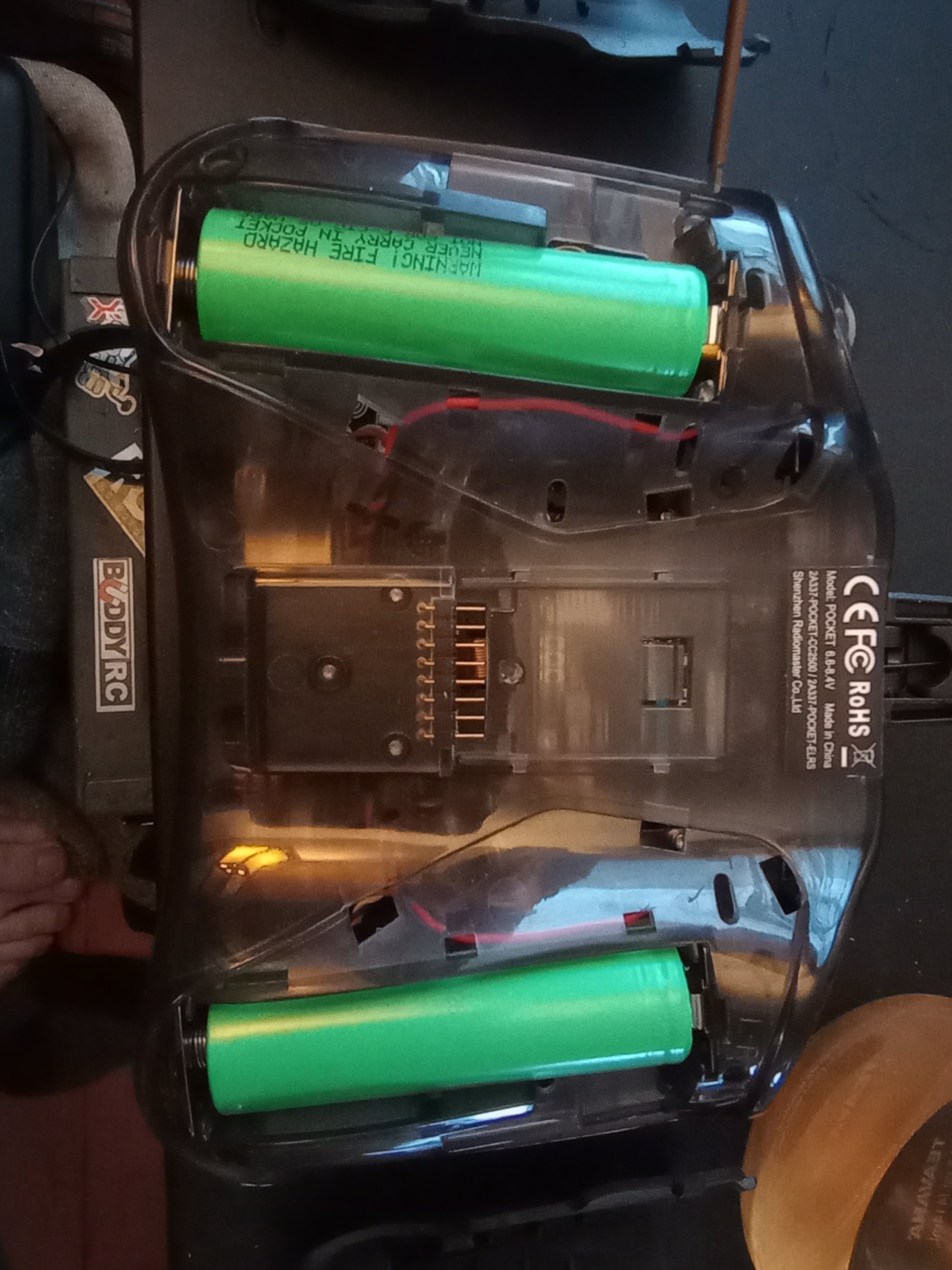

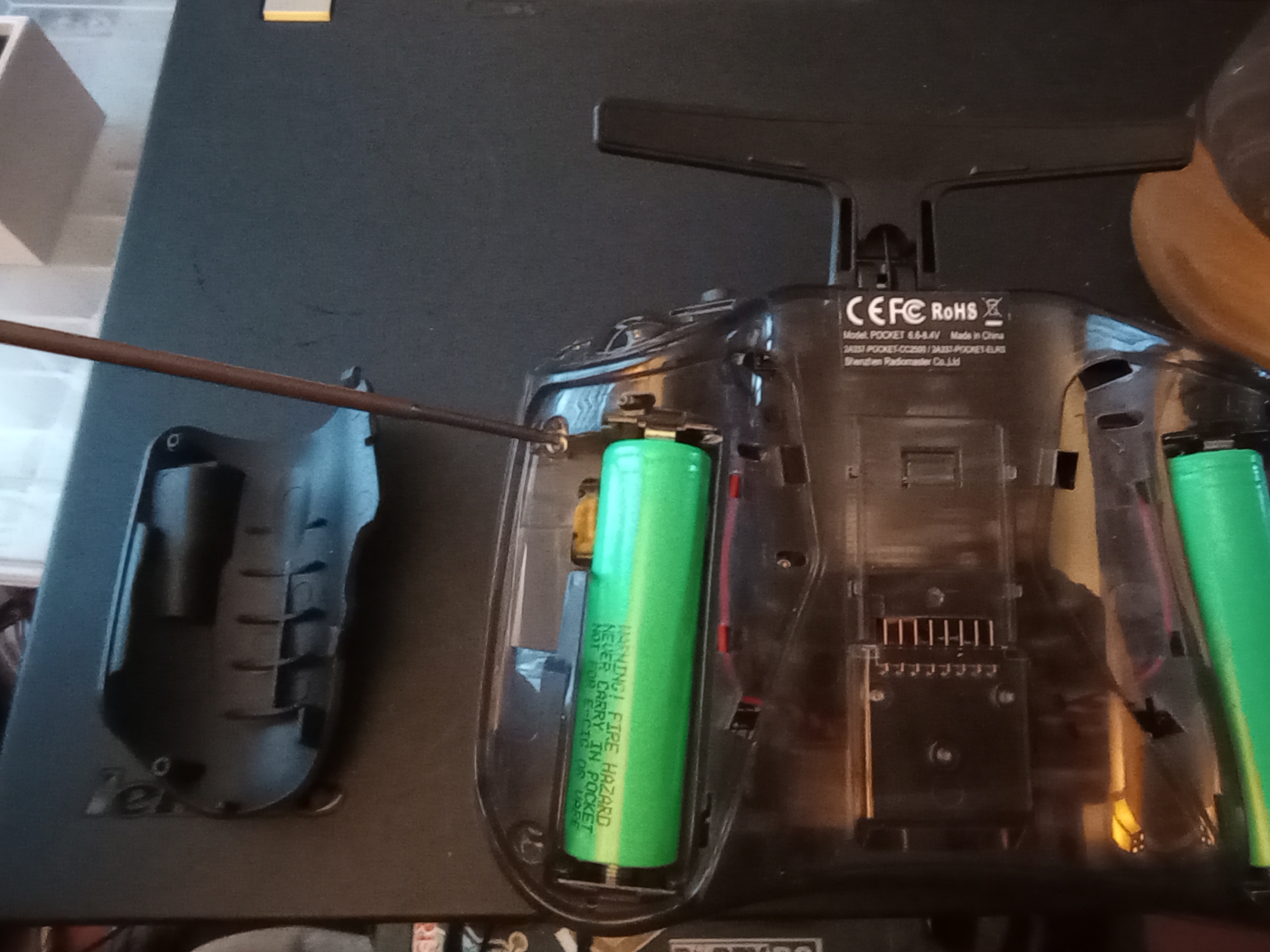

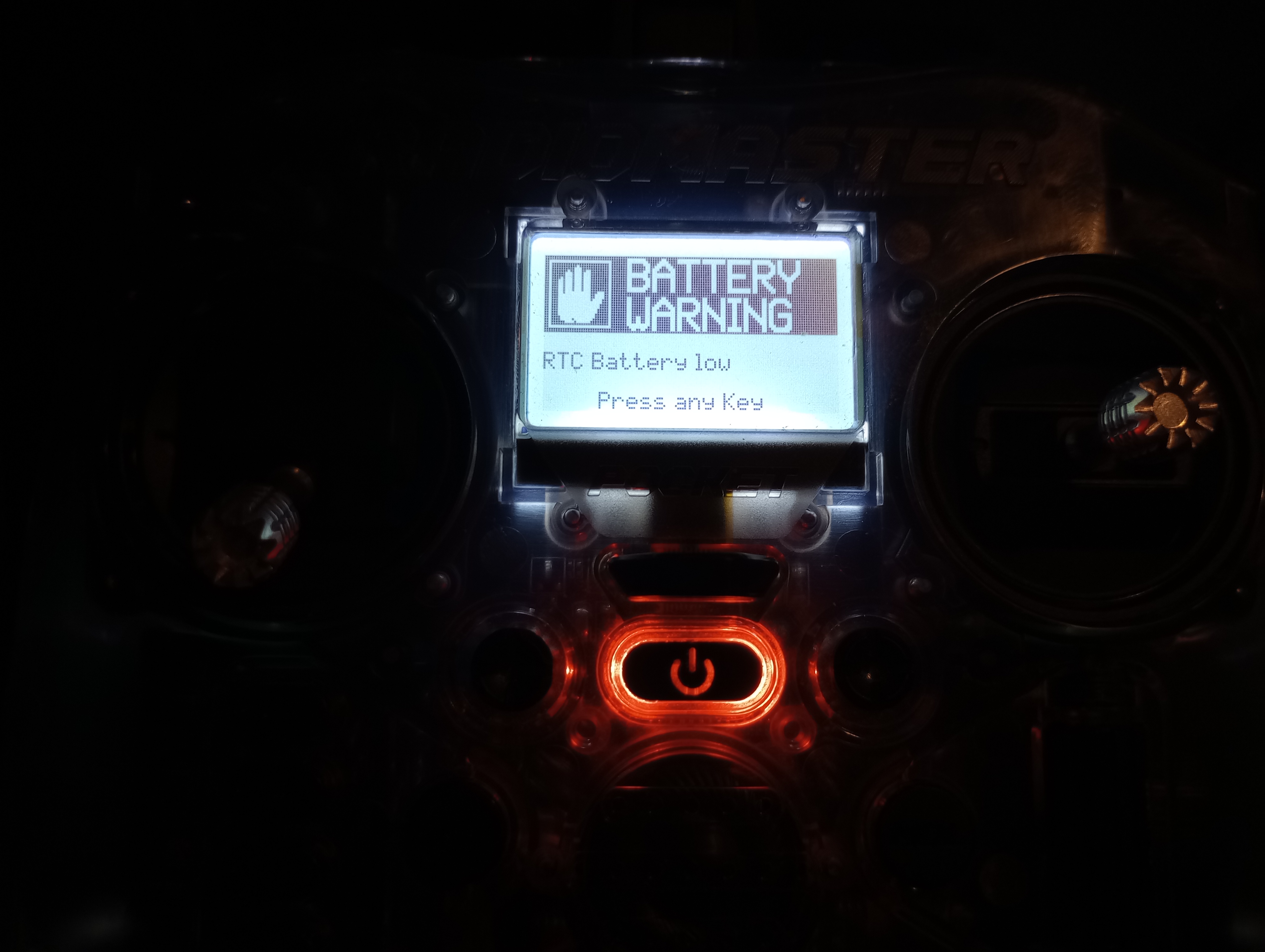

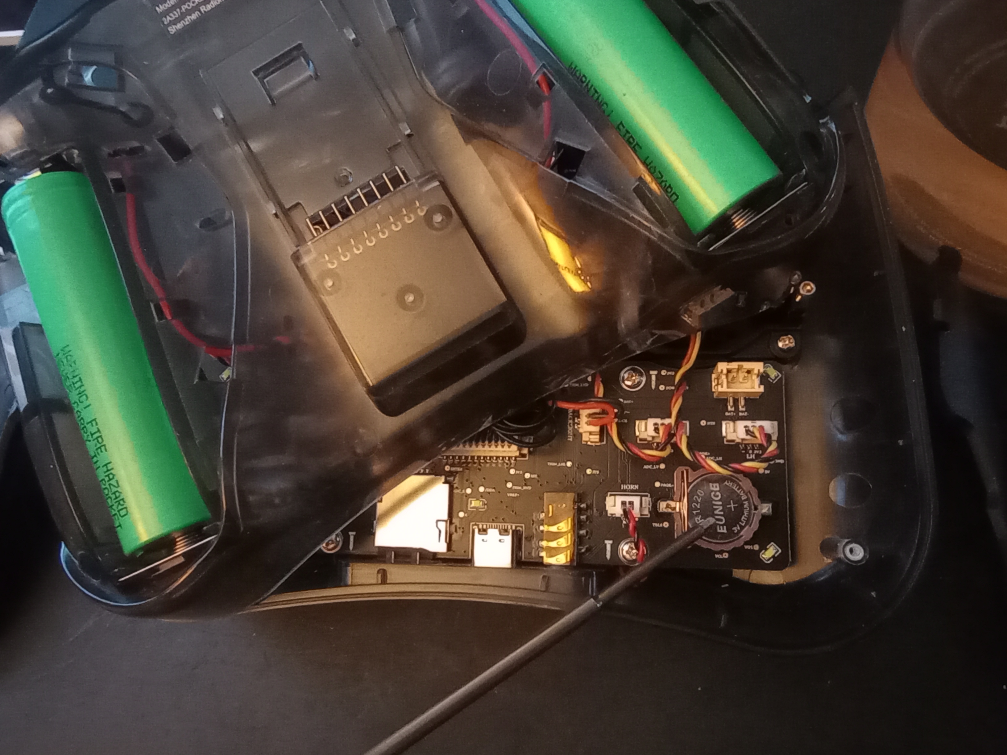

So much to my surprise, I started getting a RTC Battery Low warning at powerup recently. Checked the voltage in SYS, Hardware, RTC Batt. it was .7V (far <3V) and the time and date would not stick between poweroffs. Dove in to the case by removing the two big rubber bumpers from the back and the four silver screws in the corners hidden by the bumpers. Had a standard CR2032 lithium battery on hand, but found the battery is a CR1220. Nobody local had them, so ordered a few online. Swapped it out, reversed disassembly, and reset my clock. RTC Batt now reads 3.4 as it should with no more startup error.
