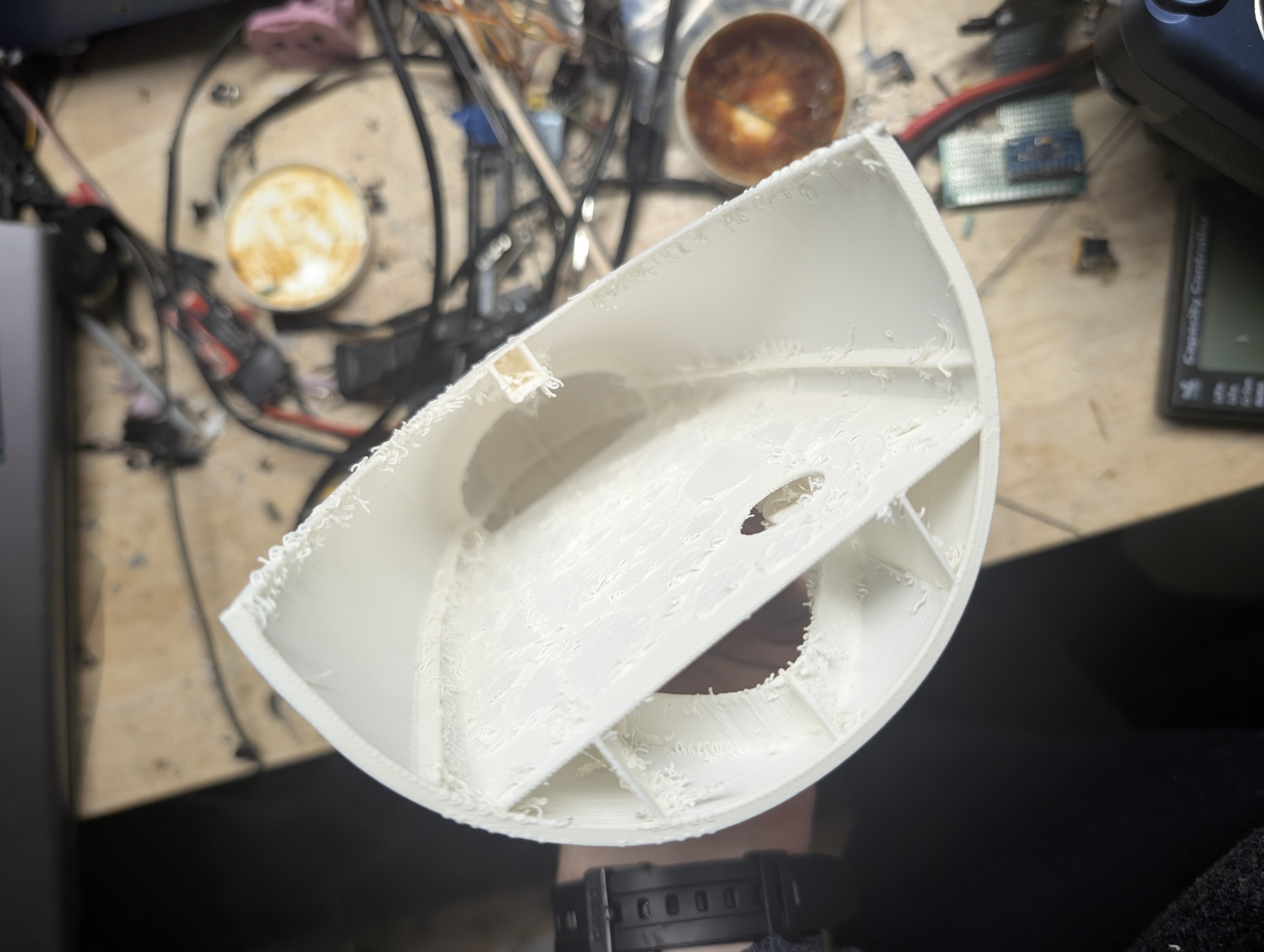

@telnar1236 I am trying to slice this and am gettign something like this. I measured the wall thickness to bee 0.12mm which I am not sure is even doable for a 0.4mm nozzle. how did you slice it? image_2025-12-01_065323012.png
telnar1236
I figured it out, you need to turn on arachne wall generator, it is mostly on but qidi default profiles keep it to classic for some reason. now it works perfectly!
Yeah, arachne wall generator and print thin walls should both be on to get the best prints - and the slicing mode should be set to regular and not even odd despite what it says in the Orca Slicer tool tips.
