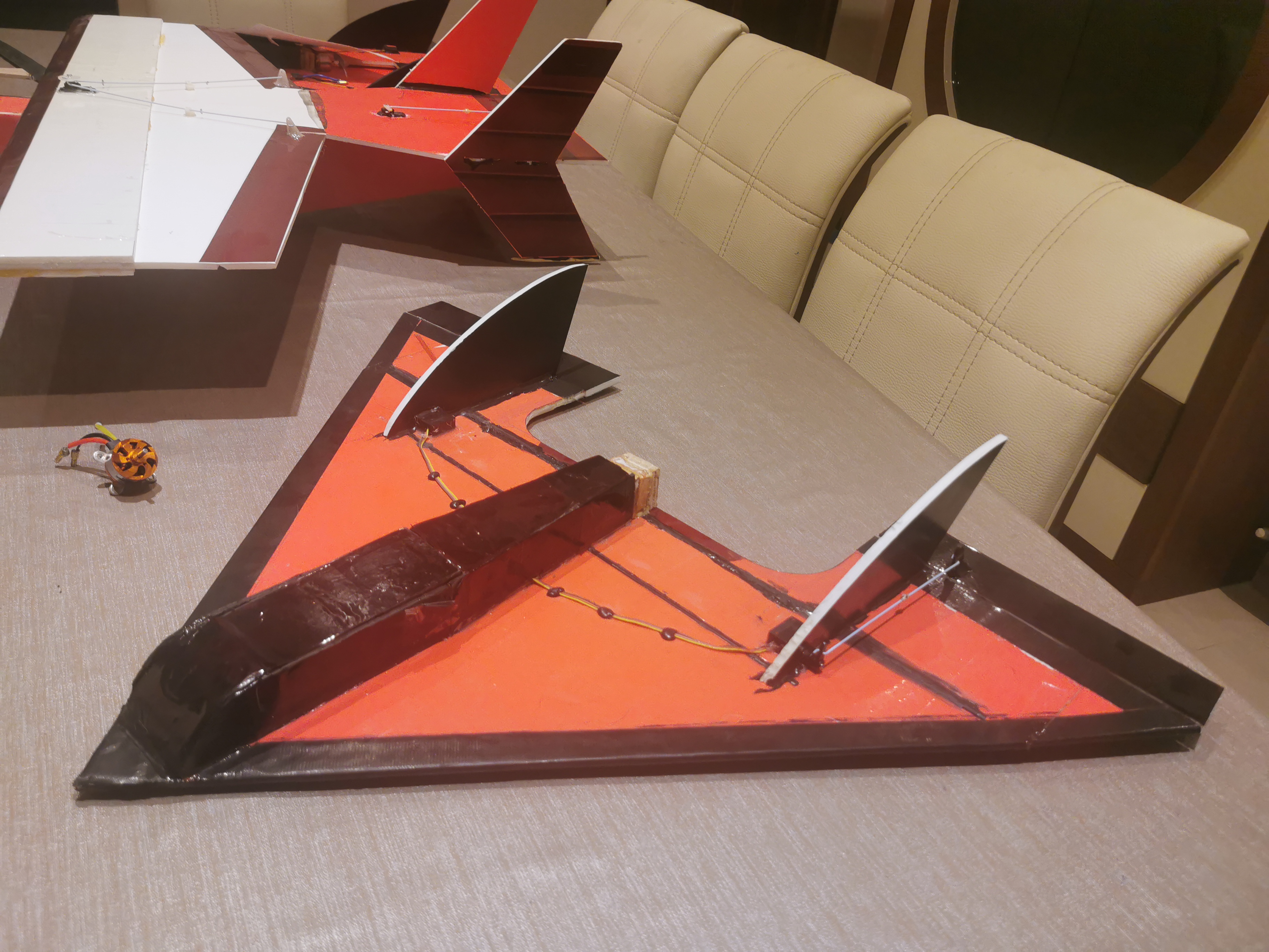

My speed wing had ultra small vertical stabilizers on the wingtips, and it was very stable…
Man I wish Flitetest can revisit this design!

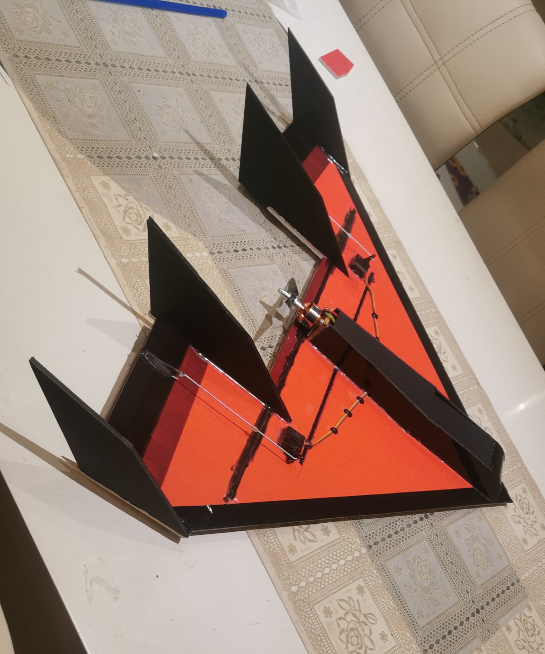

Here's my final version compared to the one I showed you earlier this year 👍
Before (initial design ):
Latest modification:

Having built a number of deltas the thing to remember using big elevon on a delta is that when operating as ailerons they are very effective but as when as elevators rather less so. This means if the surfaces have the same control deflection for both elevator and aileron mode there will be poor control harmonisation and be tricky to fly smoothly. The sharper the delta sweep the more pronounced this effect becomes.
A delta also relies heavily on the generated wing vortices to provide pitch stability however to maintain this stability the position of the CG is quite critical.
I do wonder if such a large centre cut out coupled with the airflow from the prop might effect the way the vortices are formed and thus the delta's "natural" stability.
My scale Concorde with its very sharp delta sweep, like the full size, uses inboard elevators and smaller out board ailerons to provide a better control "balance".
My remote can be tuned for different throws for each channel and yes, sometimes I need way more pitch than roll throws.
Ah... So here's me thinking that huge cutout will help reduce drag and better airflow but may cause more harm than good

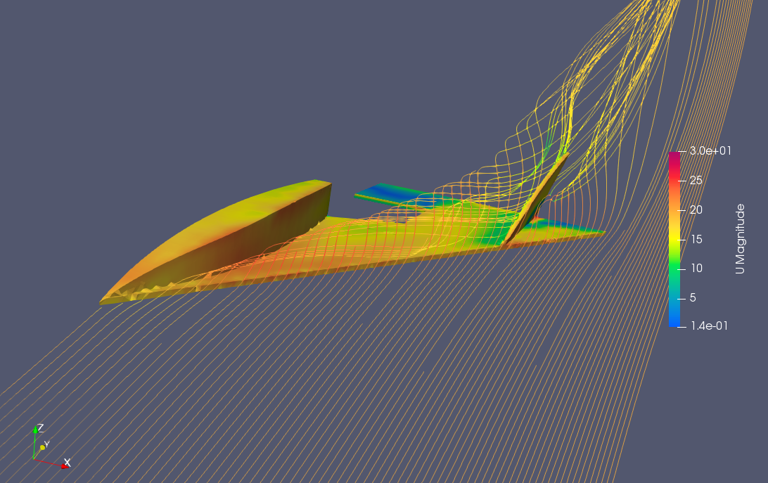

What program is that you are using there?
Simflow for the CFD and Paraview to generate the plots. There's a bit of barrier to entry to both these in terms of needing to understand CFD to set up the model and needing to understand aerodynamics to know what you're looking at. They're very capable though, and simflow is free so long as you're ok with some limits which I am ok with.
If you're interested in getting into analyzing your planes more scientifically before flying them, I'd recommend XFLR5. It's less capable (it couldn't analyze the slot on this design for example) but it's easier to use and has better documentation which also includes explanations of the relevant aerodynamic concepts

Bad news folks; Disaster!
Way out of trim and way off balance, the way it bobbed up and down like a Chinese dragon....

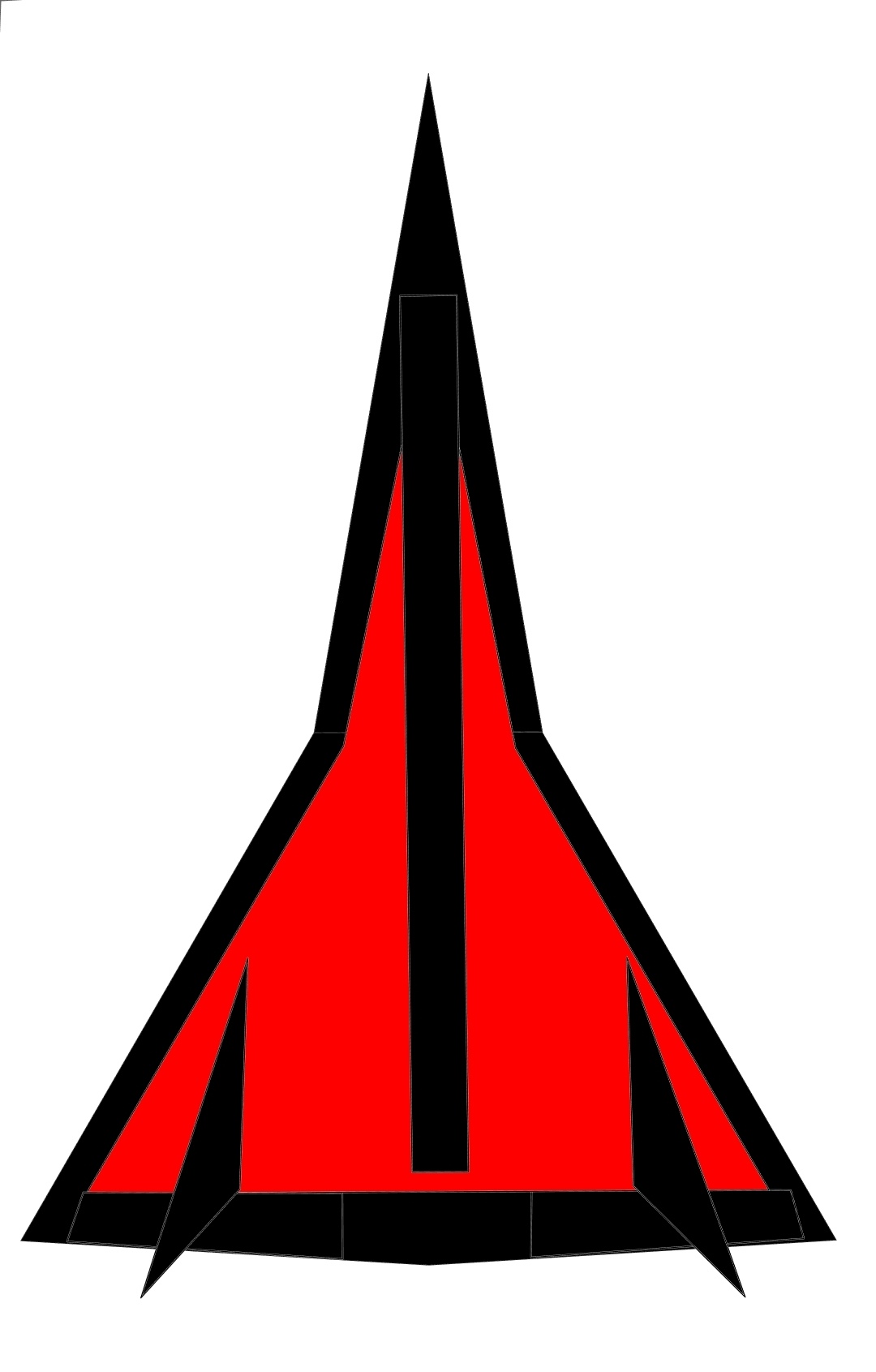

Managed to land it safely, didn't bother trying again... got too disorientated after the maiden flight. I guess there's a reason they don't use props in slots in actual planes, it almost ruins the integrity and gets really bendy around that area. Oh well... Back to the drawing board, thinking about filling the slot and extending the nose to make some kind of edf jet like so:
