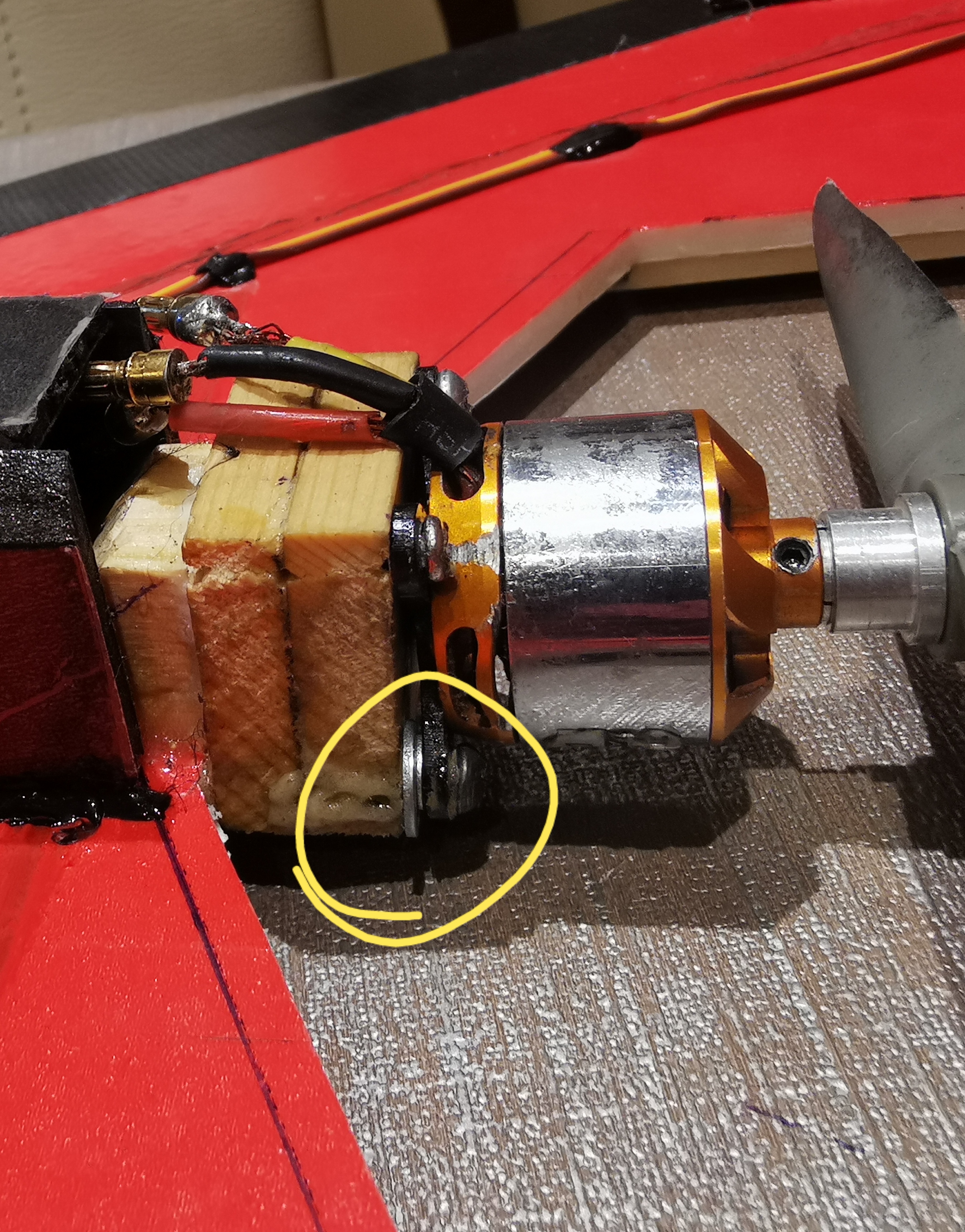

Another point that cause the dragon movement is that did you check if the motor/prop is perpendicular to the airframe in both axis? If not, use thin washers to correct.
Did you use ECalc to determine your CG as well as chucking it to see if it's close?

Way out of trim and way off balance, the way it bobbed up and down like a Chinese dragon....
Managed to land it safely, didn't bother trying again... got too disorientated after the maiden flight. I guess there's a reason they don't use props in slots in actual planes, it almost ruins the integrity and gets really bendy around that area. Oh well... Back to the drawing board, thinking about filling the slot and extending the nose to make some kind of edf jet like so:

P.S. The vertical tilt of the engine is zero degrees on all wings.

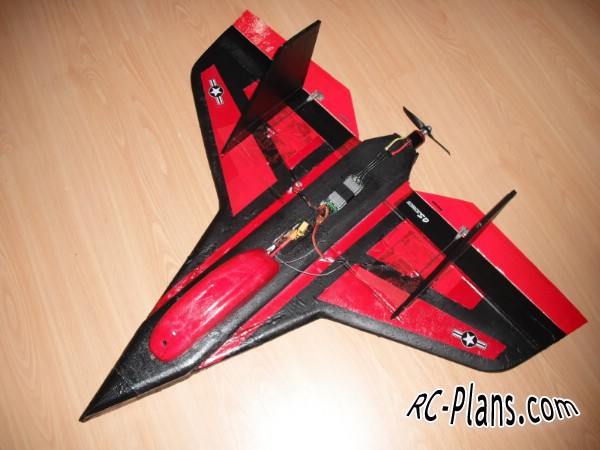

Yes these are the same links on
rc-plans.com and here's proof of what I got from there:
