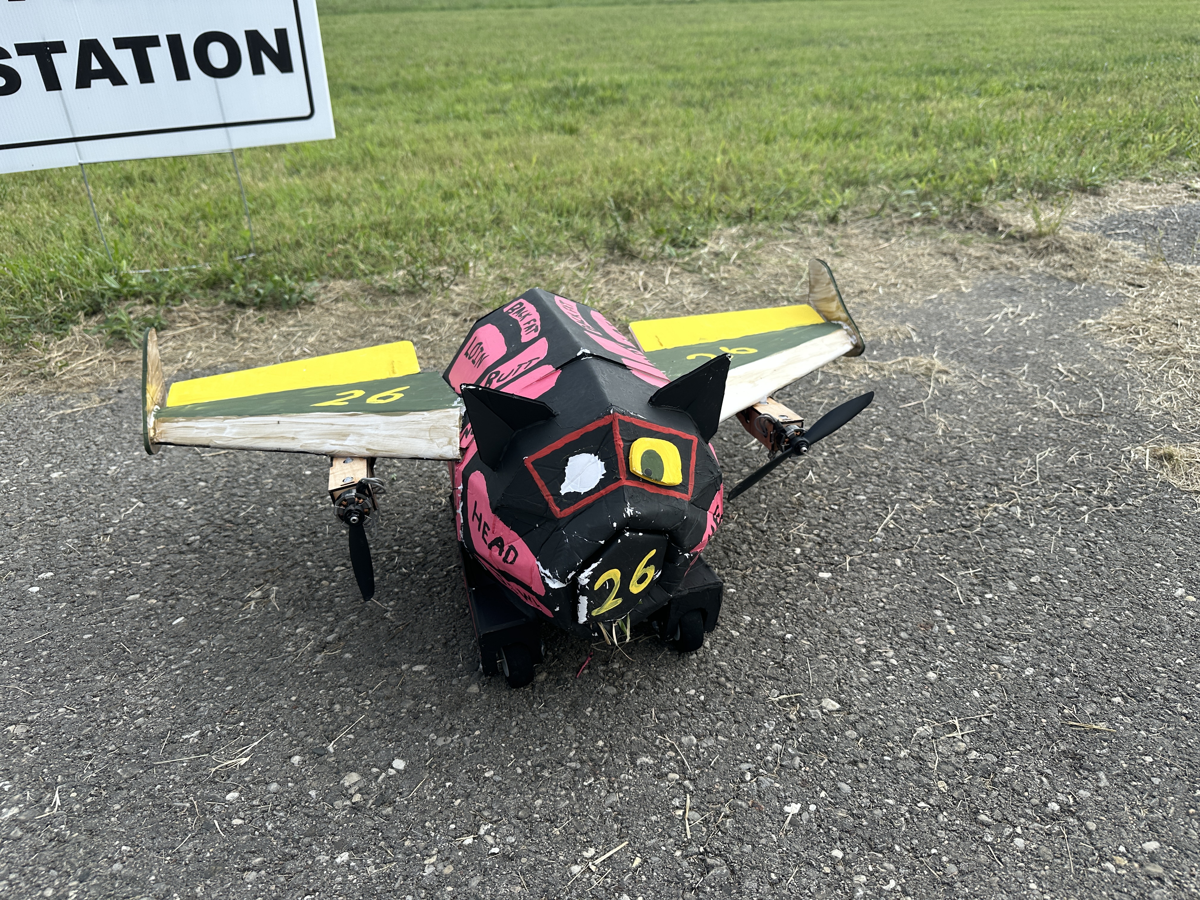

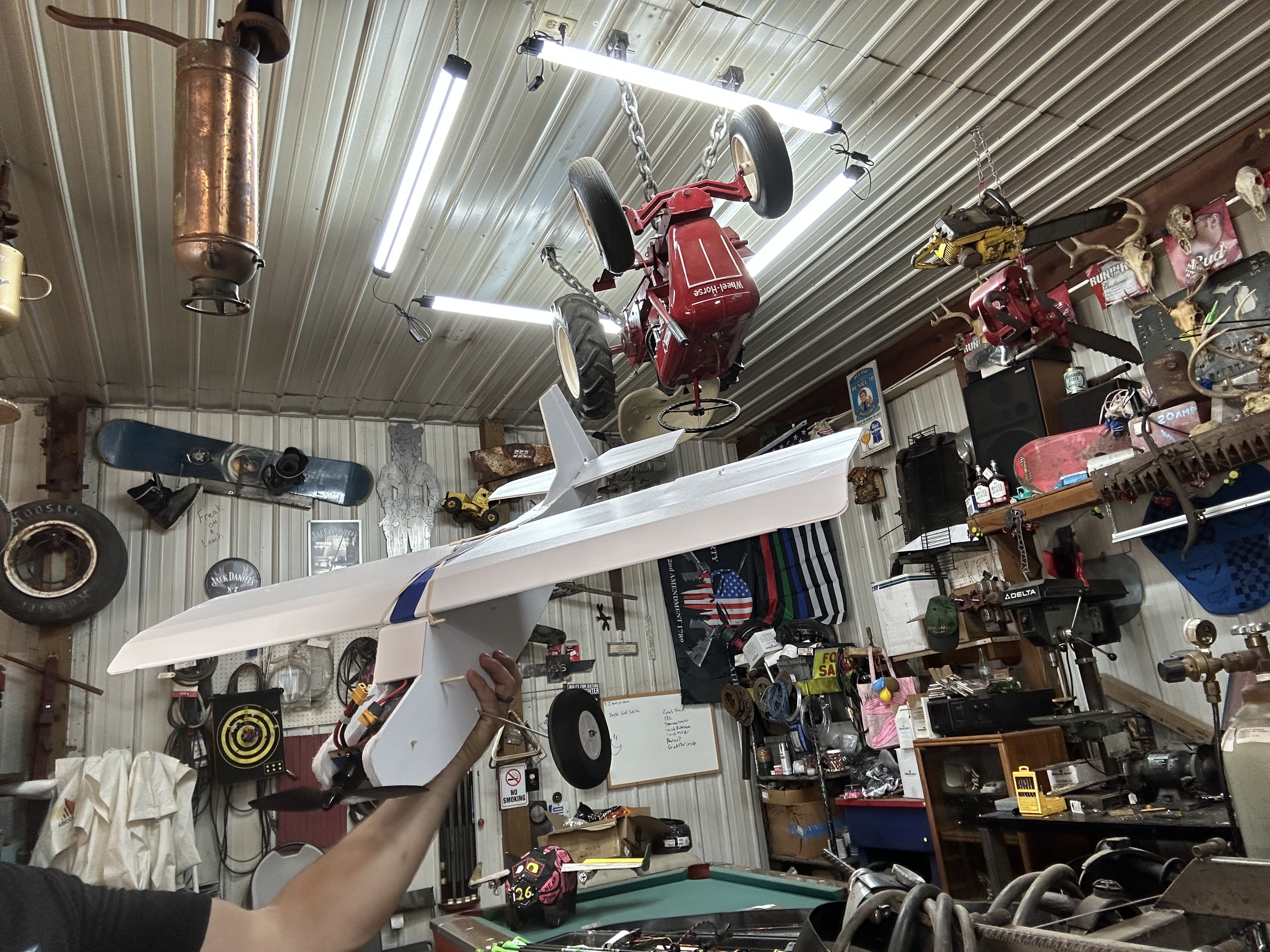

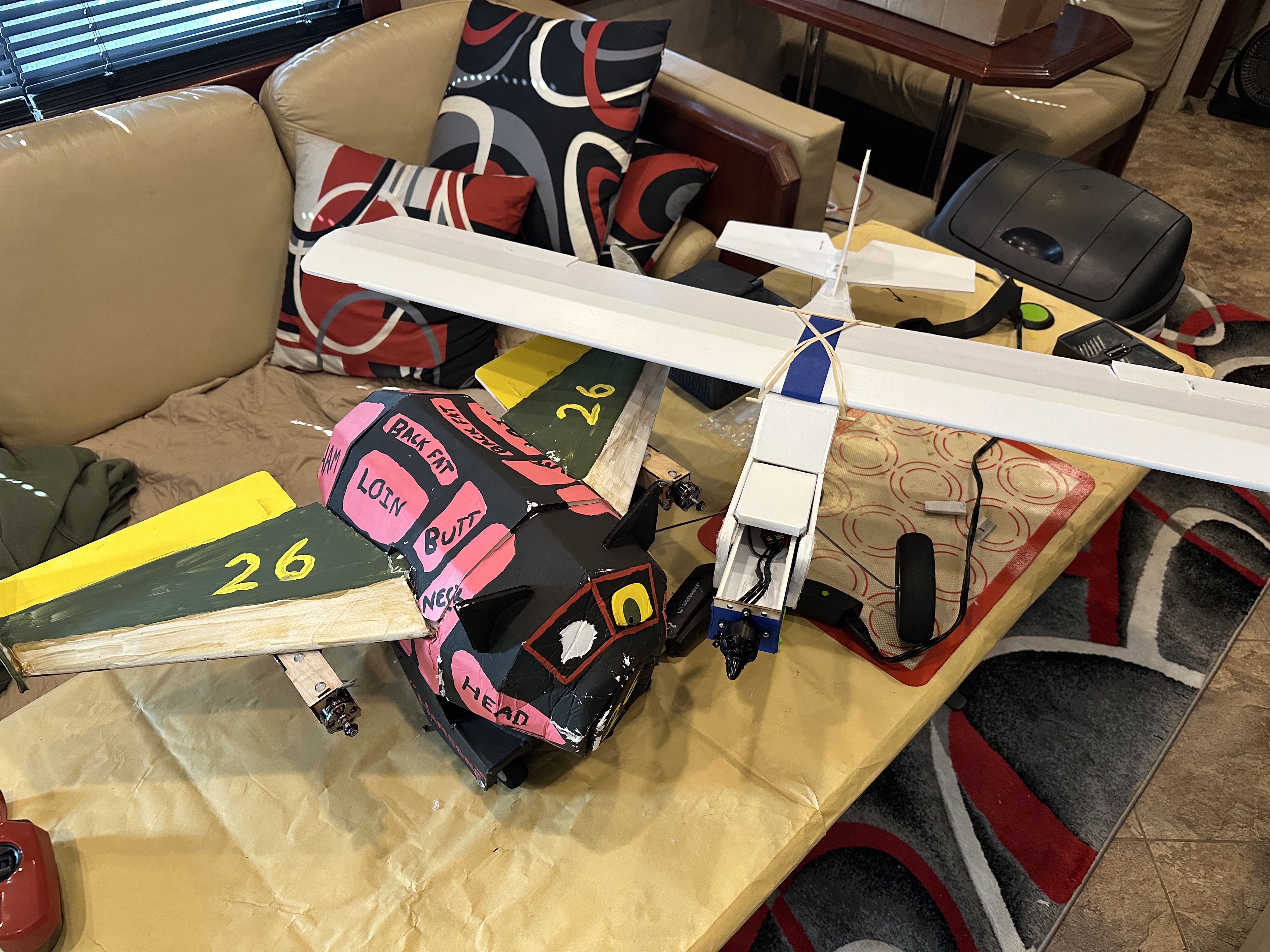

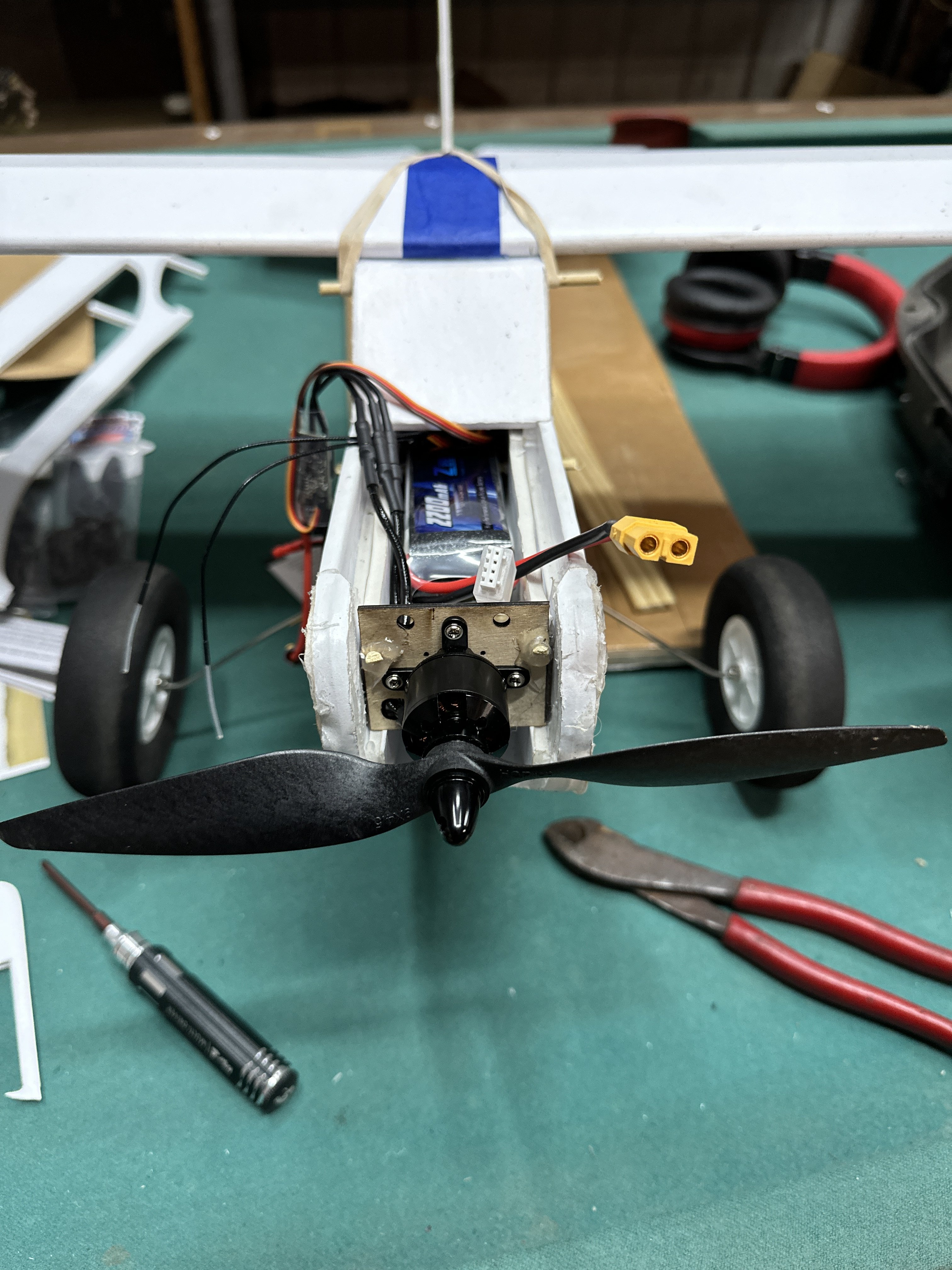

After building Hambone the piggy at Flite Fest, I was hooked on the build! After crashing Hambone like I was warned, a few times, I picked up a Tutor kit. It was suggested as an easy build and easy fly.
I built the majority of it on Saturday night, and finished it today. I need a battery hold down strap in there and it’s ready to go!
I have the float kit and may end up installing it before too long. I want to have an easy (slow) flying plane and it was suggested by one of the staff that the floats will add low center of gravity and slow it down a bit too.
Being a major Wheel Horse garden tractor enthusiast, it’ll likely be red and tractor themed somehow.

Nice garage! Deer skulls, tractor, tools, stuff with engines…. I APPROVE! (Kinda wish mine looked like that 🤣, though I do have a partially disassembled vintage enduro bike in mine)

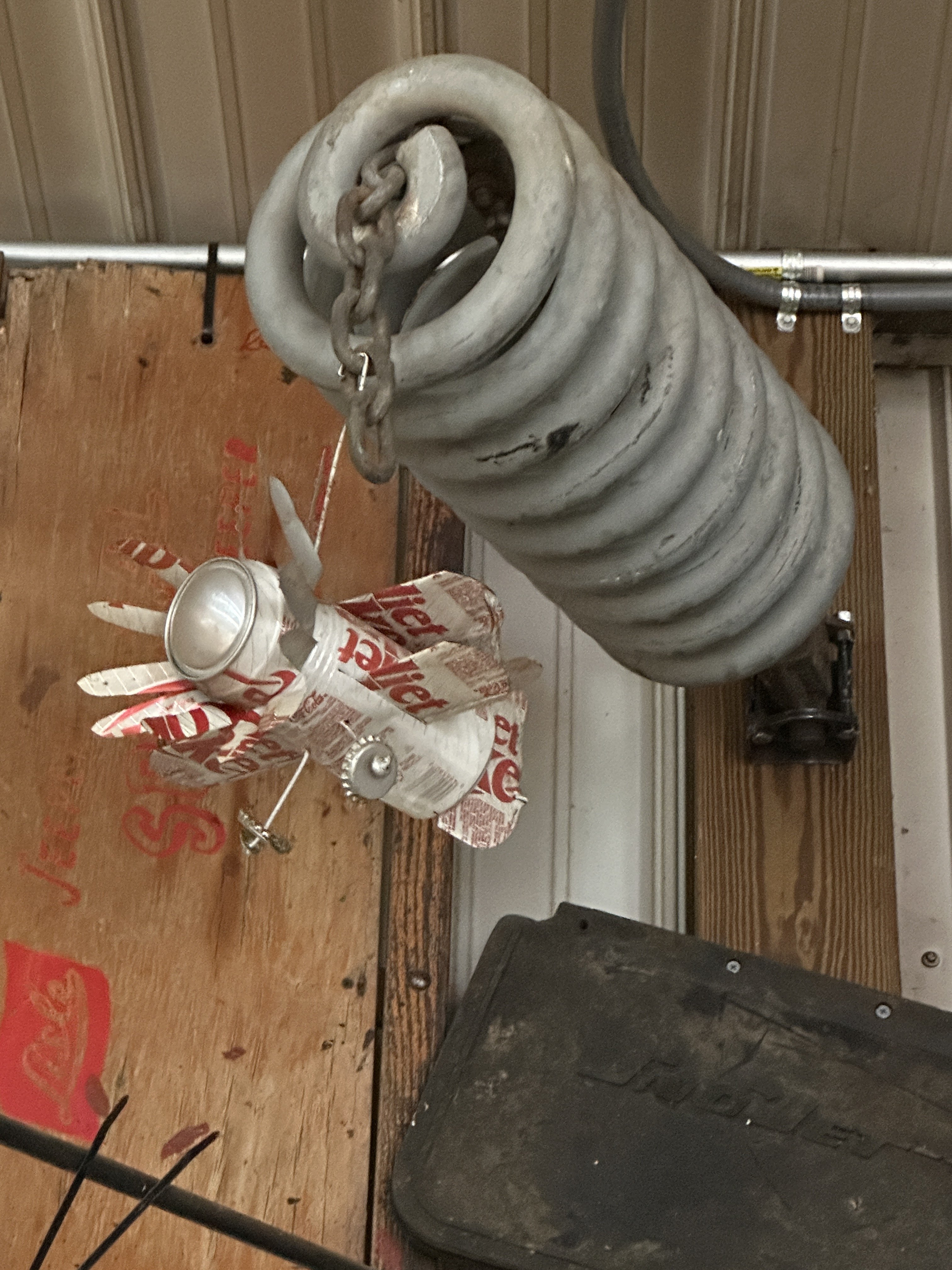

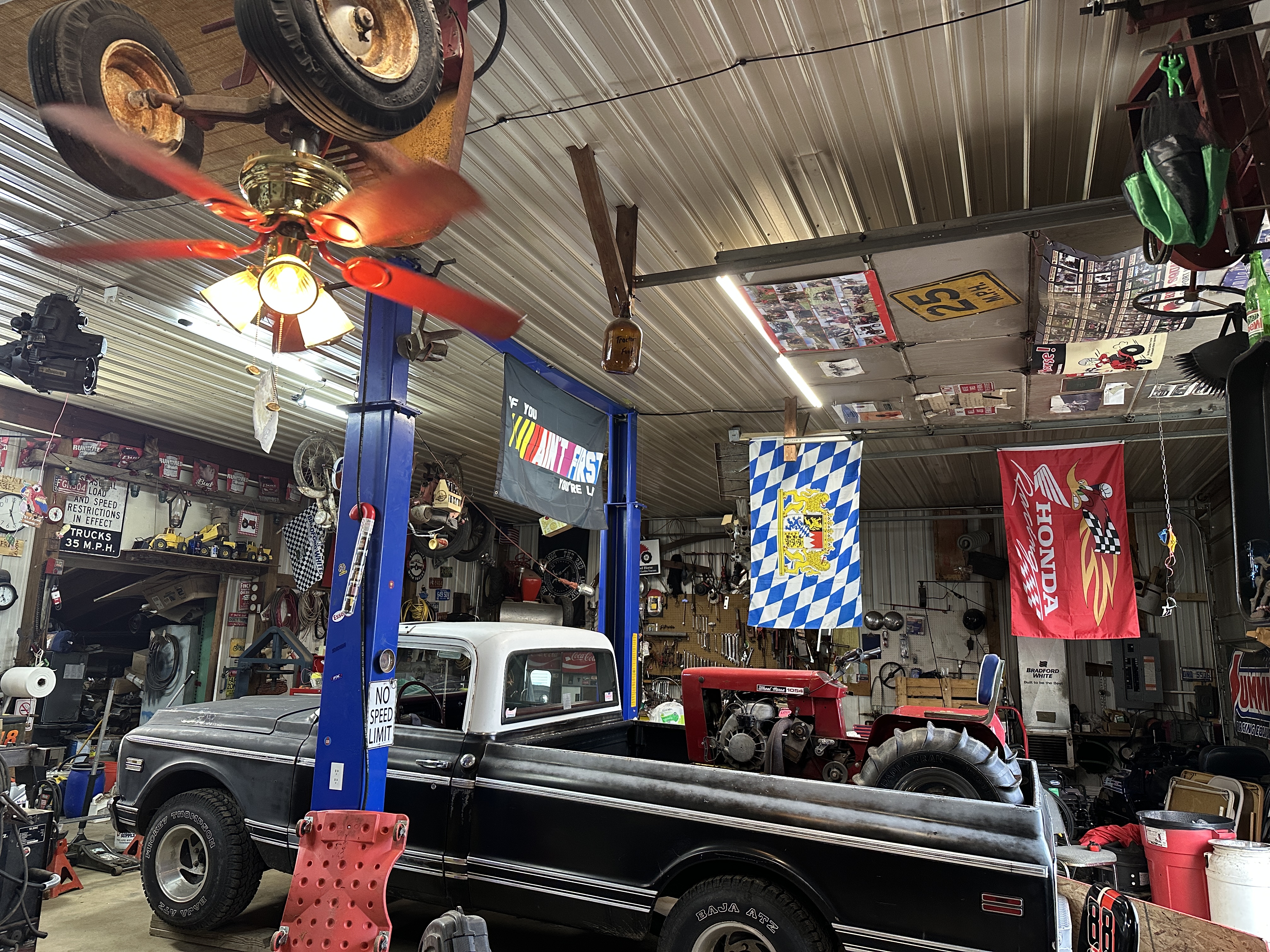

thank you! I have sure made the place my own. There are 5 tractors in various states hanging up, one is even my ceiling fan! There’s some Tonka toys, motorcycles and various other things hanging up too, all out there by myself.

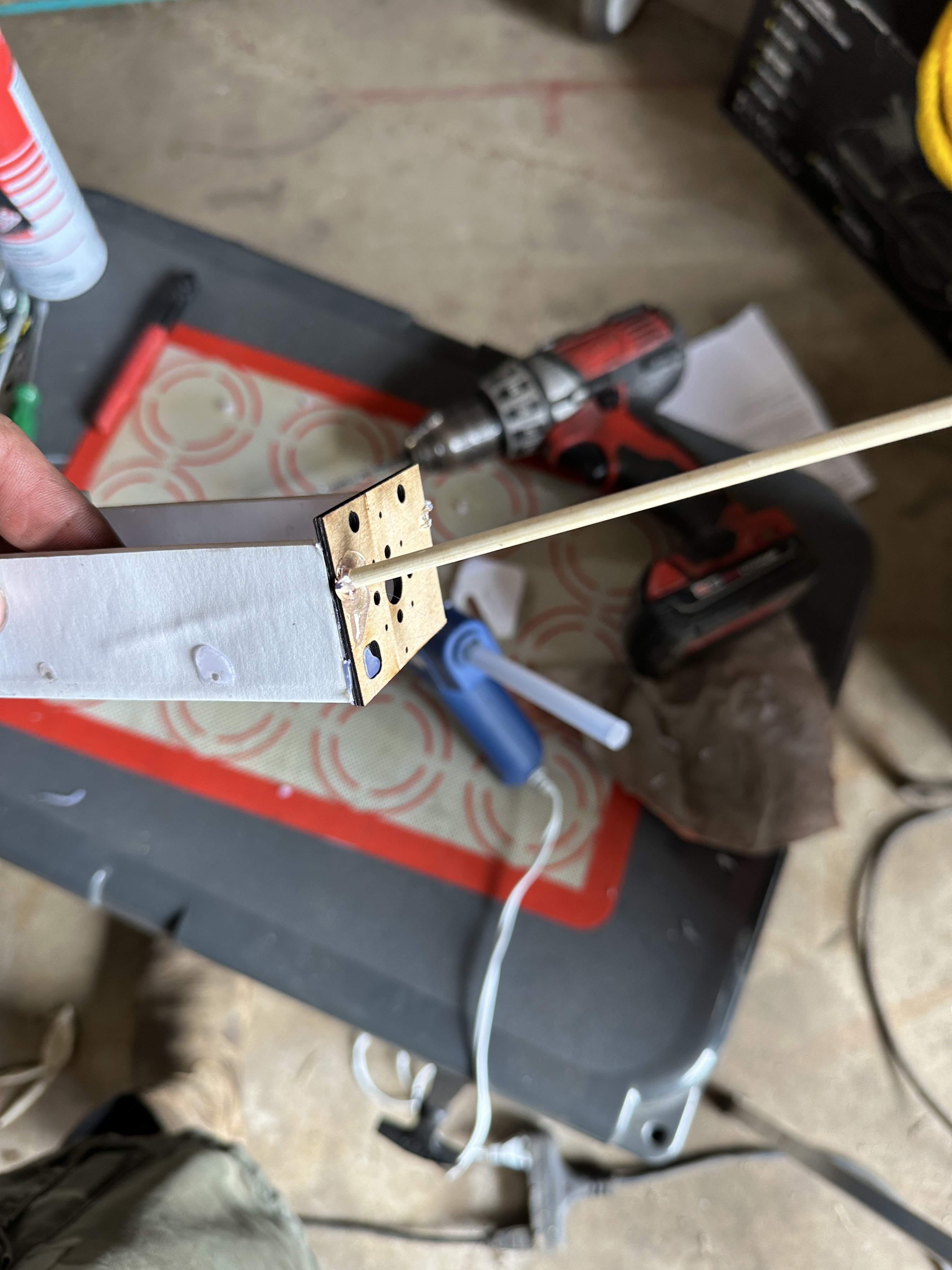

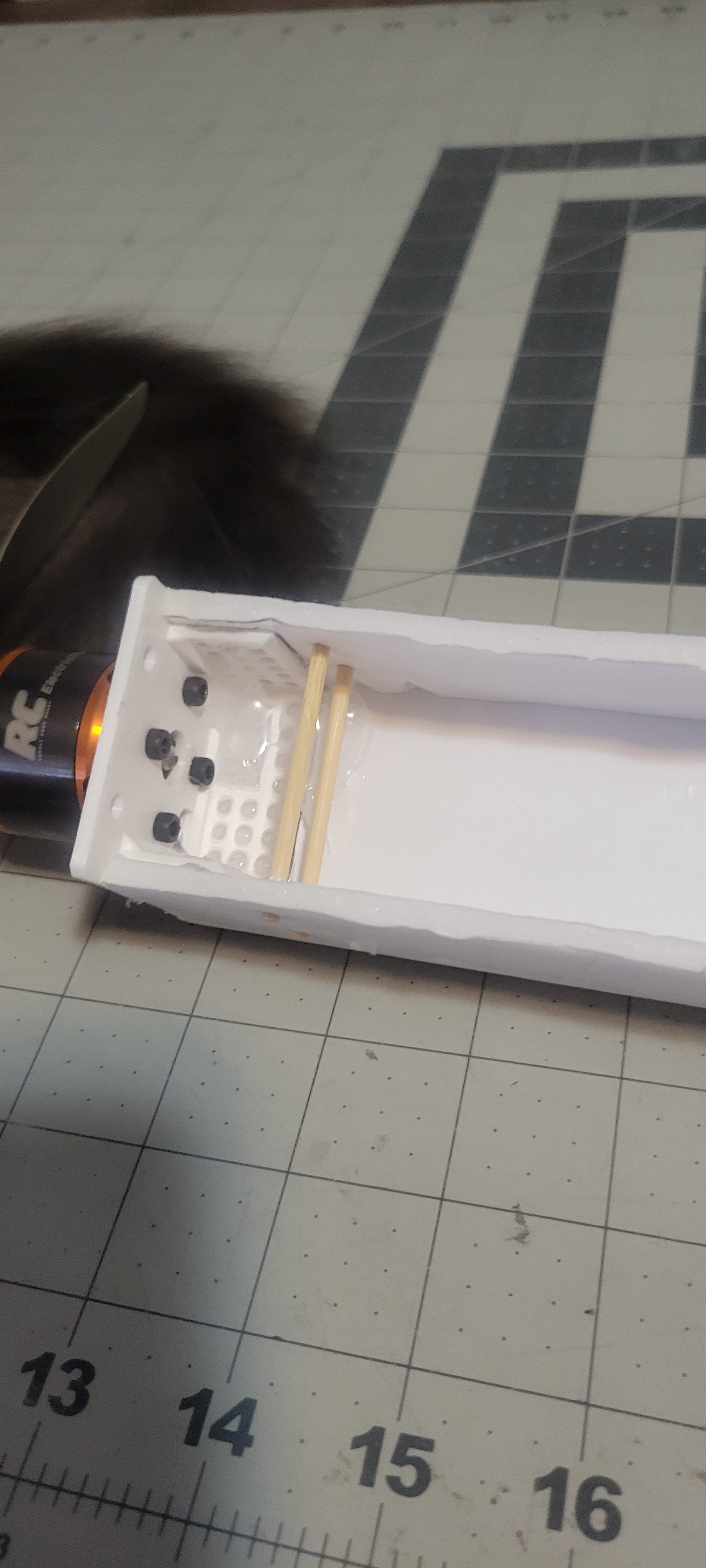

Maybe caused by the thrust at take off. If it's torque roll you can add a couple washers to the left side of the motor to give it some thrust angle. Seems your hitting the throttle pretty hard on take off, which you might need to in that grass. One thing you might try before anything else is have someone hand launch you with a nice little toss (towards that tall grass for cushion just incase). Also you might put a couple bbq sticks in the power pod between the firewall and battery. It could save your battery from going through the motor mount bolts in a crash.

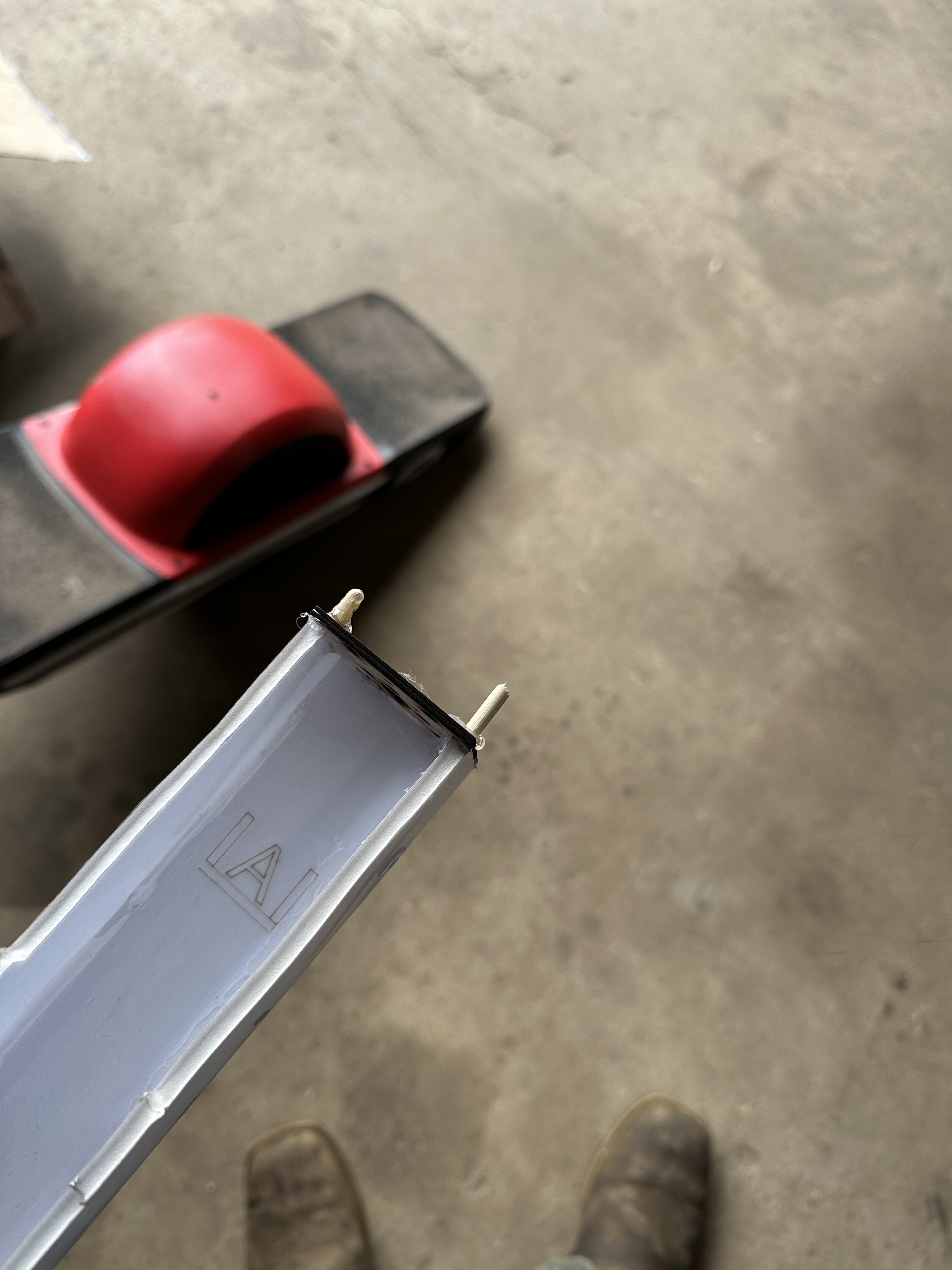

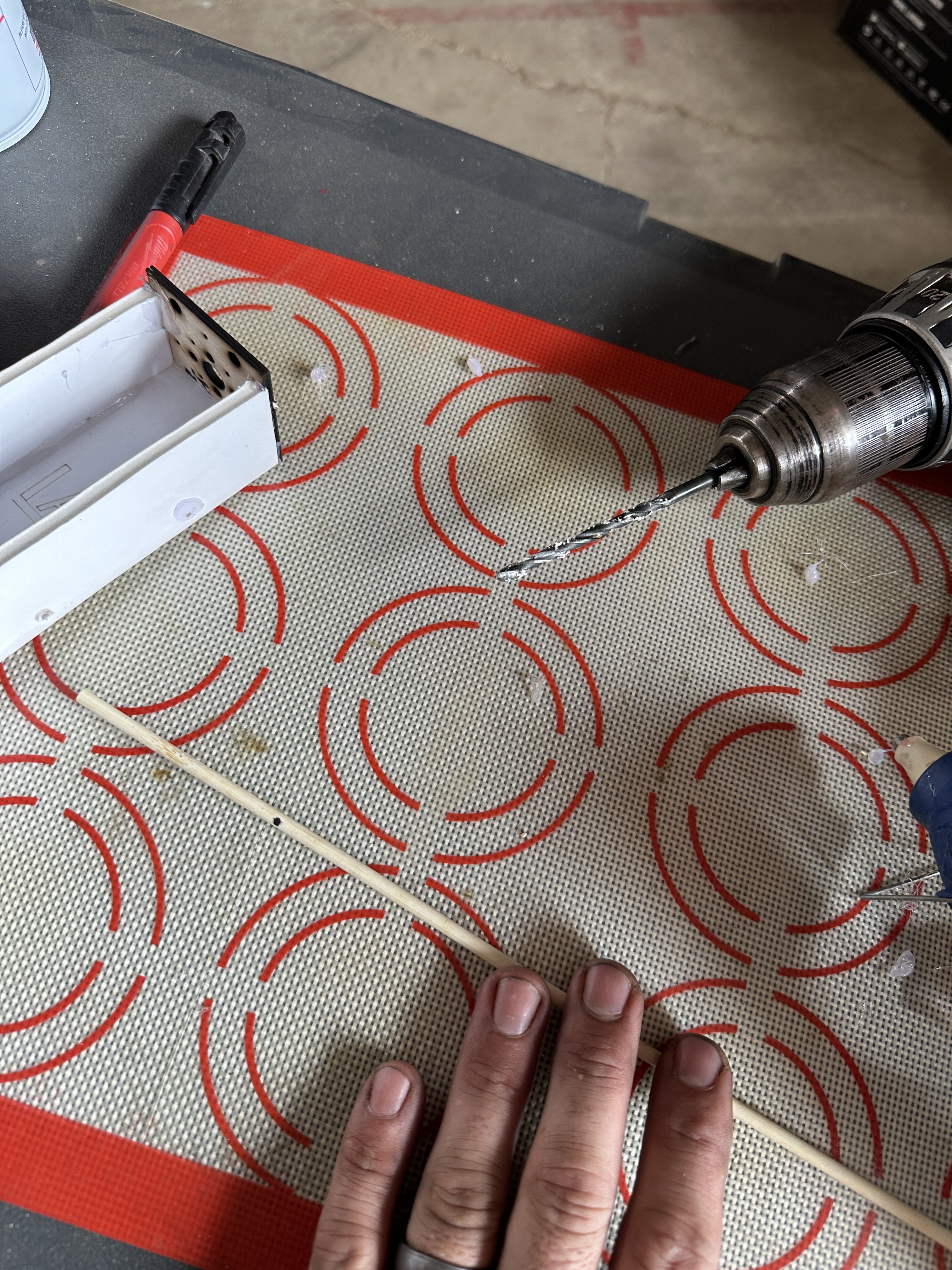

Test two. Coming soon…
For now, I built one pod, pre drilled the firewall, then chased the bit into the foam board at an angle and glued in a couple 2-3 inches of skewer on each side for more support.
