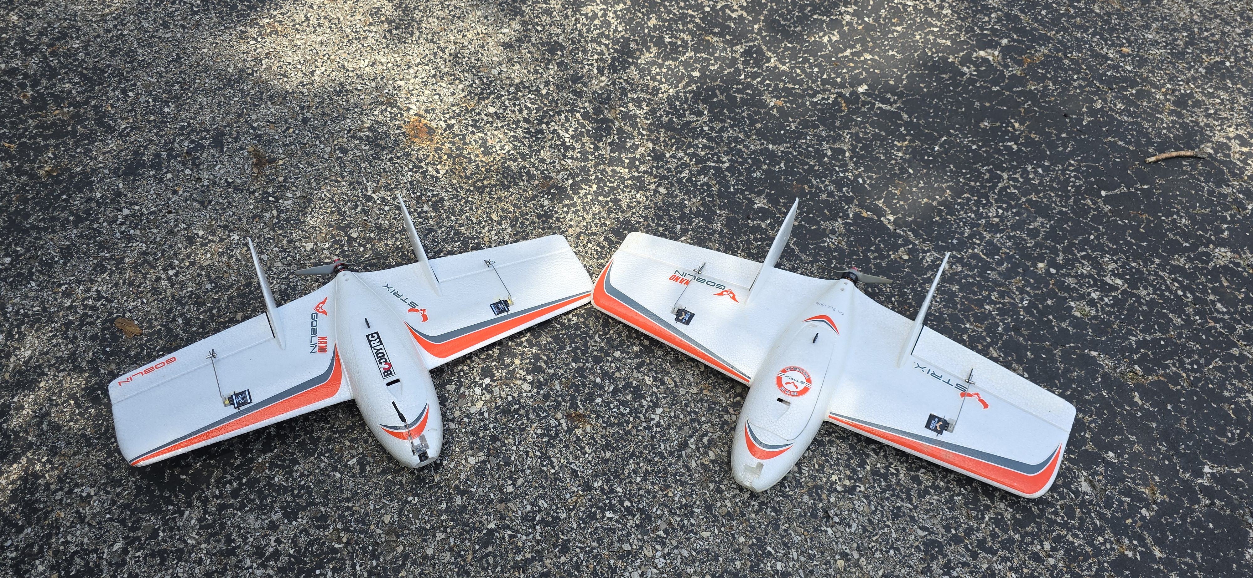

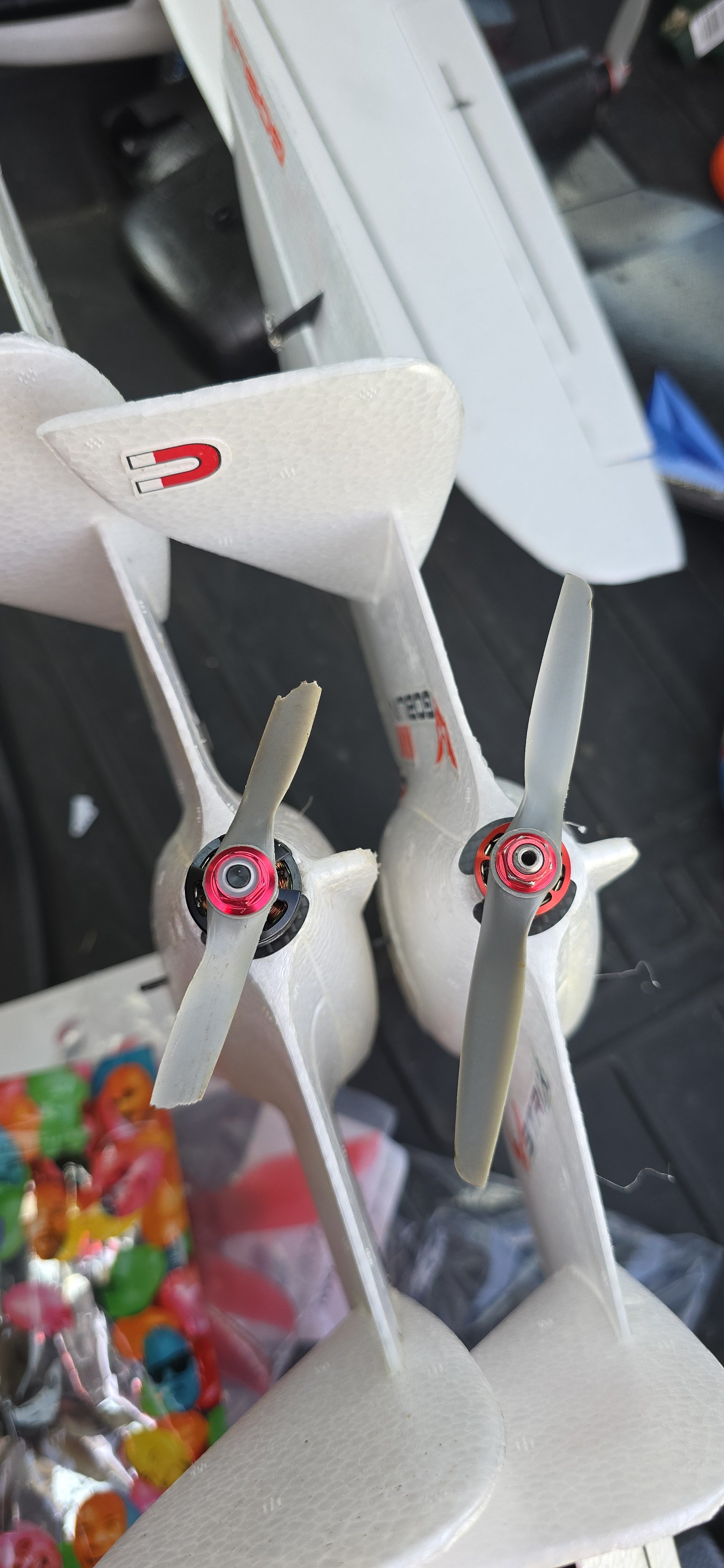

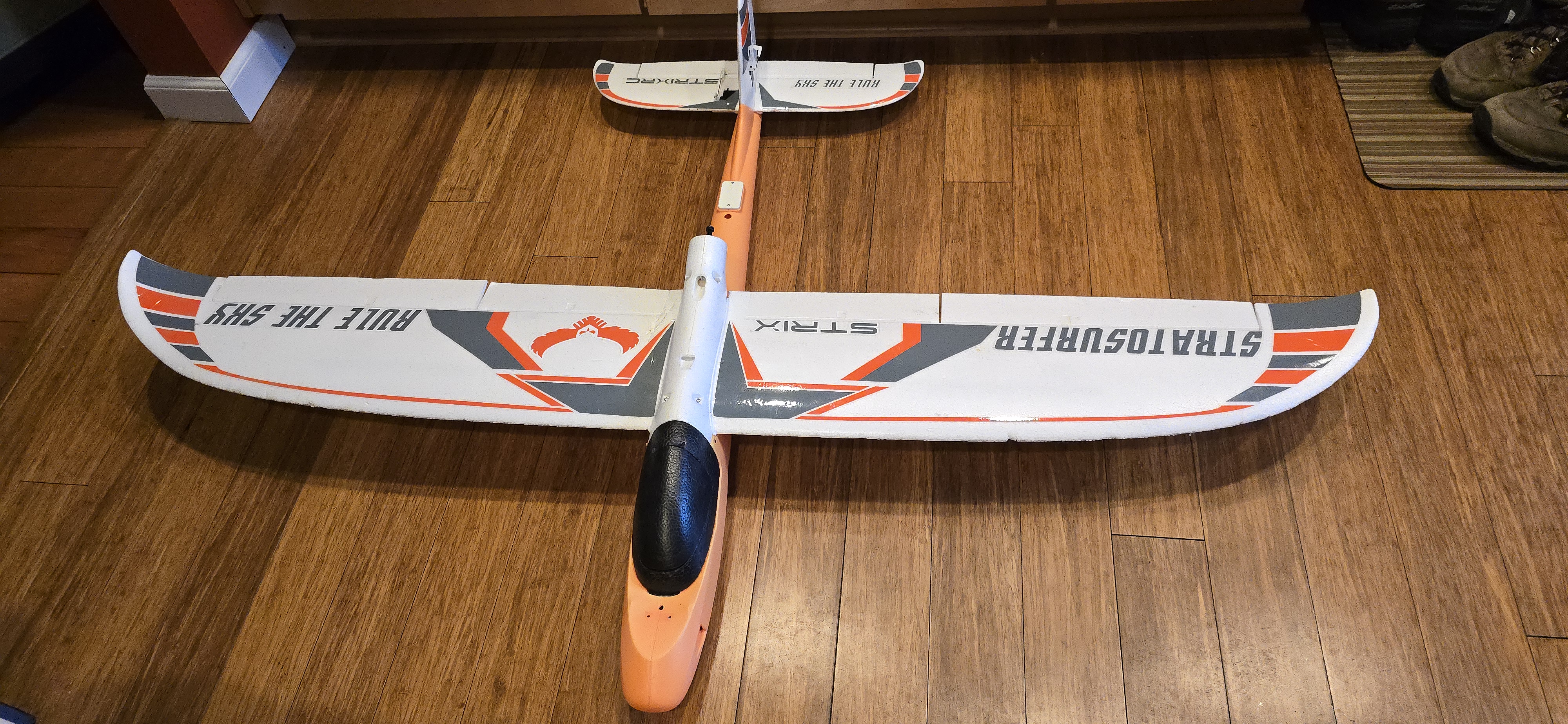

I have been flying a Strix StratoSurfer on 3S 4200 packs for years. I can easily acheive 20-30 minutes of flight on those packs with a Sunnysky 2212 kv2400 and a 6x4.5 inch prop. a moderate cruise vs flying fast is key to endurance. Not exactly what you are looking to design, but a good comparison. I have not yet flown it with the 21700 packs yet. On a smaller scale, the strix nano goblins can easily reach 45-60 minutes of flight on a 3200mah 2s 18650 pack. i run a 4.1x4.1 apc pusher prop on these with a variety of small 4000kv in the 14xx -16xx size motors. I fly mostly FPV, but also fly LOS and do plain old PWM RXes and various flight controllers too.
Oops on the one prop.....
These can be flown sub 250g
bssman
