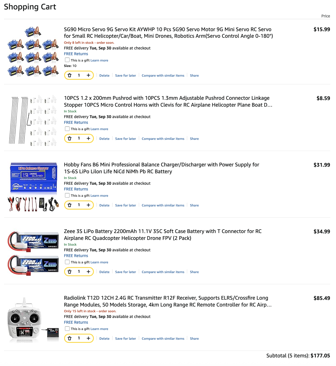

Current purchase list alongside the FT Power Pack B. Batteries can be used for both planes, same for charger, and the servos will serve for the Stuka. The extra servos will be donating their control arms to the ones in the Power Pack B since it does not seem that they come with them. Any suggestions before I dump the money? I will buy a power pack for the Stuka later.
I feel like I could save money with a different transmitter but am not sure.
Power pack B comes with control horns btw

Thanks so much. I have heard of something called telemetry, where you can see the battery level and set alarms so you don't ruin your batteries. Does the FS-i6x have it?
I think it can be set up, but I’ve never tried to use it. (Even on my spektrum remote, I just stick with a timer normally)
