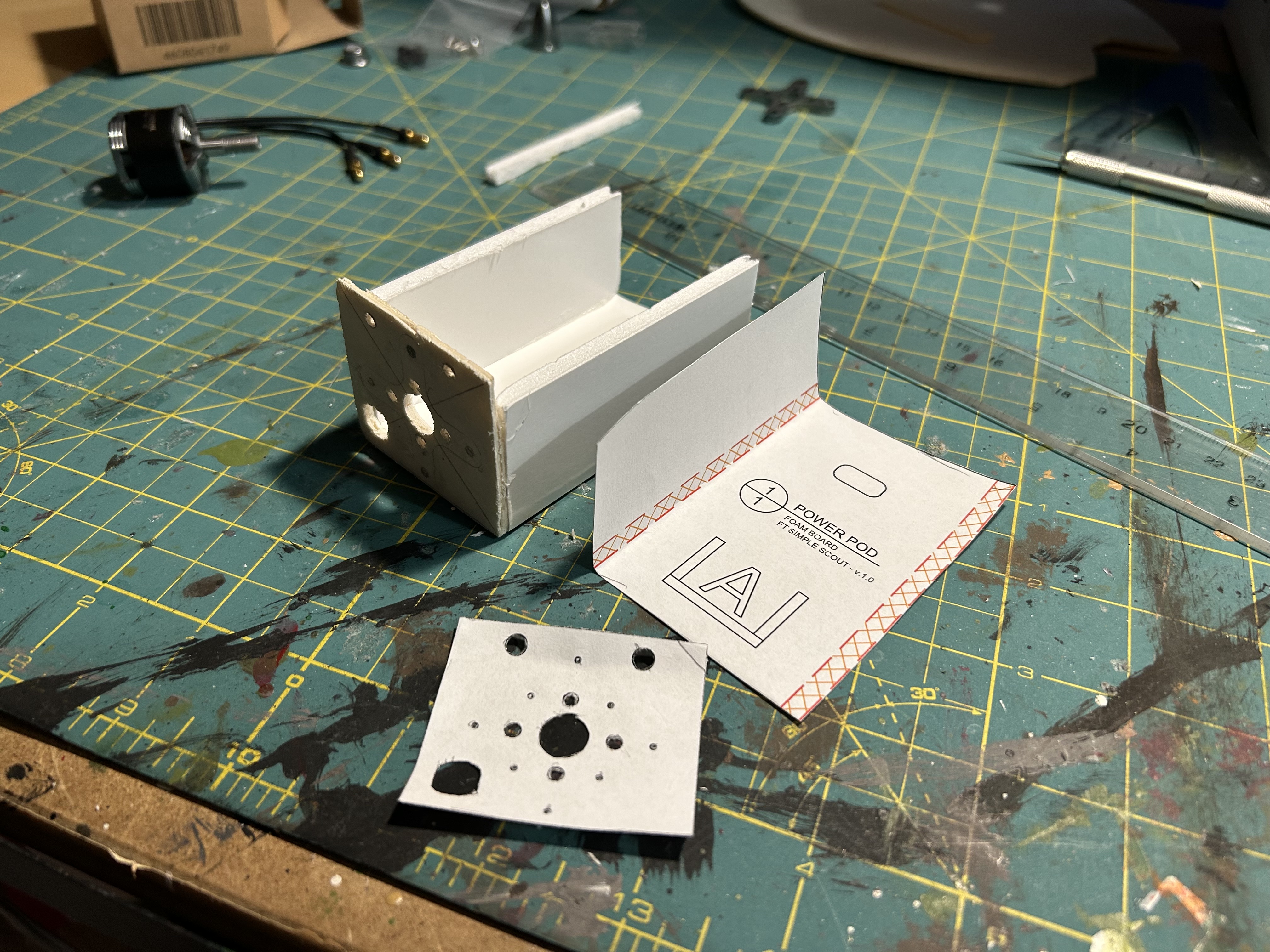

Well it seems the firewall is too high using the dimensions from the plans...
