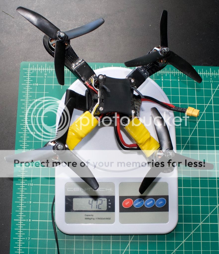

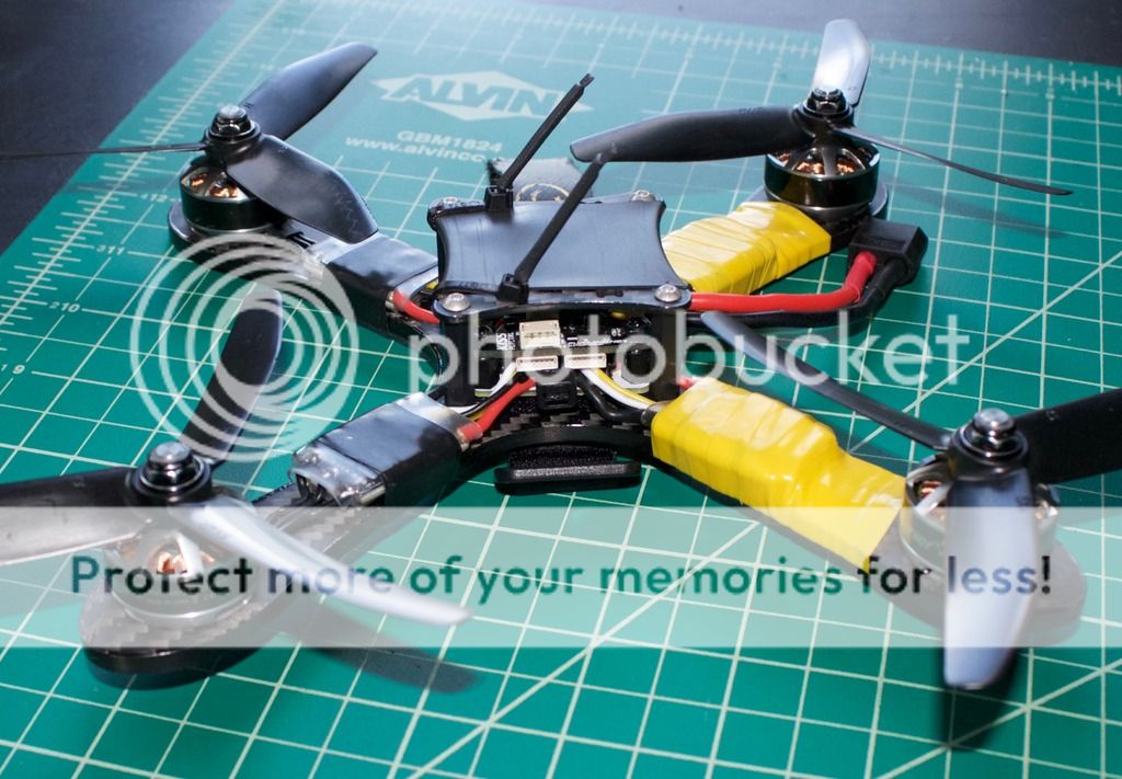

So I've flown the Mixuko plenty now, and I just don't love it. I decided to remove the FPV gear and use it as an LOS acro quad.

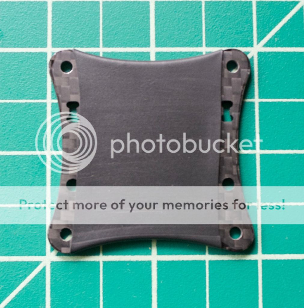

I closed the large opening on the top plate with a piece of heat shrink.

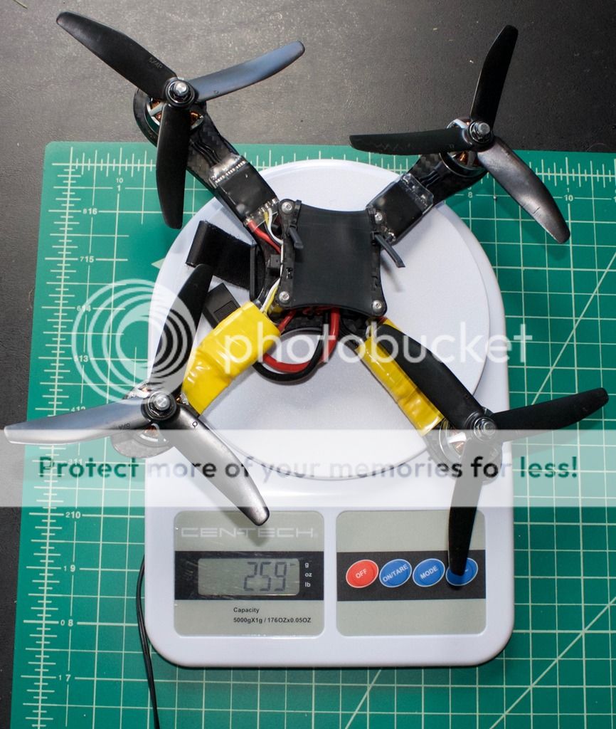

I moved the rx from under the FC to above it. I thought it made more sense to have it touching the top plate. When I moved the FC down, I used some shorter standoffs (6 mm instead of 10). I also had room to swap out the outer 30 mm spacers with 25 mm ones. After that, I added some yellow electrical tape to the rear arms to help with orientation.
The dry weight is 259 g, and the AUW is 412 g.
