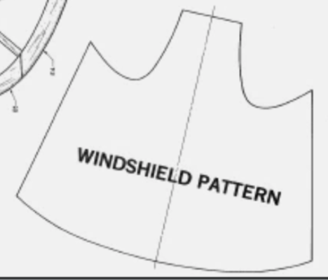

Hello my name is Larry, I recently inherited a sig1/4cub that was previously started but not completed. Problem is I have no blueprints or instruction manual. What I need is the windshield template. If someone out there has a set of plans that they could trace out the template I would be happy to pay you for it thank you Larry. My e-mail is lnorris22@iclod.com

This is for a SIG 1/4 Clipped Wing Cub. You'll need to scale it.

I was in the same boat when I did mine. If U can order the plans, there's your ticket right there. If not, then what airforge sent with his advise will work. U can go to page 2 and 5 on my old build thread to see how I taped a rough pattern out of paper to the plane and trimmed to what I felt looked right.
