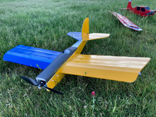

We've found that the FT Scout flies very well with a 2200mAh 3S battery, mounted with velcro and a strap. She is one of our favorite (and long-lived) models because (once trimmed) is smooth and relaxing to fly.
Let us know how the next flight goes!
PS: here is our Scout with the FT Tutor in the background.
