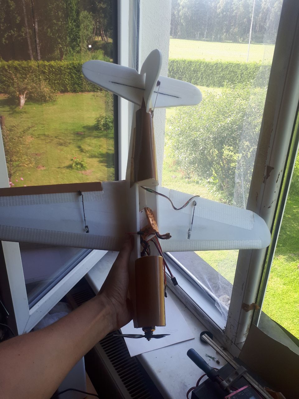

I decided to make the spar out of aluminum after all. The wing profile didn't turn out quite the way the designer intended. I don't know if it will fly. It weighs 257 grams with an 1806 motor and an 3S 850mAh battery. I used too much epoxy, and the wing turned out very heavy—around 90 grams.

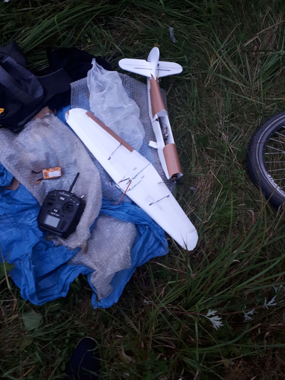

The maiden flight didn't go very well. First, the motor tore off; the aileron rates were too high, and apparently one wing was significantly heavier than the other. Then it crashed into a tree, and a wing snapped off.

What makes you think 1 was heavier?

I glued the spar on one wing with epoxy, but I was too lazy to wait for the other one to cure, so I used hot glue. Tomorrow I'll try to take off using the flight controller.
