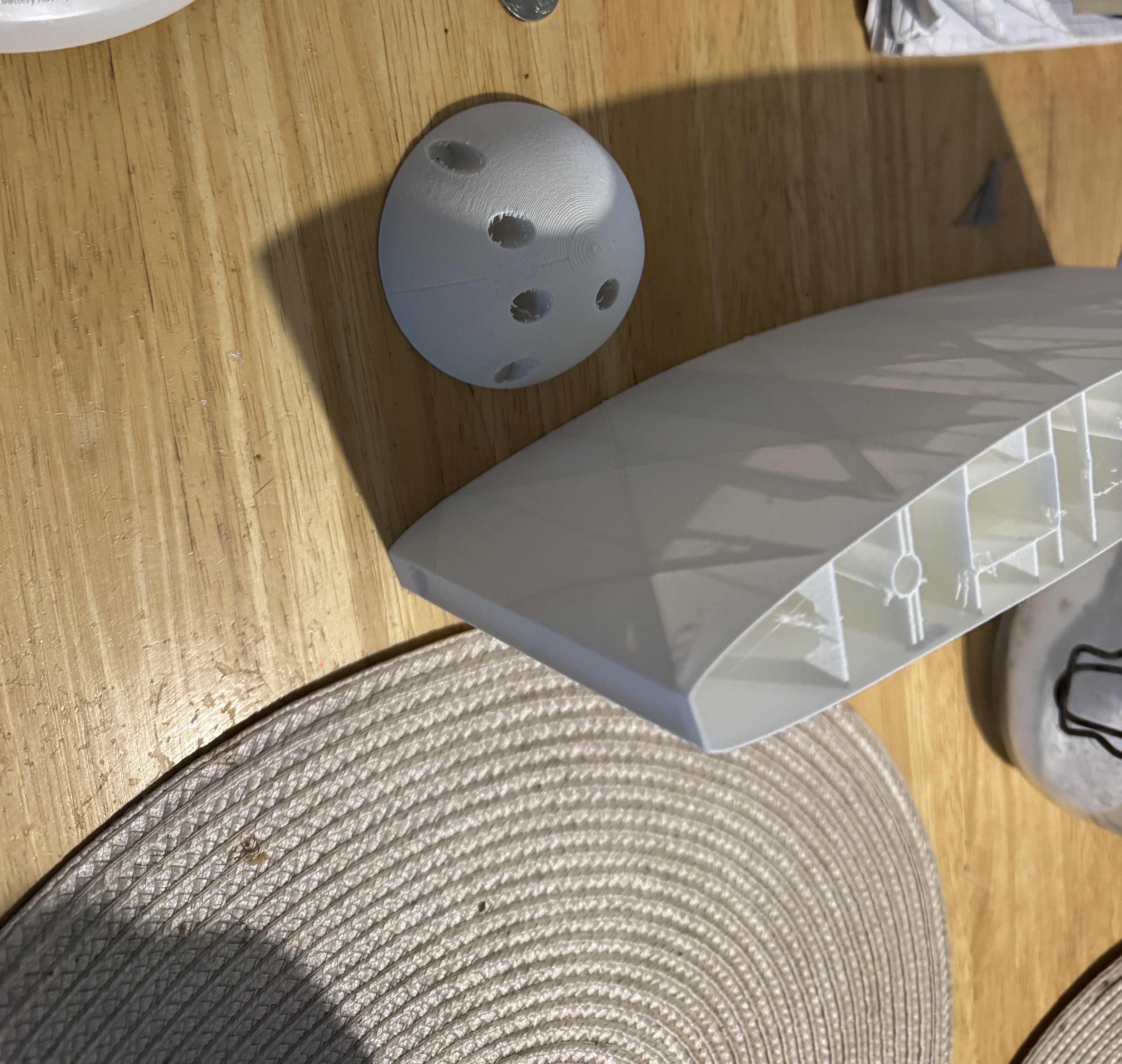

Here’s a photo of my first test/fail prints 😂😂
