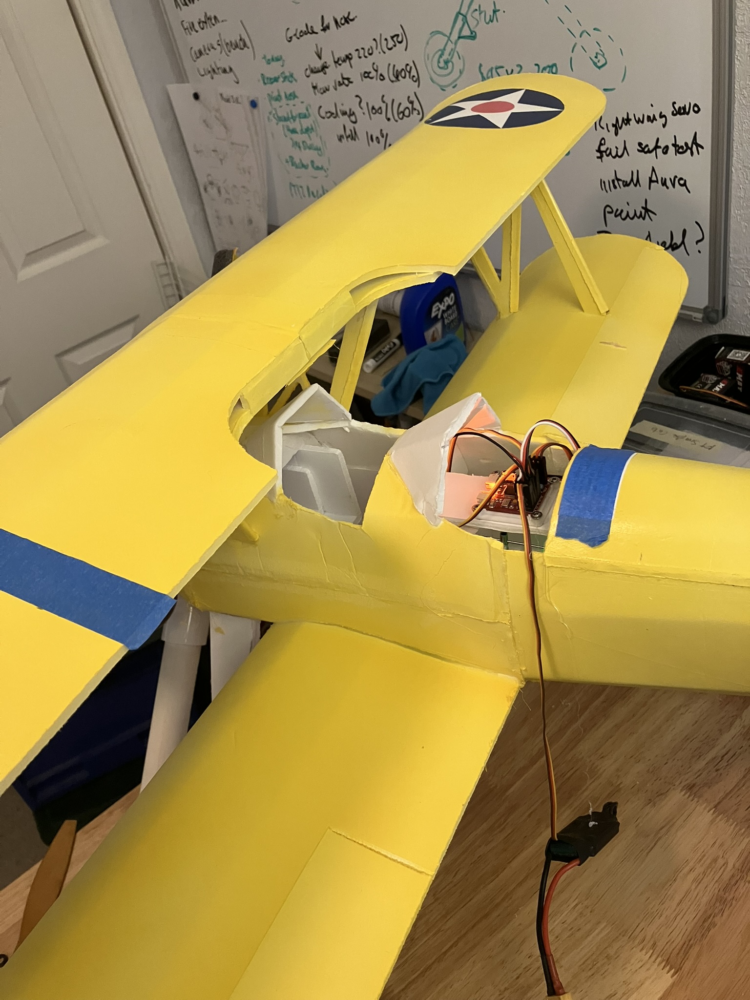

All 4 servo's installed with control linkages. As with most of my builds I have installed an Aura 5 Lite although it was difficult to find a suitable mounting point. In the end I glued in a piece of foam board in the rear cockpit above the servos.
I still need to paint the rudder blue and add some red stripes to both wing and fuselage but will brush on rather than spraying.
I also need to secure the power pod somehow.
