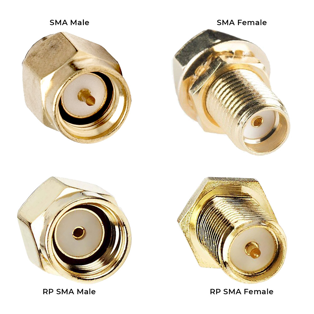

I have gone over 1/2 mile on 25mw. Power is NOT the end all cure all and too much power can be a bad thing. I usually run between 25mw and 200mw. Good antennas (VAS is my favorite brand) will make the most difference. 100-200 yards is VERY short. Make sure your circular polarized antennas are all either right hand or left hand. Mixing right and left will be a sure fire short distance setup. I use RHCP (right hand circular polarized) on most of my analog gear. My Walksnail gear defaults to LHCP, so I have had to get new antennas to play with. There are also different polarity antenna connectors on the transmitters and receivers. RP is reverse polarity. If you mix RP and standard at a junction, you will not have a good connection.

I believe I use RHCP antennas...I should check.
